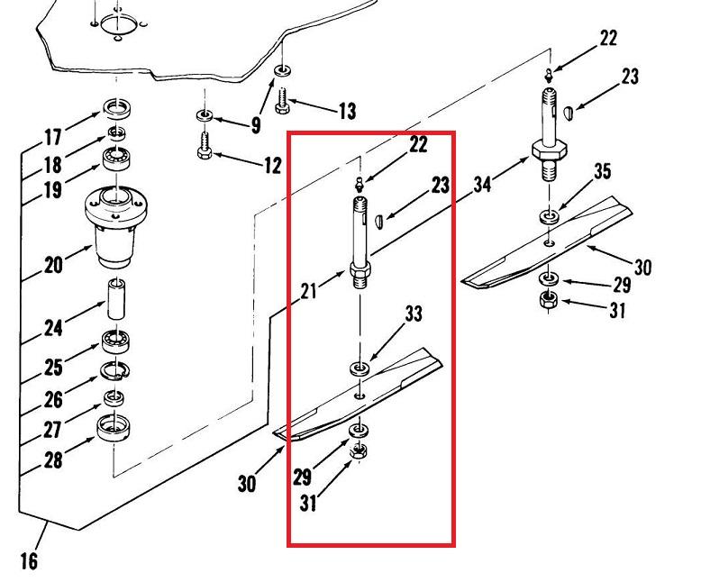

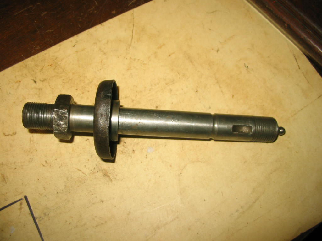

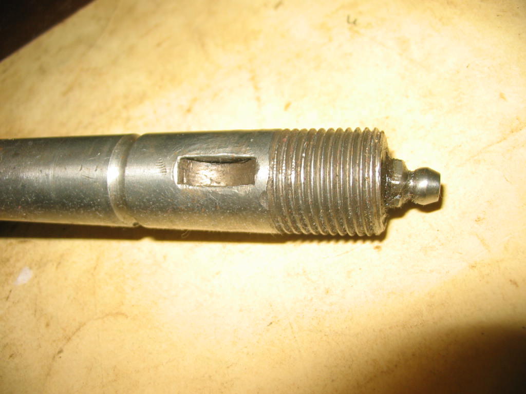

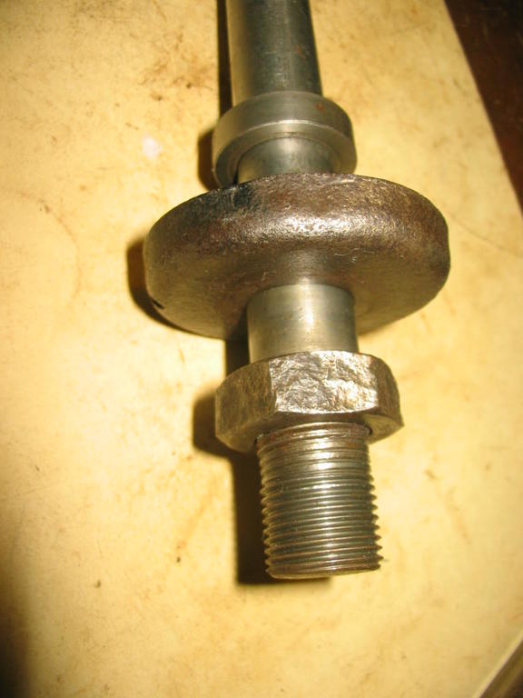

daveoman1966 3,881 #2 Posted October 29, 2017 (edited) Is this you deck spindle...item 21 ...it is part # 108849 and I have a good one in my hand that I can put in your mailbox for $47... with NEW keyway and top Grease Zerk. Edited October 29, 2017 by daveoman1966 1 Share this post Link to post Share on other sites
