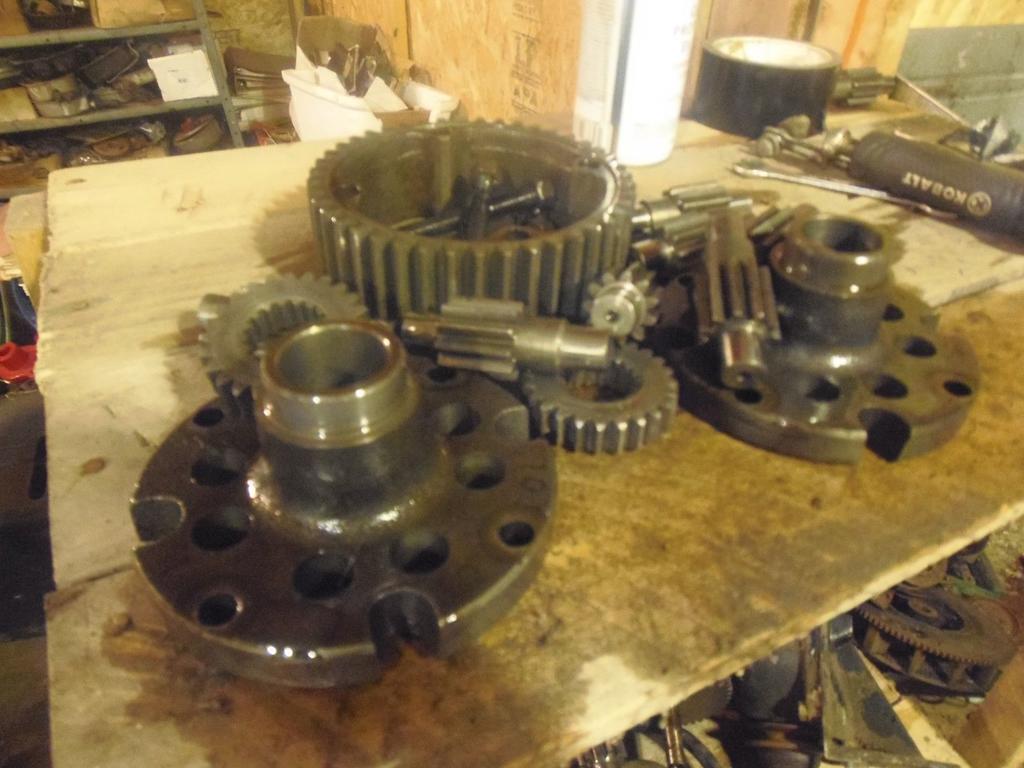

Petes Horse 20 #9 Posted October 20, 2017 (edited) Will definitely go grade 9 and thankfully the axles and everything else inside the trans is in very good shape. Does this look like the right diff? Edited October 20, 2017 by Petes Horse Share this post Link to post Share on other sites
pfrederi 18,806 #10 Posted October 20, 2017 If it 1-1/8" axles and 8 pinions your are set. The hardened washers mentioned in the TSB are still available. However i would think any GR 8 or 9 washer that would fit in the machined surface would suffice. Share this post Link to post Share on other sites
