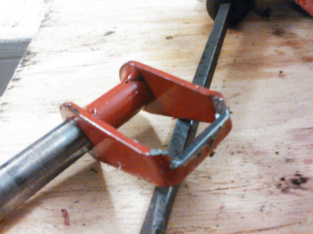

Petes Horse 20 #8 Posted October 18, 2017 Yup, the silicone was like snot worms all over the place. Whats most amazing is none of the metal shavings from whats left of the parking mechanism ended up in the hydro motor. Not going to be putting that back in. Share this post Link to post Share on other sites
pacer 3,177 #9 Posted October 18, 2017 That park brake thing is a disaster waiting to happen! I have 3 'big D's' and I recently went into the last of the 3 for an oil leak and while in there I cleaned all of it out - that makes all 3 of them park brake free As an added benefit I also removed all that tangle of linkage down to it and gained a MUCH smoother motion lever. Share this post Link to post Share on other sites
