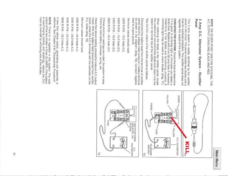

HENRYG 34 #1 Posted October 16, 2017 Hey all, I've been given a 552 in pieces my only other WH's are pull start RJs . Can someone tell me if the 552 use's a solenoid for the key switch the manual shows a non descript three prong thinger with no name on it, and the parts list doesn't mention one but there are a few In the box of parts I was given . Thanks HenryG. Share this post Link to post Share on other sites

HENRYG 34 #3 Posted October 17, 2017 1 hour ago, HENRYG said: Hey all, I've been given a 552 in pieces my only other WH's are pull start RJs . Can someone tell me if the 552 use's a solenoid for the key switch the manual shows a non descript three prong thinger with no name on it, and the parts list doesn't mention one but there are a few In the box of parts I was given . Thanks HenryG. Yes I'm aware of the starter switch, but the key switch is what I'm asking about it shows only one wire going to a non descript component on the wiring diagram ? Share this post Link to post Share on other sites
wallfish 18,789 #4 Posted October 17, 2017 the one wire from the key switch is for the kill to the coil in the engine 1 Share this post Link to post Share on other sites
HENRYG 34 #5 Posted October 17, 2017 1 hour ago, 953 nut said: The 552 has a large push button starter switch. Not quite as large as the picture. Yes I'm aware of the GIANT starter switch I'm asking about the key switch I see only one wire going from it to a non descript component with three prongs in the wiring diagram ? 2 minutes ago, wallfish said: the one wire from the key switch is for the kill to the coil in the engine Where does that wire go there's that component with the diode's does it screw to that somewhere ? Share this post Link to post Share on other sites
wallfish 18,789 #6 Posted October 17, 2017 On the plastic board you will see a wire coming out from behind the flywheel and connected to a single post. That's your kill for the switch. (usually upper left corner but they do get reinstalled upside down sometimes). The other 2 wires from under the flywheel will go to the fuses and diodes for charging the battery. Actually, it may be in the middle top. Green wire from engine 1 1 Share this post Link to post Share on other sites

HENRYG 34 #9 Posted October 17, 2017 8 minutes ago, wallfish said: On the plastic board you will see a wire coming out from behind the flywheel and connected to a single post. That's your kill for the switch. (usually upper left corner but they do get reinstalled upside down sometimes). The other 2 wires from under the flywheel will go to the fuses and diodes for charging the battery. That's the answer I was seeking does that board have a cover looks a little scary Share this post Link to post Share on other sites
wallfish 18,789 #10 Posted October 17, 2017 there should be a cover. Made of white plastic with curved sides 1 Share this post Link to post Share on other sites
