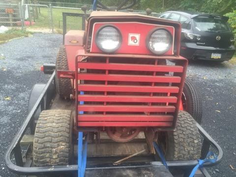

Big_Red_Fred 1,548 #1 Posted October 15, 2017 Does anyone know how to adjust the front belt for PTO om my son's D200 ? I asked a few local Red Square members who own 1 & they have no idea, Share this post Link to post Share on other sites
gwest_ca-(File Mod) 11,849 #2 Posted October 16, 2017 Drive belt for the rear pto? There is a bolt in the bottom of the bracket that supports the front bearing behind the pulley. That bolt draws the bracket down to tighten the belt. Garry 1 Share this post Link to post Share on other sites
Big_Red_Fred 1,548 #3 Posted October 16, 2017 Ok thankyou My son said when he adjusts that bolt the belt doesnt get tight, maybe its the wrong belt, i will check the down load you sent me & look for a belt number, thanks again Share this post Link to post Share on other sites
Big_Red_Fred 1,548 #4 Posted October 16, 2017 Belt 103084, i will check ebay now, im sure you guys know others on here that sell them too, Figuring out all the bugs on the D is fun in my book Share this post Link to post Share on other sites
