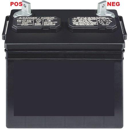

rmaynard 16,234 #3 Posted October 12, 2017 I use a U1 battery in all of my Wheel Horses U1R has the negative terminal on the right as shown below. U1L is just the opposite. 6 Share this post Link to post Share on other sites
