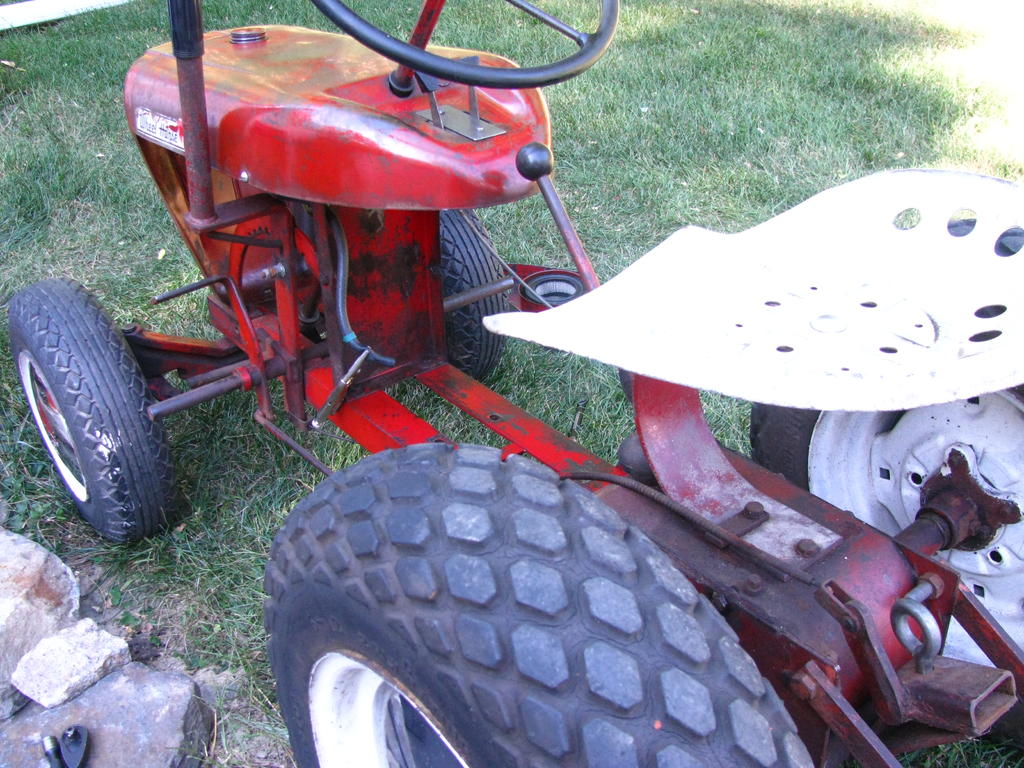

AMC RULES 37,254 #9 Posted October 8, 2017 For reference... 1 Share this post Link to post Share on other sites
seven 202 #10 Posted October 8, 2017 Awesome got it thxs Share this post Link to post Share on other sites
