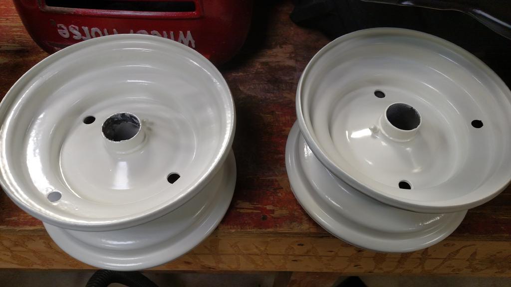

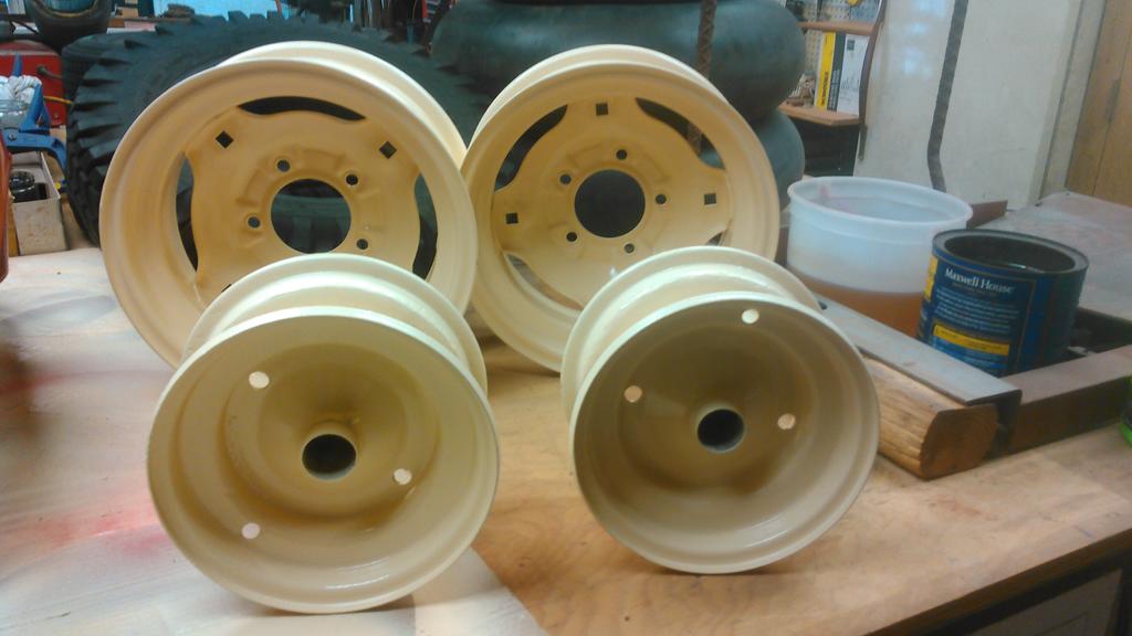

oliver2-44 11,065 #3 Posted October 5, 2017 Don't rule out salvaging them. I recall a post on here where someone sand blasted a set, welded up the holes and filled the pits in the bead seal area with JB Weld. I've done some pit filling on a mower deck with JB Weld and a belt sander smoothed it nicely.. Good Luck ! 3 Share this post Link to post Share on other sites
JPWH 6,542 #4 Posted October 5, 2017 It is a lot of work but is doable. 2 1 Share this post Link to post Share on other sites
953 nut 63,048 #5 Posted October 5, 2017 Backing up the hole with copper and then MIG welding is the way to go, The weld will not adhere to the copper and you can make several side by side beads to fill large holes. 3 1 Share this post Link to post Share on other sites
AMC RULES 37,250 #6 Posted October 6, 2017 Easier still, is to JB weld the holes closed... sand it smooth, and just run a tube in 'em. 5 Share this post Link to post Share on other sites
