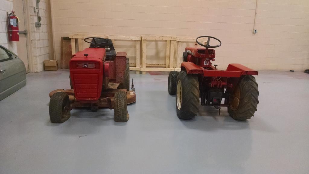

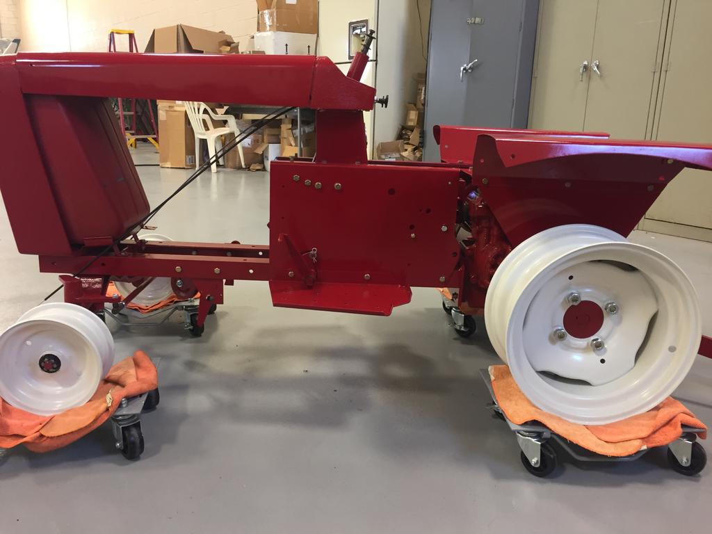

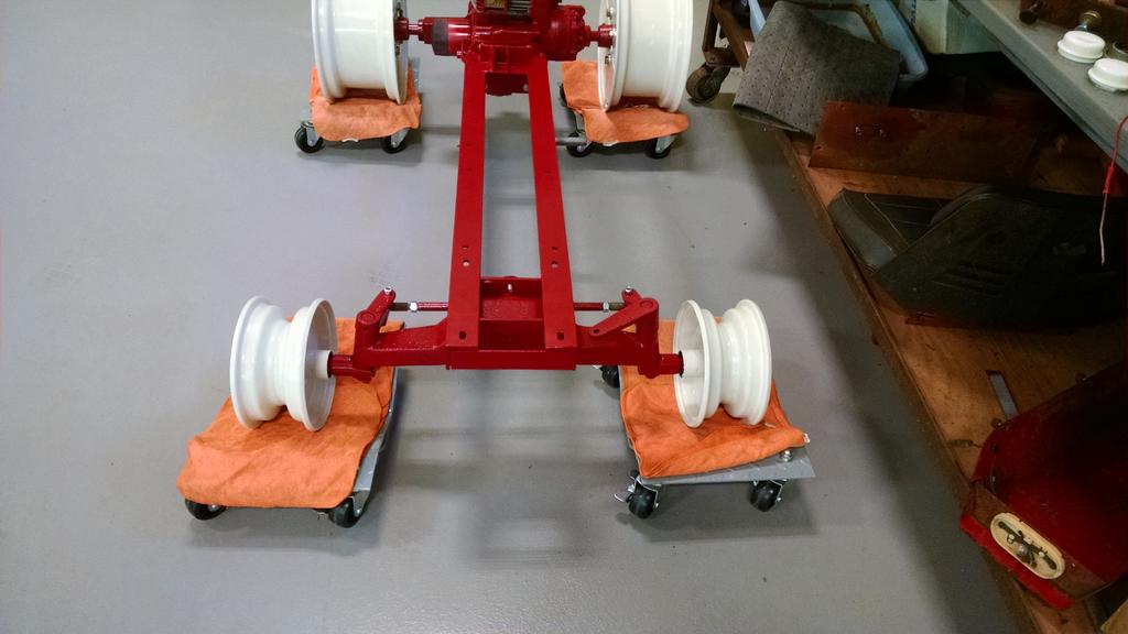

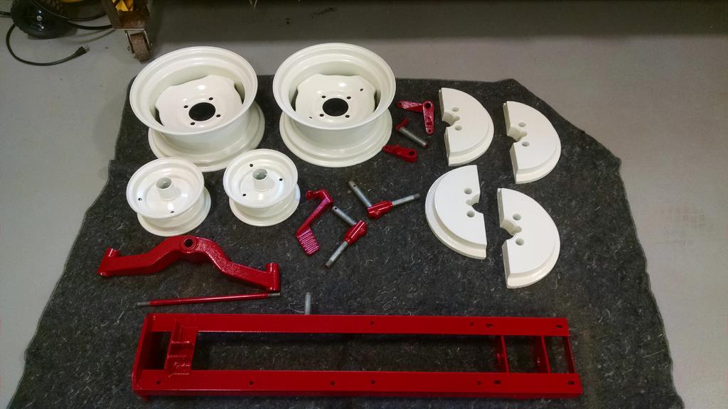

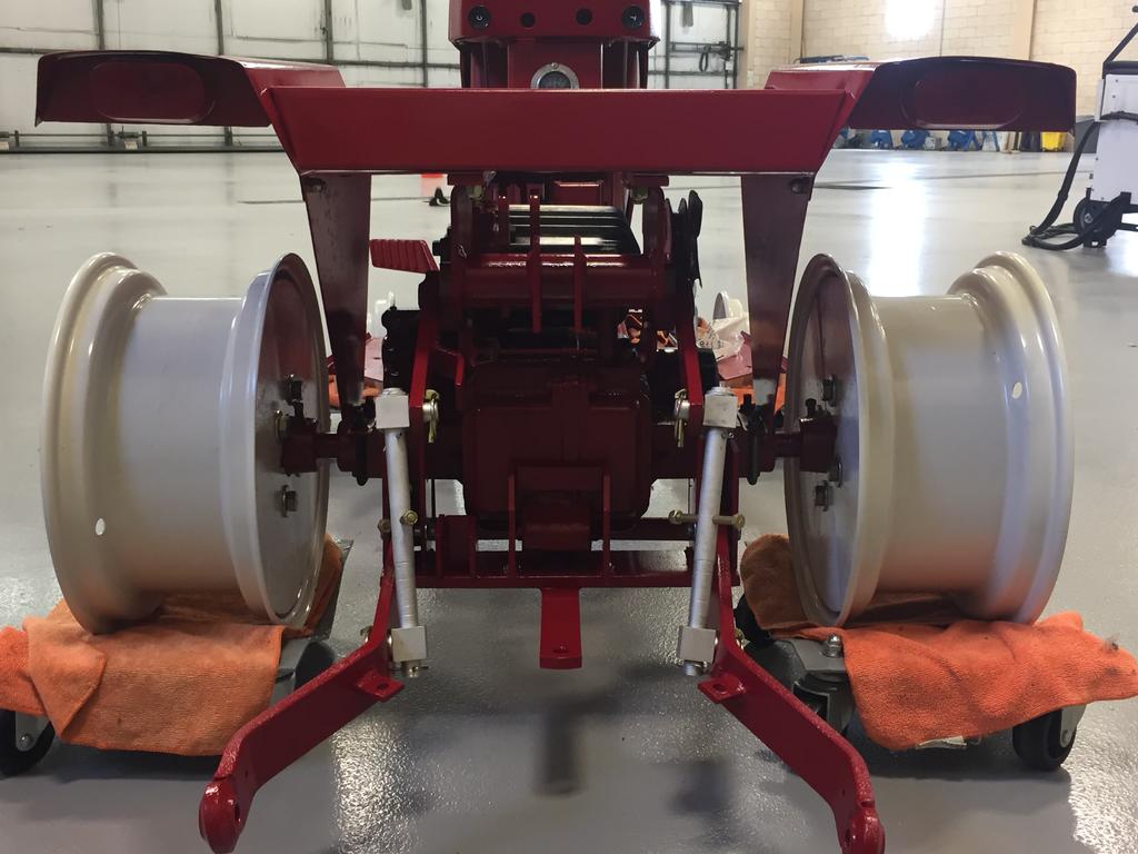

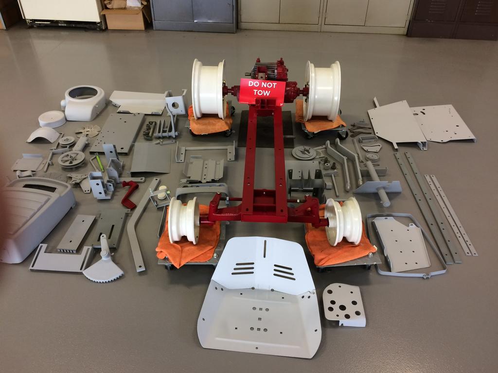

p38js 441 #1 Posted October 5, 2017 I’m in the midst of restoring a GT14 to her formal glory. And I keep reading that the 14 had her own set of attachments. So far the only attachment I have seen so far is the tiller. Can someone post some pictures of the other attachments such as a snow blower. Here are a few pictures of my restoration: 5 8 Share this post Link to post Share on other sites
Jerry77 1,218 #2 Posted October 5, 2017 Looking good......and really nice shop..... 2 1 Share this post Link to post Share on other sites
hondagod64 81 #3 Posted October 5, 2017 Very nice..pics when complete would be nice to see 1 Share this post Link to post Share on other sites
19richie66 17,770 #4 Posted October 7, 2017 Wow, you can walk around it without hitting anything. Nice job going there. Sorry not much help with original question. 1 Share this post Link to post Share on other sites

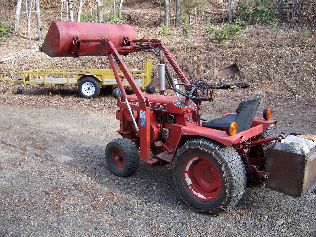

953 nut 63,549 #9 Posted October 7, 2017 1 hour ago, p38js said: always on the look out for other attachments The front end loader is my personal favorite. 2 hours ago, ztnoo said: rear mounted tillers (7-1231 and 7-1332) for GT 14s, were GT 14 specific, and wouldn't fit other models. C-195 with a three point hitch will use them too. 1 Share this post Link to post Share on other sites

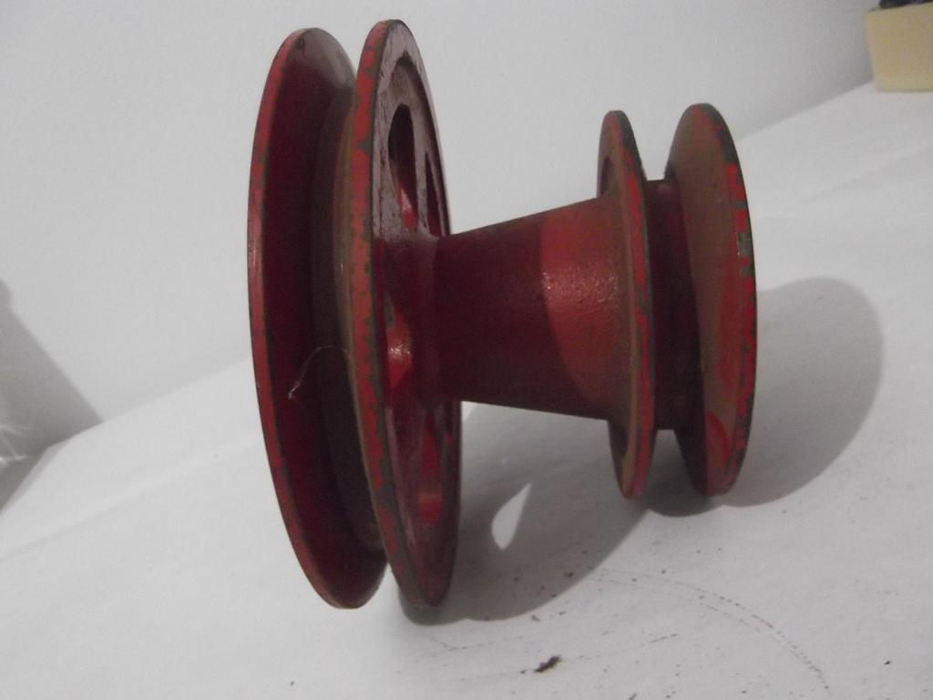

ztnoo 2,300 #12 Posted October 7, 2017 Does a C-195 have a special double pulley like a GT 14 to drive the hydro & tiller, or is a tiller mounted to it powered in some other fashion??? Share this post Link to post Share on other sites
953 nut 63,549 #13 Posted October 7, 2017 It would be driven by a belt from the PTO routed under the running board just like the other tillers of that era. I don't have a photo of it but have seen one mounted on the three point of a C-195 and the owner said he had it on the GT-14 for several years before he sold it. Said that twin would really turn some dirt! As I recall it the belt went to a double pulley down near the lower pivot point and a second belt with tensioner was driving the tiller. Was it factory , I don't know but it appeared to be. Share this post Link to post Share on other sites

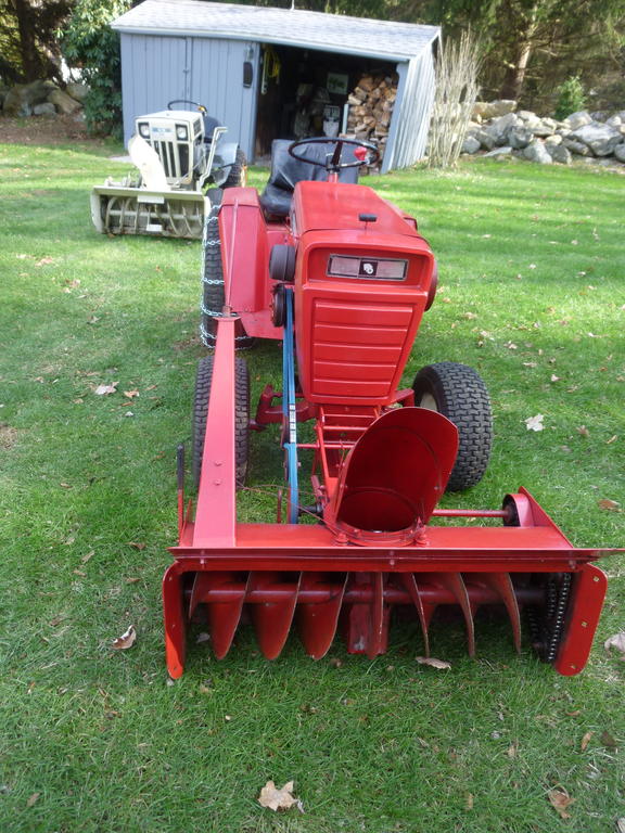

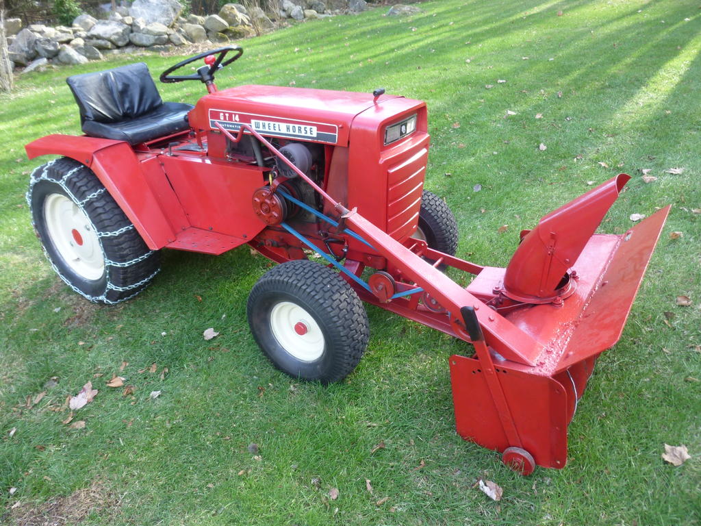

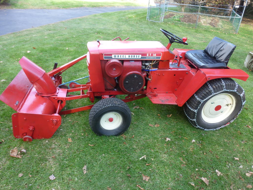

Rob R 977 #16 Posted October 8, 2017 Hard to find actual "made for" GT14 attachments and if you do pricey.... soo I mounted a front Attach-a-matic from a C-81 and then mounted a standard snow blower..... with some minor adjustment like belt drive size and additional Idler pulley it works like a charm.... 2 Share this post Link to post Share on other sites
p38js 441 #17 Posted October 8, 2017 Thank you Rob R. your pictures are what I was looking for. That setup looks good how does it perform in snow. Did you mount the attach-o-mastic to the front plate or did you fabricate a bracket and attach it to the bolt holes on frame? 1 Share this post Link to post Share on other sites

Rob R 977 #22 Posted October 9, 2017 5 hours ago, p38js said: Thank you Rob R. your pictures are what I was looking for. That setup looks good how does it perform in snow. Did you mount the attach-o-mastic to the front plate or did you fabricate a bracket and attach it to the bolt holes on frame? Performs super, upcoming 3rd season with NO issues to date. Did a combo; attached to front plate but reinforced with braces to the frame. Share this post Link to post Share on other sites
