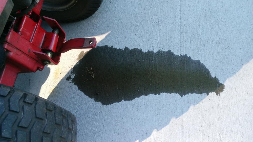

Mt Zion 520H 43 #1 Posted October 3, 2017 Haven't used it in a couple weeks and noticed wet spot on driveway underneath it. Thought fuel line but feels like oil. What would cause this and what should i do to fix it? Any and all help is greatly appreciated. Share this post Link to post Share on other sites
Jerry77 1,218 #2 Posted October 3, 2017 Did you recently change the oil or add to it...? it will burp some out while sitting until it gets all the air out... 1 Share this post Link to post Share on other sites
Ed Kennell 41,922 #4 Posted October 3, 2017 Hose leaking ? Share this post Link to post Share on other sites
ericj 1,579 #5 Posted October 4, 2017 did you hand push it any, I've had some off mine do that from time to time never quite sure why, expansion and contraction from heating and cooling ???. check fluid level and move on and see if it does it again eric j Share this post Link to post Share on other sites
lynnmor 7,813 #6 Posted October 4, 2017 One time mine burped like that, but not quite that much. I suspect that the oil drains down from the filter or hydro and in effect overfills the case. Share this post Link to post Share on other sites
1995 520H+96+97 937 #7 Posted October 4, 2017 The transmission oil fill (dipstick) tube is loose, it is threaded into case. Remove rear fender pan and put thread tape on oil fill tube. 3 Share this post Link to post Share on other sites
Mt Zion 520H 43 #8 Posted October 4, 2017 (edited) Weird but i think the fluid drain back / burping may have been it. Driveway is at a slant and rear was lower.. I lifted seat to pull dipstick only to see fluid near top so It seems like it was spilling out from there. I started it, raised deck, drove it over to other driveway, parked sidways and re-checked dipstick.. Now the oil is not visible inside the tube. Thanks a lot brothers! Edited October 4, 2017 by Mt Zion 520H Add 2 2 Share this post Link to post Share on other sites
