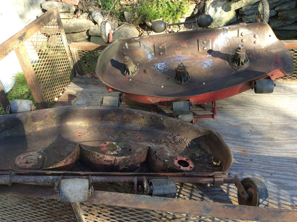

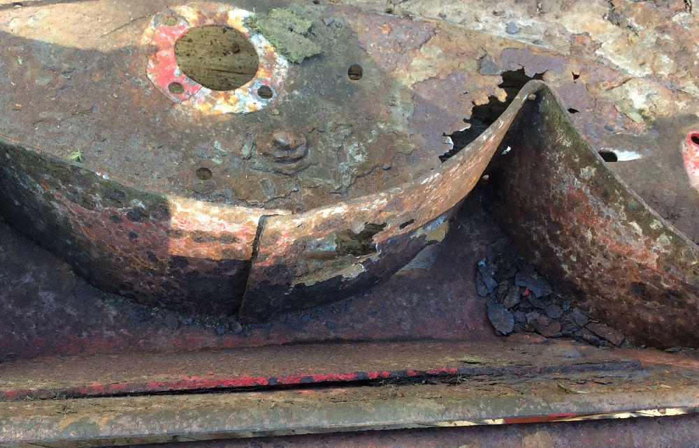

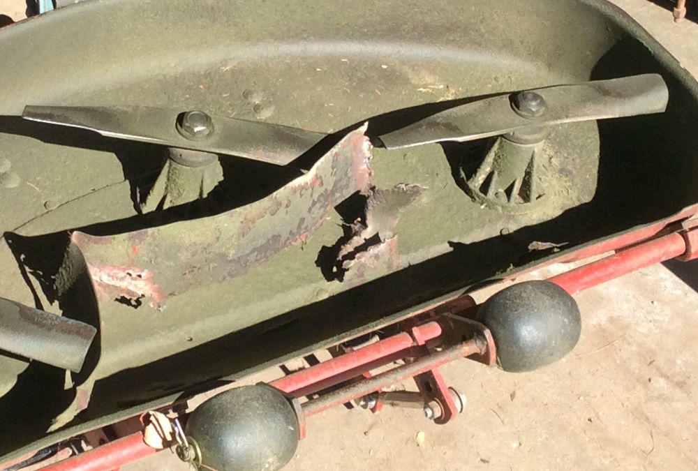

FatJackDurham 318 #1 Posted October 1, 2017 So, I found A problem on the 42" mower deck on my 416-8. It commenced to making a horrible racket while backing up, so I stopped and took a look. Yup, there's your problem.... I was going to cut the baffle out of the old rotten deck I had replaced with the above... But a few whacks with a hammer to check how the baffle was revealed some rot in the center section.... So, what are my options for fixing the original deck? Does anyone have a spare baffle I can weld or bolt in? Should I run without the baffles and live with the performance? What are my options here? BTW, for those of you keeping score, this is the third time I have tried to mow with the 416-8 and the third time I have had issues.... 1 Share this post Link to post Share on other sites
SylvanLakeWH 30,643 #2 Posted October 1, 2017 Perhaps a metal plate "sandwich" with the spare old baffle in the middle? Weld / bolt together and start mowing... Share this post Link to post Share on other sites
Searcher60 209 #3 Posted October 1, 2017 I think Toro stills sells the baffles by themselves. Share this post Link to post Share on other sites

ohiofarmer 3,383 #5 Posted October 2, 2017 I would clean up the junction points on the rotten deck and then spray paint it [one side of the baffles] so you have an accurate pattern to reference. Once you remove the baffles, it is too late to do that. It would not be that hard to cut some better material out of the old deck to make new baffles or get sound metal to patch the old ones. If you are afrid that you might blow holes through the deck while welding on the baffles, you could weld mounting tabs to them and bolt them to your deck. If you use tab mounts, the entire deck could be rustproofed before the install of the baffles. I really like this stuff to paint on the bottom of your surviving deck. Does a great job of sealing the deck against corrosion. http://www.agriguardcoatings.com/home.html I have two seasons on a deck [Huskee 54' by MTD} that was solid but had cheap steel with heavy, flaking rust After really pecking all the loose stuff off and wirebrushing, the Agri-Guard dried like glass and is holding up well. 2 Share this post Link to post Share on other sites
Sarge 3,470 #6 Posted October 2, 2017 It's not too difficult to make a set of new baffles - find a local welding shop that can roll sheet metal with a slip roll , good shops will have one . They can use flat sheet stock sheared to the right width , roll the shape into it by taking note of the blade length and determine the radius needed to clear the blades closely . A few simple tack welds and you're good to go...the shop next to me builds them quite often for older decks . I've made a few of my own here but I have all the equipment needed except the slip roll - I just use a large piece of pipe to roll the metal into the needed shape , then weld the joint where the two baffles meet . That's easier than making one large circle and bending it properly , which is how they were done originally . Btw - it's best to leave a small gap between the baffles and the deck to allow it to be fully cleaned - otherwise it will rot the deck shell in a hurry by holding moisture in that joint . You could cut the welds out of that example piece with an angle grinder and a thin cutting wheel - take that to the shop as a template for new metal . Sarge 1 Share this post Link to post Share on other sites
FatJackDurham 318 #7 Posted October 2, 2017 I have one space on the new deck that has rusted through, so I may tear it apart and have the whole thing sandblasted. Thanks for the tip on the paint, I'll definitely look into it. I think I will fabricate new baffles from scratch and bolt them in place with tabs. I don't feel like I want to weld on this deck, unless of course I do decide to have it sandblasted completely. I don't have a MiG, just a TiG and Stick, and Gas. Share this post Link to post Share on other sites

Kelsey 91 #11 Posted June 16, 2020 Currently, I have the same 42" SD deck. The baffle isn't as corrodes as the one in the photos. Mine does have to be repaired. My question is: can fiberglass and bond-o be used? Share this post Link to post Share on other sites
