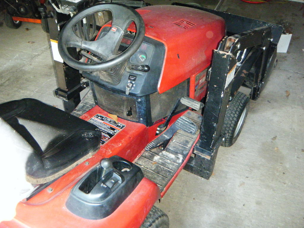

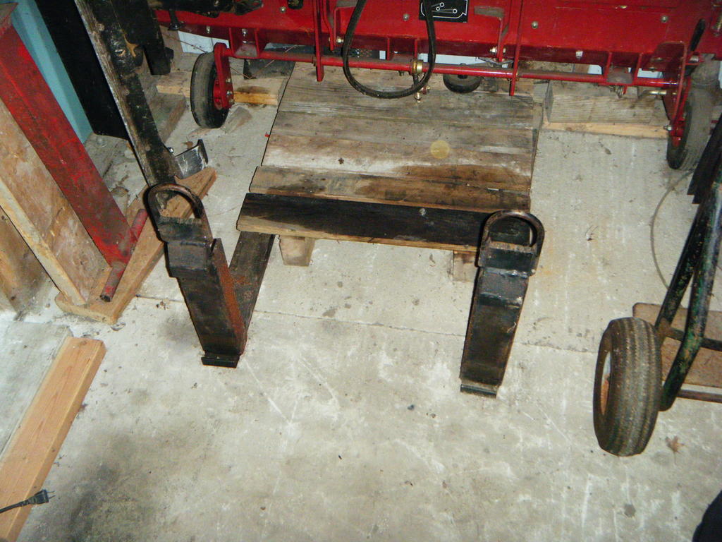

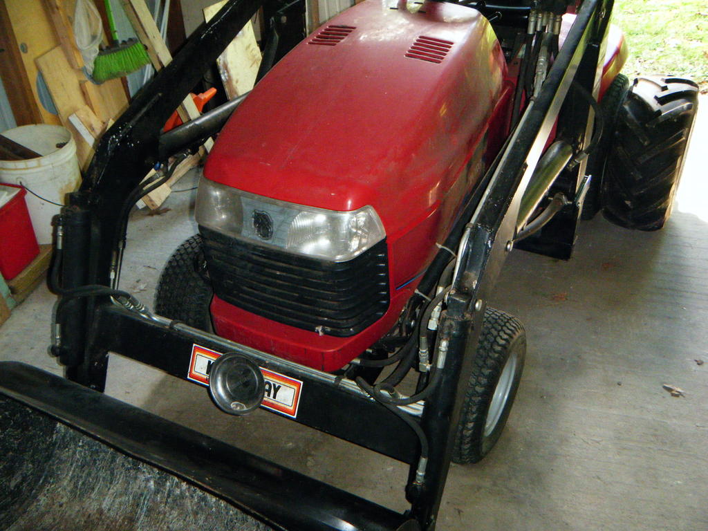

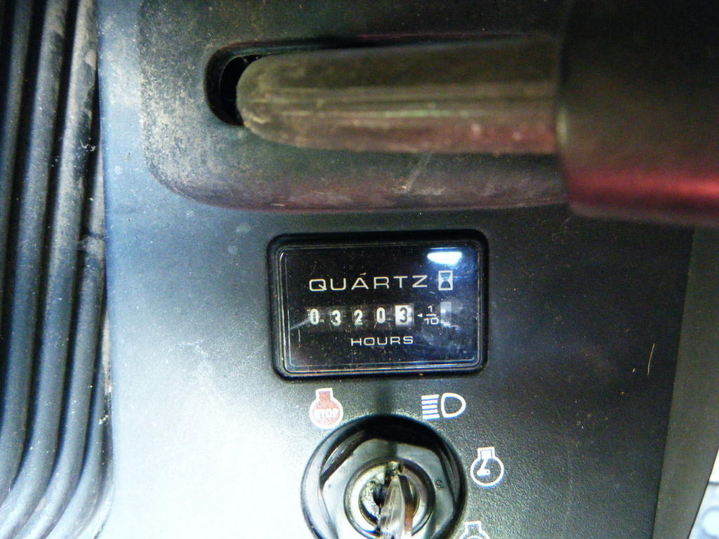

Blonde-Tiger 16 #1 Posted September 29, 2017 Just came across this Wheel Horse Toro . Has less than 400 hours. Can you please tell me the year, model and value. Comes with the front loader, deck and forks for the loader. Thank you very much. The owner is starting at $5000 5 Share this post Link to post Share on other sites

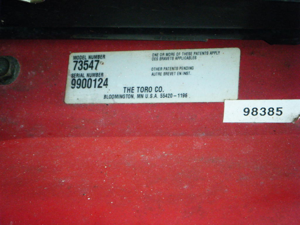

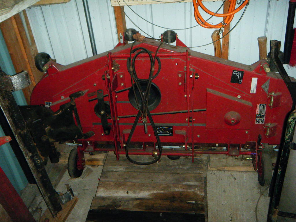

gwest_ca-(File Mod) 11,845 #5 Posted September 29, 2017 Will guess the deck is 60". Possibly this one Garry 2 Share this post Link to post Share on other sites

shallowwatersailor 3,216 #8 Posted September 29, 2017 Those are good hours for a 1999 520Lxi. It has a Kawasaki liquid-cooled engine that has had problems in the past with a nylon cam gear failing when the metal insert would separate from the nylon gear. At some manufacturing run number, it was changed to an all metal gear. Somewhere on the forum is that information. It happens to be the one version that I don't own! There are a few members that have a 5xi with a FEL who might pipe in. With those hours and the appearance in the photos, it looks like a good candidate. My feeling is that the price might be slightly bit high. 3 Share this post Link to post Share on other sites
DennisThornton 4,772 #9 Posted September 29, 2017 Awesome! I have one. Pay very close attention to what "shallowwatersailor" just said! Your Kawasaki might have the plastic cam gear and the word is that it WILL fail. But, it's all fixable with some time and some money. I would LOVE to have the FEL! I think it's worth what the buyer is asking IF your model does NOT have the plastic cam gear. (Heck it might be worth it if it does but get the owner to pay attention to the below!) Here's my notes. Video of replacing cam gear Http://www.wheelhorseforum.com/topic/55095-1998-520-lxi-worker-rehab-survivor/#comment-512059 Steel camshafts replaced the plastic version in production models starting in February 1998 in FD620 engines so this problem does not apply to the following engines. FD620D-CS00 ? Beginning serial 153727 ? John Deere Model F911 FD620D-DS02 ? Beginning serial 149283 ? John Deere Model 425 FD620D-CS01 ? Beginning serial 150198 ? John Deere Model 445 FD620D-ES11 ? Beginning serial 152490 ? John Deere Model 6×4 Gator "In February of 1998, steel camshafts went into all 620D engines. The following engine(s) should have the steel camshaft and stiffer valve springs. FD620D-DS02 with the beginning engine serial number of 149283?" http://www.wheelhorseforum.com/topic/55095-1998-520-lxi-worker-rehab-survivor/?hl= lxi The same motor (basically) was used in the John Deere 425 tractor. I think - you need to verify this independently - that kawasaki changed to a steel camshaft gear in 1998 so I think all Lxi's are free from that affliction. It is my understanding that if the plastic gear fails, you have better than 50% odds that the engine will survive the event without further damage. Lxi models initially came with a plastic cam gear, if hasn't been replaced for the steel one, that will have to be done around 1000 hours or you'll have a mess in the engine 2 2 Share this post Link to post Share on other sites

Blonde-Tiger 16 #11 Posted September 30, 2017 The paint is pretty dull. I heard about this plastic gear problem when I researched a John Deere I found for sale last year. I am sorry to now know this Red Guy has the same weak point. We were talking casually when I got the 5K price. I am going to try an offer of half of that with the intention of 3K as my best offer. I will use the plastic cam gear as negotiation leverage. I don't need another tractor but I want this one. Thanks for the info. 3 1 Share this post Link to post Share on other sites
jellyghost 378 #12 Posted September 30, 2017 3k would be a decent price. At 5k you can occasionally find a diesel yanmar or Kubota. I love Wheel horse's, but at 5k I would get a Kubota and save up $500 to get a nice c-series Wheel hHorse. I think the kubota would be a more functional with a front loader, and it would retain value better. 2 1 Share this post Link to post Share on other sites

shallowwatersailor 3,216 #15 Posted September 30, 2017 12 hours ago, Blonde-Tiger said: The paint is pretty dull. I heard about this plastic gear problem when I researched a John Deere I found for sale last year. I am sorry to now know this Red Guy has the same weak point. We were talking casually when I got the 5K price. I am going to try an offer of half of that with the intention of 3K as my best offer. I will use the plastic cam gear as negotiation leverage. I don't need another tractor but I want this one. Thanks for the info. I am actually thinking more in the 4K price range including the deck. From appearances the deck is probably worth $700-900 alone. At 5K you are in the Kubota B6100/7100 with 4WD range that are about ten years older like jellyghost mentioned. They are popular in horse country where the owners use them to clear out the stalls. The paint should come back with some polishing. It doesn't appear to have been left outside. Those really get dull. 1 Share this post Link to post Share on other sites

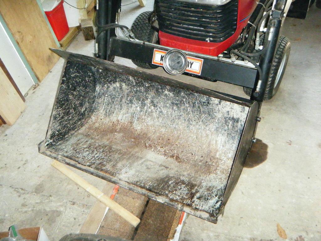

emdmat1981 62 #16 Posted September 30, 2017 A few additional items to check for upon inspection: Look for leaks or puddles under the front end loader cylinders / connections / hoses. One good indication is to look where the machine is regularly parked to get a good visual on places to check. Also check the rear for leaks and / or axle wear. Although the rears on the 5xi's are quite durable and reliable under normal to even extreme circumstances like anything mechanical if pushed real hard hard or abused (which can happen with a FEL attached) seals and bearings can wear prematurely. Not to say this is the case with your target tractor but something to look for .... Ed Share this post Link to post Share on other sites
