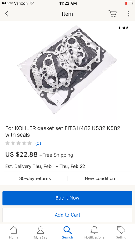

pacer 3,176 #4 Posted September 26, 2017 Bug, As far as I know there is NO complete kit for the big 18 & 20 hp, I seem to remember running across a Gasket kit on the bay when I did my last rebuild (a bit pricy!). But as far as pistons/rods/etc there just aint any --- although with a little finagling/research you CAN replace your pistons/rings (dont know about valves, mine were good) - you'll have to cross your fingers if you need a rod!Even so, my 482 had one that a rod bolt stripped out on reassembly so I started a close watch on the bay and after about 2 weeks a guy had a NOS rod he had bought years before for his Deere and just never got around to using it and listed it --- for the amazing price of $65!! needless to say I pounced on it. The piston/rings from the single cyl K series engines will fit and there are dozens of those always on the bay - IIRC the K301 and the K321, with the K321 fitting the 532 (check me on this...) My 20hp came to me blowing horrible smoke and I was dreading what the cause might be! But, strangely enough, the PO - I guess- had did a rebuild with doing a bore to .020 and whoever did the assembly "stacked" the rings, on both cyls!! - I replaced both pistons/rings - and NOT stacking the rings and touched up the valves and that thing runs like a dream! My 18hp was beginning to puff a little smoke, so decided before it got too bad to look into it before something came loose. Everything was in really good shape so I just decided to just do the piston/ring replacement again, and cleaned up the valves --- until I goofed and stripped that rod bolt I mentioned, boy did that give me a scare!! I used the 'cheapo' piston/rings and I now have some 20-30 hrs on them and both are doing fine I only replaced head and exhaust gaskets on my 2 builds and that has also worked out good. Share this post Link to post Share on other sites

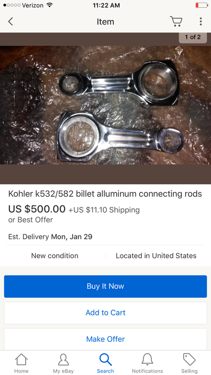

Desko 610 #6 Posted January 23, 2018 I found these on ebay and I think even for them rods thats nuts but they're ment for high rpm pullers lol Share this post Link to post Share on other sites

Sarge 3,464 #8 Posted January 24, 2018 Hmm, aluminum billet rods - lord help us you never should have showed me that...lol. Wonder just what I can squeeze out of that D-180....? Sarge Share this post Link to post Share on other sites
