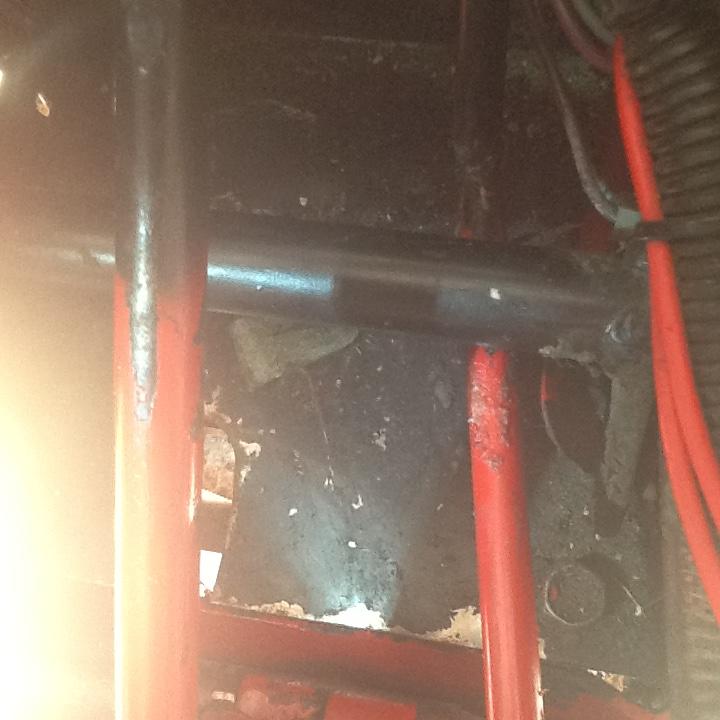

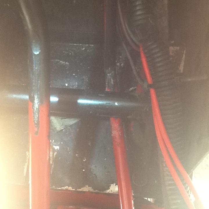

R310WH 1 #1 Posted September 24, 2017 I am new to this forum but have owned a 310-8 for 30years. I just replaced the needle bearings and seals on the axle and reinstalled the transmission . It was a long project because I was waiting for parts. Now that I have attached the trans to the tractor I have a question; I can't remember if the high/low gear lever goes under/over the shaft that operates the brake. I have attached pictures in hopes someone can let me know if that lever goes under or over that part. Thanks 1 Share this post Link to post Share on other sites

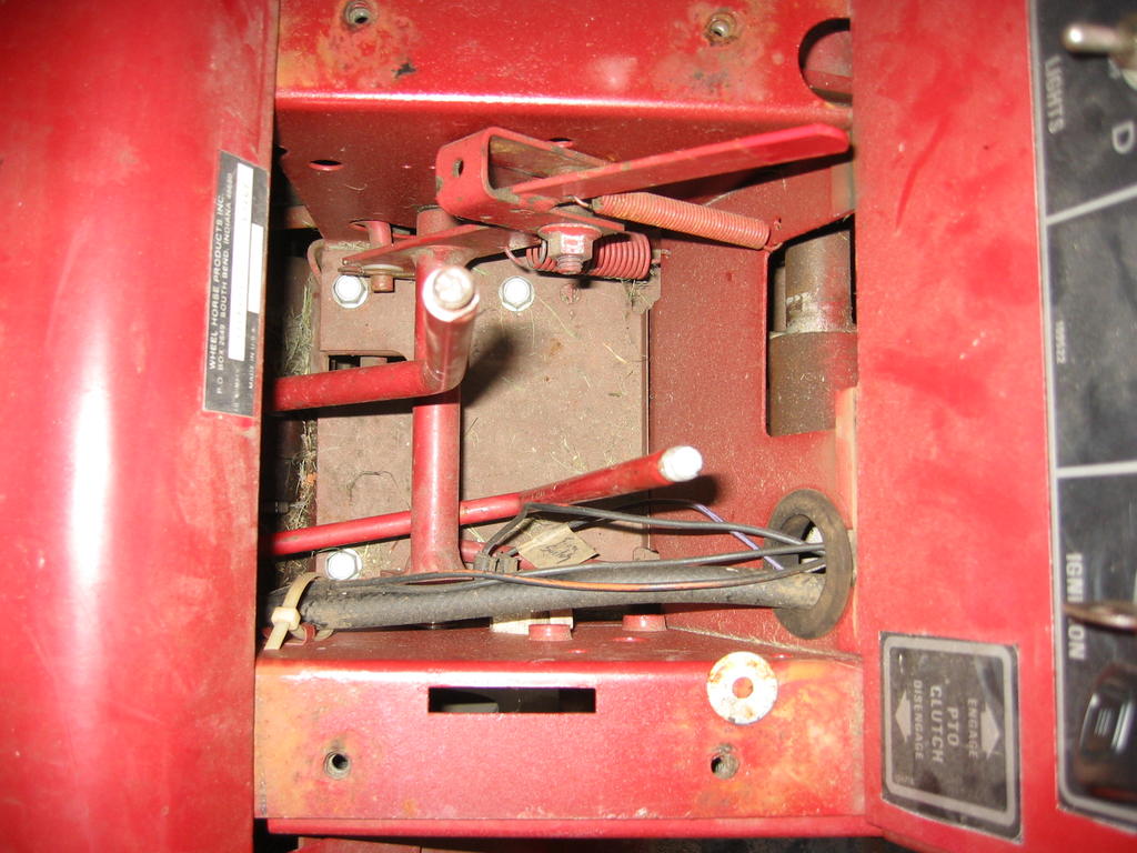

pfrederi 19,511 #2 Posted September 24, 2017 (edited) Under ..Pic is my 310-8 Great little machine!!! Welcome!!! Edited September 24, 2017 by pfrederi 1 2 Share this post Link to post Share on other sites

R310WH 1 #5 Posted September 25, 2017 Thanks for the your help and the picture helps a lot . Share this post Link to post Share on other sites
