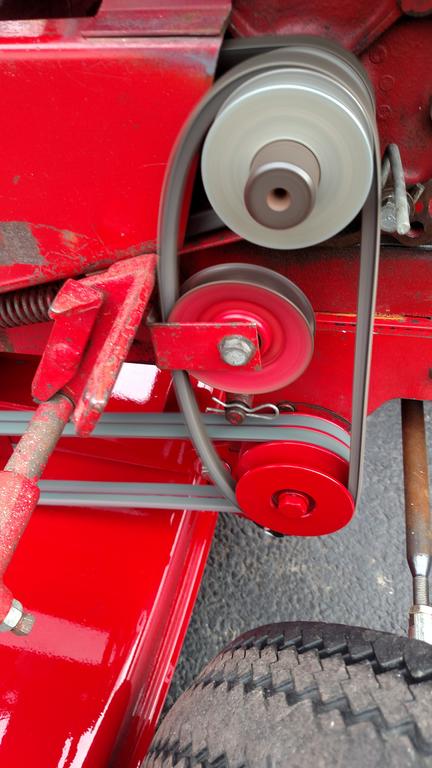

mikeeyre74 289 #3 Posted September 20, 2017 this is what I got. Two decks, both the same. Some obvious weirdness on each... will need some repair. Some weird strap on this one.. and that plate in my hand you can see there and some weld on this one. This doesn't have the plate that the other one does These pedals are already on my 552... and I have this Speed Hitch (I think it's called) as well. Is is there a pulley missing that I'm supposed to have? Some seem to have it and some dont? Share this post Link to post Share on other sites
RedRanger 1,470 #4 Posted September 20, 2017 You're missing the rest of the front quick hitch and the idler pulley for the foot clutch. Share this post Link to post Share on other sites
mikeeyre74 289 #5 Posted September 20, 2017 As far as the quick hitch goes, can I use a standard late model Tach-O-Matic? I Have plenty of those kicking around... Can the idler pulley be fabricated or is it better off to search for one, do you know? 1 Share this post Link to post Share on other sites
