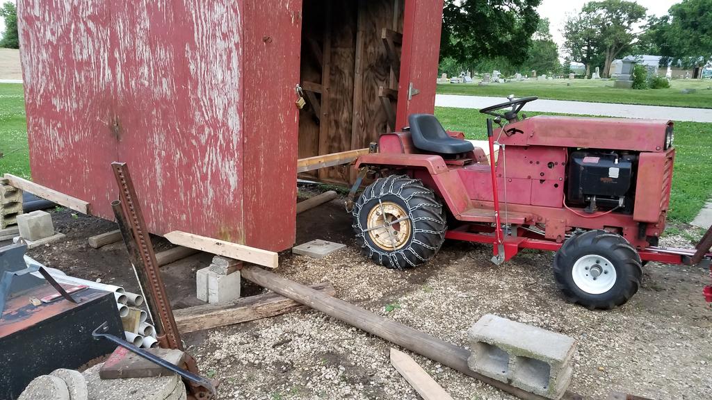

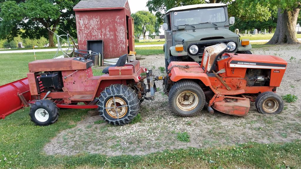

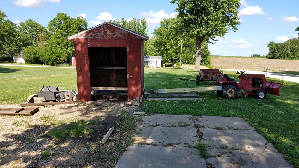

Sarge 3,470 #15 Posted September 20, 2017 Well , about a 300lb floor frame section - Around 400lbs worth of dead Allis/Simplicity 916H - Well north of 500lbs holding the stupid shed up after a storm blew it off the blocks that were holding it up - Yeah - hydraulics will pick up far more weight than the tractor can handle - at the high risk of seriously damaging things , including the rear axle and frame . Previous owner had cracked both end balls on the lower arms , I did have to make whole new arms as they were bent up pretty badly . I blew the pump coupling pulling a couple of tons on the 6-1/2x12 utility trailer (contents of that shed during the floor replacement) , still fixing that little misguided judgement move . Also , at the same time/day , bent the whole nose of the trailer when I had to put it on the jack overloaded - wrapping up the repairs/rebuild now . Expensive day over one dumb decision ....go figure . If you need more lifting power than 350lbs or so , I'd be hunting a larger machine - there are limits to these things that cost a lot of money to fix . Sarge 1 1 Share this post Link to post Share on other sites
