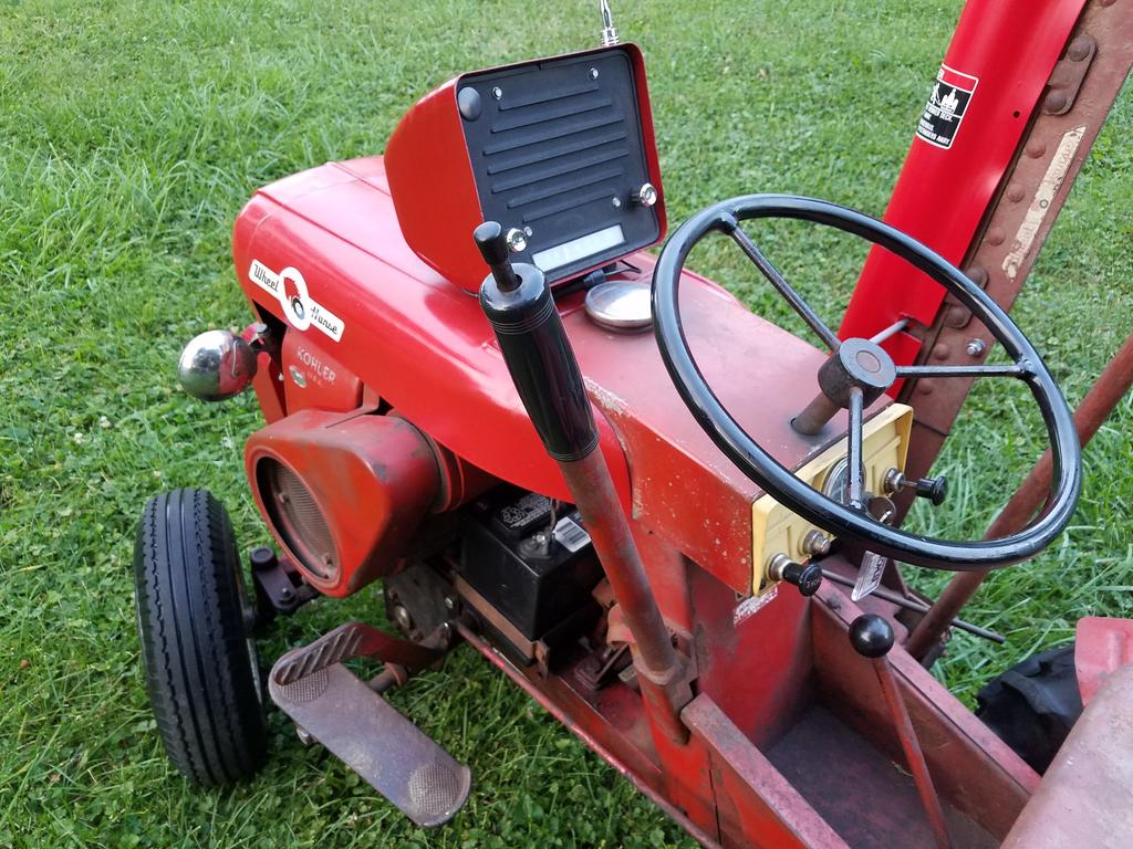

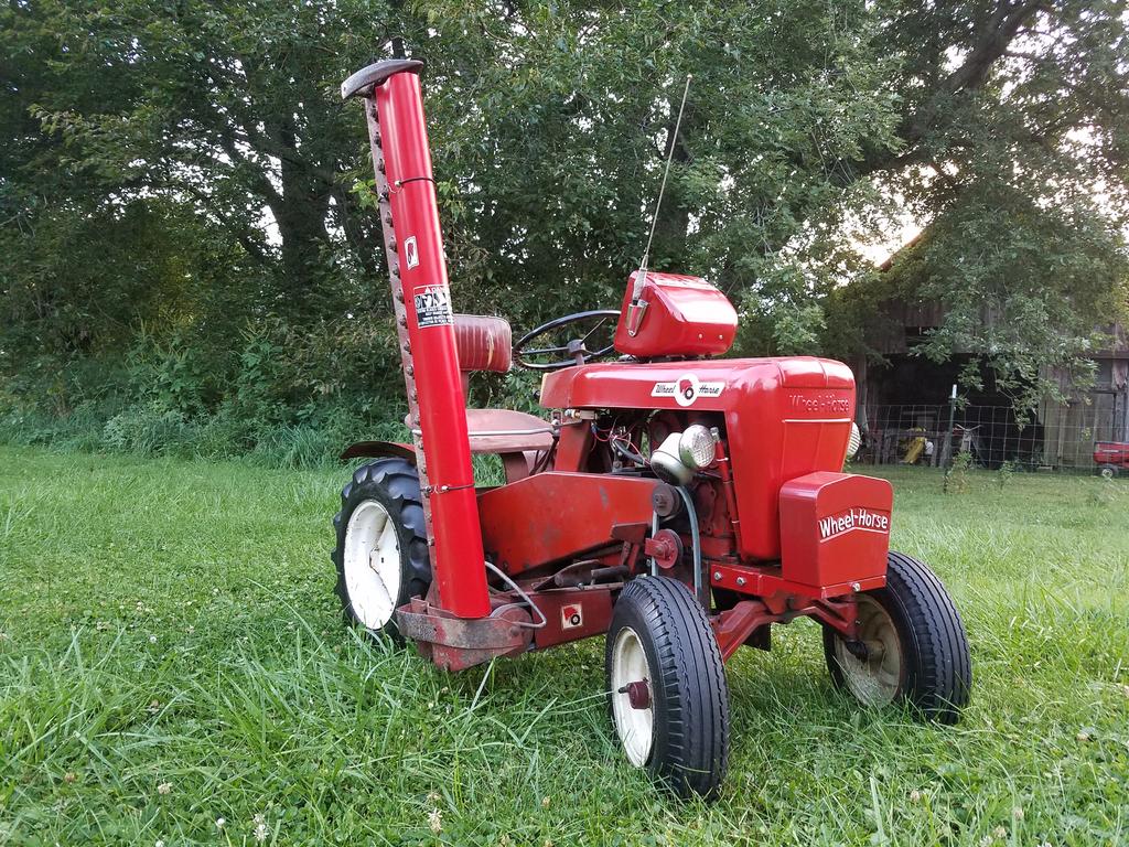

hcminis 1,762 #3 Posted September 21, 2017 It's not actually attached as didn't have the heart to drill holes in any of my tractor hoods. 2 2 Share this post Link to post Share on other sites
Sarge 3,470 #4 Posted September 21, 2017 I've often wondered if you could actually hear one of those while the engine is running...? Cool accessory though - does anyone know who made them ? Looks like a few other tractor radios that were available for the larger farm equipment... Sarge Share this post Link to post Share on other sites

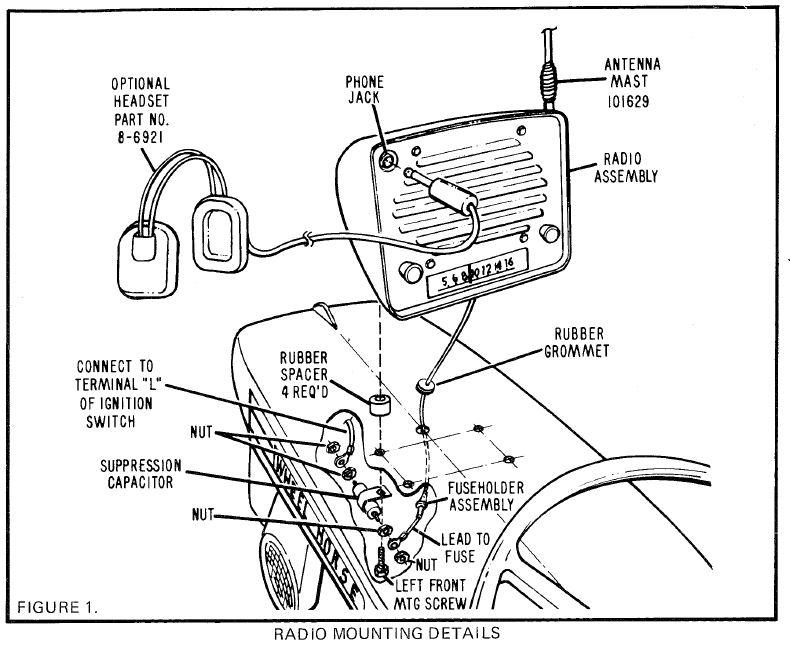

CasualObserver 3,414 #5 Posted September 21, 2017 1 hour ago, Sarge said: does anyone know who made them ? Bendix. Not shown in the diagram is that you were supposed to also use a RF shield under the hood to cut out (or more likely down) the electric interference from the engine. 2 1 Share this post Link to post Share on other sites

Sarge 3,470 #7 Posted September 22, 2017 Cool info - that explains the holes in the one of the round hood tractors I had years ago....can't imagine doing that to any tractor I have today . Sarge Share this post Link to post Share on other sites
