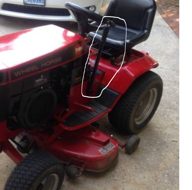

fmowry 11 #1 Posted September 13, 2017 Hell everyone. I signed up to the forum to get some opinions on a local 314-8 for sale. Based on the SSN it appears to be a 1996. Clean tractor with a 42" deck. The spindles have been replaced recently and it has new tie rod ends, new PTO belt. Pics look good for me. Also included is a snowplow and wheel weights. I am going to check it out tonight to see how it runs. Originally I was going to simply get a replacement for my tiny 28 inch riding Toro which I think snapped a rod (spins freely but no compression after hearing a big bang) but then I got to thinking about dealing with the rare snow here and getting something larger to handle my .75 acre lawn. I have a long driveway and so does my neighbor and we were talking about getting a walk behind snow blower. Seems like I could kill two birds with one stone. At firs the Wheel Horse seemed like overkill but I did a Chevy V8 swap in a Miata so I'm OK with overkill. Also I like to aerate because most of my lawn is zoysia so I'd be dragging a weighted tow-behind aerator and dethatcher occasionally. A couple notes. It'll need new blades. It has 9XX hours on it. Might need a tube in one front and one rear tire but that doesn't seem like a big problem. Slow leaks and I could always just fill them once in a while with the compressor til I replace them. The guy bought it from a local Maryland county gov't who used it to mow a local park. The guy seems somewhat knowledgeable and says he's done basic maintenance since he bought it a year ago but doesn't use it enough to justify keeping it. Wants to get rid of it because he has a much smaller yard. Asking price of $500 seems like a steal. Anything I should look for in particular when I go see it? Thanks, Frank Share this post Link to post Share on other sites
953 nut 59,737 #2 Posted September 13, 2017 4 minutes ago, fmowry said: $500 seems like a steal. That sounds like a wonderful price for the package. They are a very simple machine, no hidden issues to speak of, if it runs well and drives weel go with the full asking price, if you don't other will. Share this post Link to post Share on other sites
fmowry 11 #3 Posted September 13, 2017 Just now, 953 nut said: That sounds like a wonderful price for the package. They are a very simple machine, no hidden issues to speak of, if it runs well and drives weel go with the full asking price, if you don't other will. That's what I thought from reading similar posts here. The pics are certainly better than many I have seen that have gone for a higher price or are for sale in other parts of the country. Appreciate the quick response. I plan to go see it tonight. Anyone know if with the deck off, it fits between the wheel wells on a the bed of a 2001 S-10? I I'll take a tape measure but would have to go get the pickup tomorrow. Share this post Link to post Share on other sites

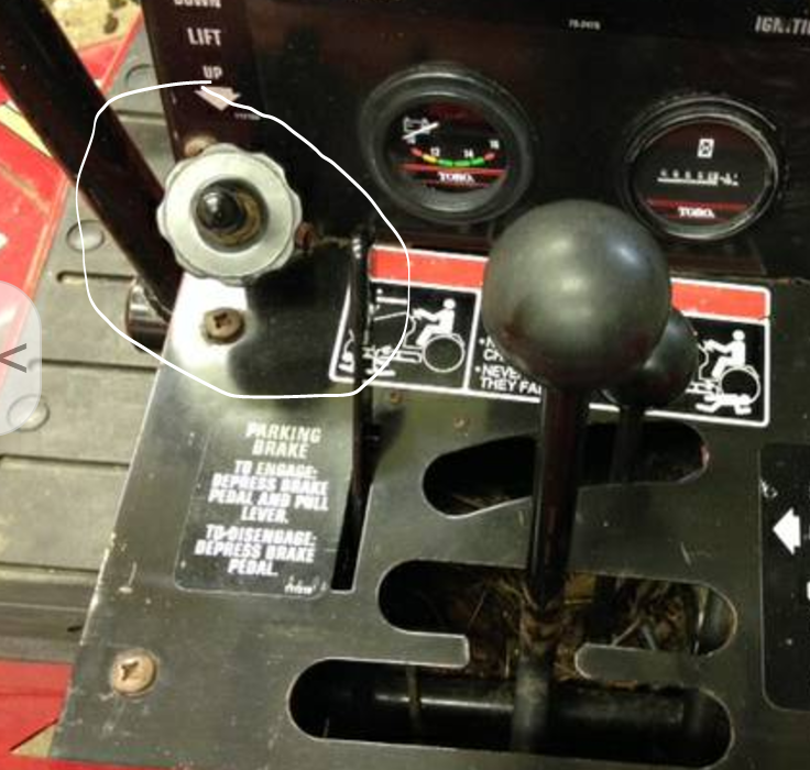

"Manic-Mechanic" 1,266 #9 Posted September 14, 2017 (edited) I would check the lighted series of system checks on the left of the dash, make sure that they light up when you press the bottom button. The parking brake light won't light unless the brake is on. I had some electrical issues with mine, however, it is a 1990, and it was in the fuse holder.......Everything works then I agree 500 is a good price. You'll need a set of chains for the push blade in deeper snow. Edited September 14, 2017 by Oldman 1 Share this post Link to post Share on other sites

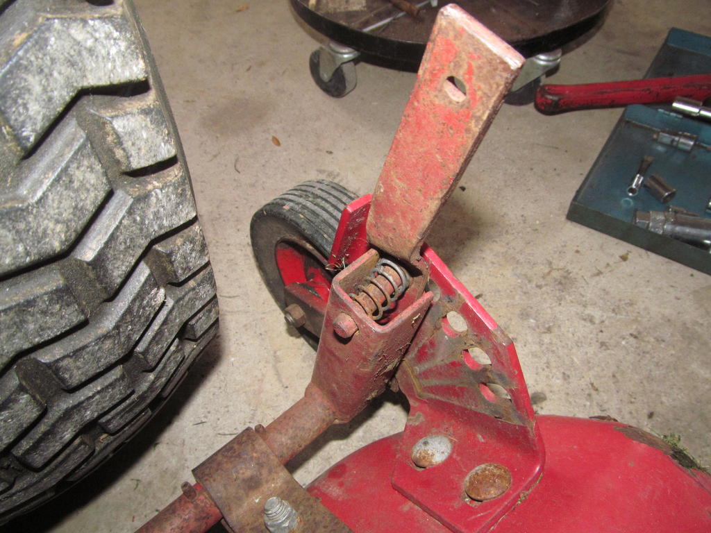

Ed Kennell 41,775 #12 Posted September 14, 2017 Looks like a good one. I see the deck height adjuster lever has been removed. I would ask him if he has the lever and spring. Share this post Link to post Share on other sites
fmowry 11 #13 Posted September 14, 2017 11 minutes ago, Ed Kennell said: Looks like a good one. I see the deck height adjuster lever has been removed. I would ask him if he has the lever and spring. You mean this? Or the dial-adjust. Share this post Link to post Share on other sites
Ed Kennell 41,775 #14 Posted September 14, 2017 No, on the deck itself. The two rear wheels are normally used to adjust the deck height. The lever and spring on your deck has been remover and the height is locked with a bolt. Share this post Link to post Share on other sites
fmowry 11 #15 Posted September 14, 2017 Gotcha. Thanks. That pictures worth a thousand words. Can't find a part number. That appears to adjust tilt front to back, correct? Share this post Link to post Share on other sites
Ed Kennell 41,775 #16 Posted September 14, 2017 Actually, if the threaded rod at the center rear of the deck is adjusted properly, the rear wheel height adjuster should adjust the entire deck...front and rear by the same amount. Here is a pic of the lever and spring. 1 Share this post Link to post Share on other sites
