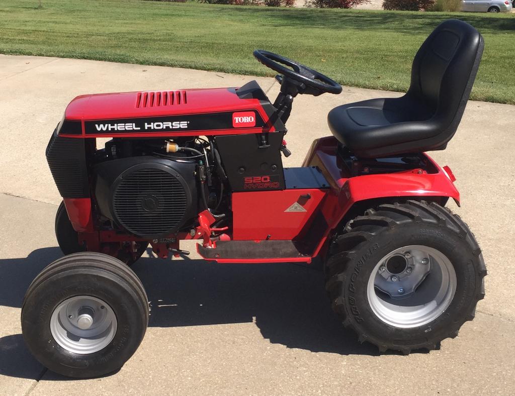

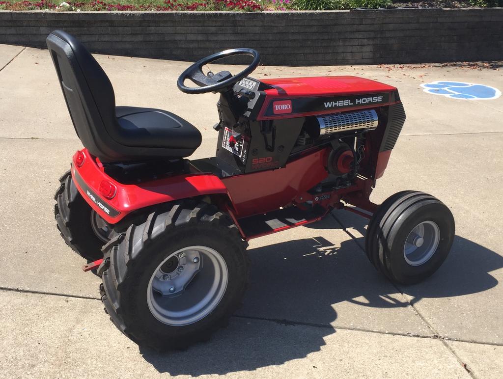

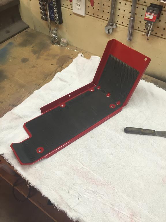

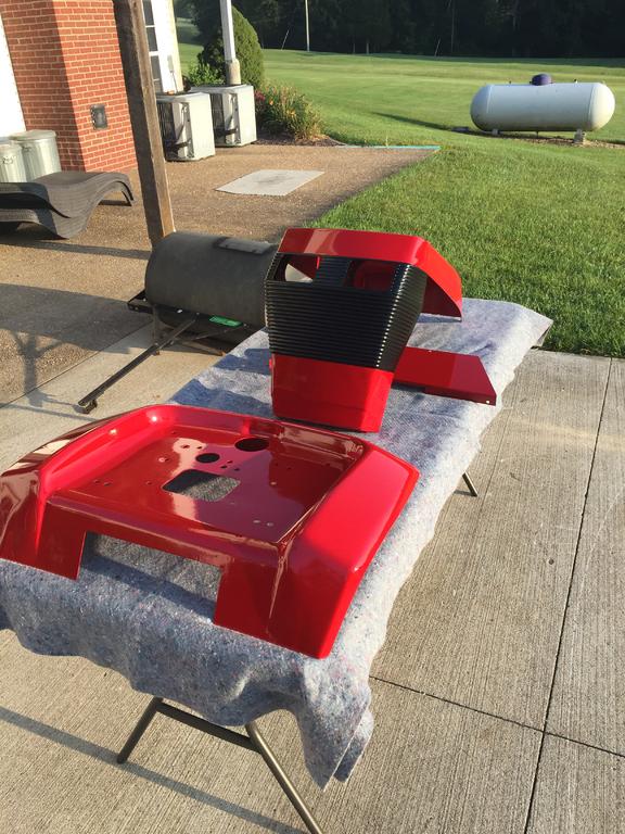

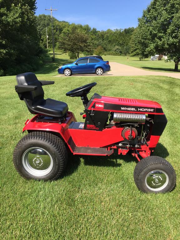

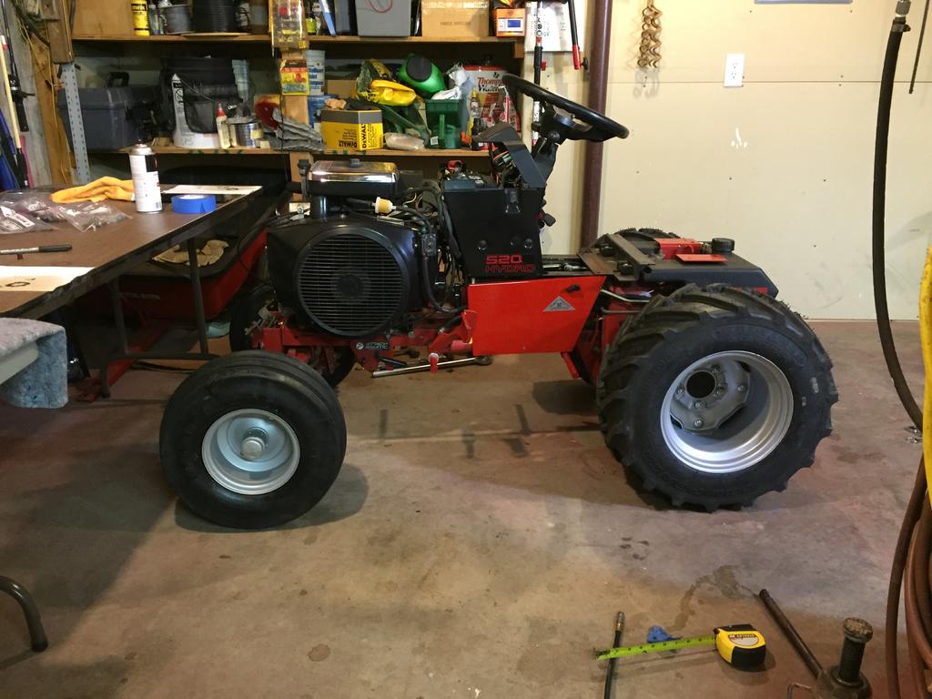

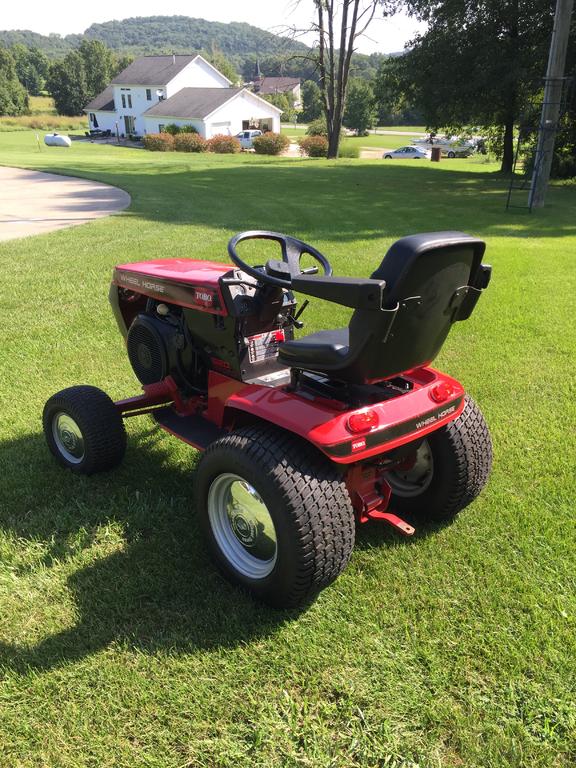

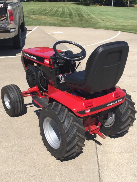

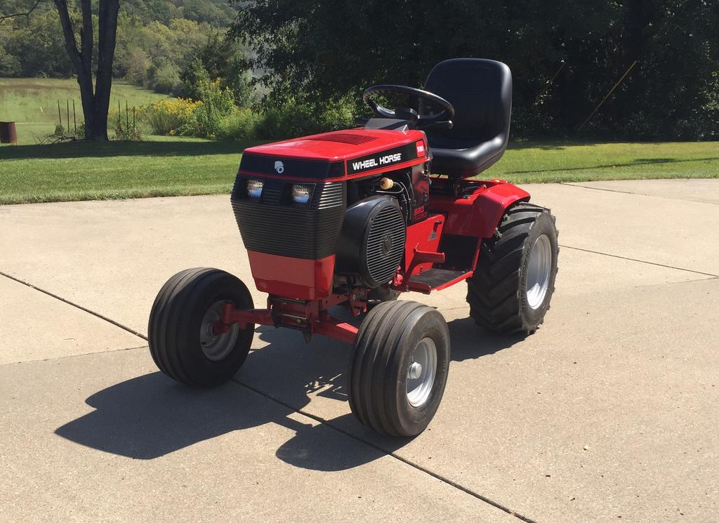

cschannuth 3,817 #7 Posted September 15, 2017 Got her back together. It's about a 20 footer but I like it. 6 4 Share this post Link to post Share on other sites
dclarke 4,082 #8 Posted September 16, 2017 Looks good, Craig! 1 Share this post Link to post Share on other sites

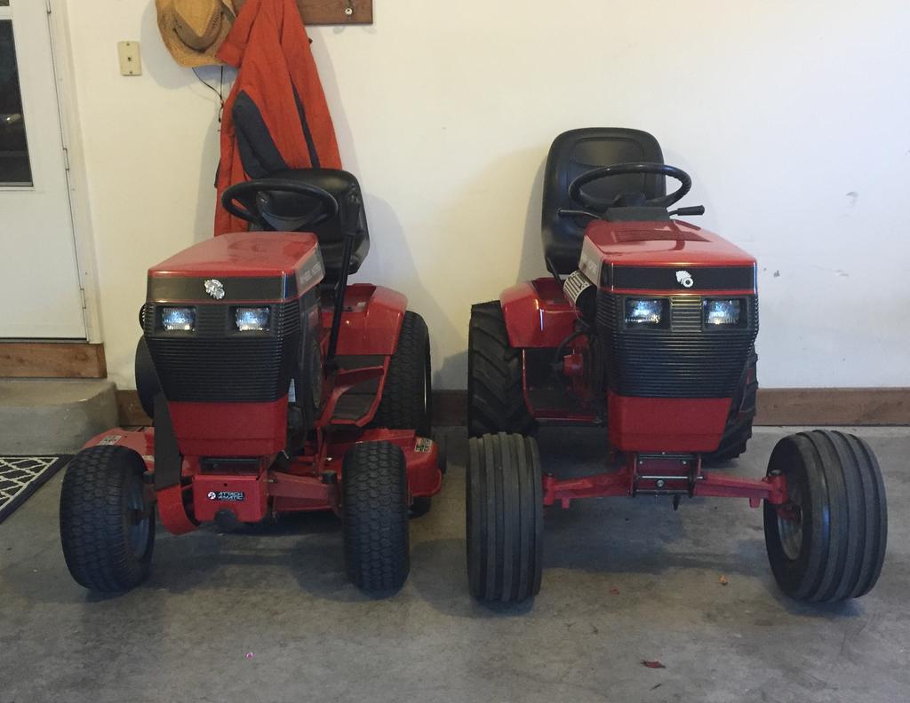

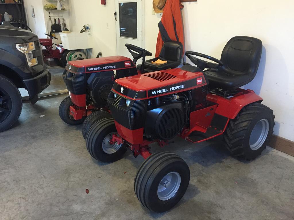

cschannuth 3,817 #9 Posted September 16, 2017 19 minutes ago, dclarke said: Looks good, Craig! Thanks for the advice and the lead on the seat. It and the switch worked like a champ. I was wondering what the size difference would be compared to my 314-8 so I parked them side by side. 4 Share this post Link to post Share on other sites

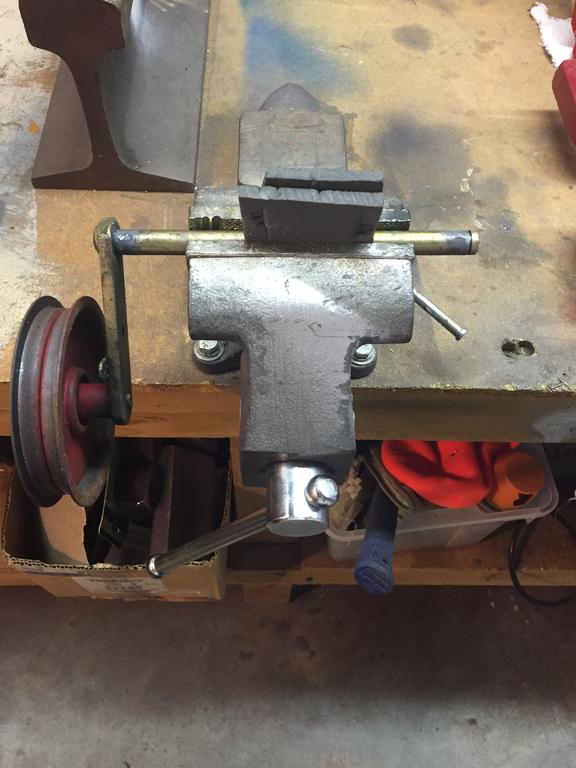

ohiofarmer 3,372 #10 Posted September 16, 2017 That idler pulley shaft eating through the bushing can be a real problem. The transmission support tunnel is so thin that there is a cutting action on the bushing. It is in a hidden area, but you need to OIL THEM. I did a farmer repair with one of these--a bronze flange sleeve bearing. https://www.fastenal.com/products/power-transmission-motors/unmounted-bearings/flanged-sleeve-bearings;jsessionid=B0ABBD78833CAB826C981A93157C9C4E.jvm3?r=~|categoryl1:"603582 Power Transmission 9and Motors"|~ ~|categoryl2:"610631 Unmounted Bearings"|~ ~|categoryl3:"612463 Flanged Sleeve Bearings"|~ I happen to have a 400 series that is a newer tractor, and there is a gas shock which applies tension on the idler pulley. It is much superior to the little spring that tensions my 520,and belt flopping is not an issue. This tells me that Toro knew they had a problem with the tension spring being too short and stiff and therefore not a constant force spring. I finally found a solution to the problem. A strip of rubber band cut from a bicycle or motorcycle tube applies constant tension on the swing shaft and vibration is all but gone. It really does not take gobs of tension on the belt to drive that Eaton because of the tremendous mechanical advantage. Of course, I just mow my yard and don't push snow. 2 Share this post Link to post Share on other sites
dclarke 4,082 #11 Posted September 16, 2017 9 hours ago, cschannuth said: Thanks for the advice and the lead on the seat. It and the switch worked like a champ. Good deal.....Bob Maynard told me about the bolt pattern being different than most and I have the same seat that's on his 416. 1 Share this post Link to post Share on other sites
cschannuth 3,817 #12 Posted September 16, 2017 4 hours ago, ohiofarmer said: That idler pulley shaft eating through the bushing can be a real problem. The transmission support tunnel is so thin that there is a cutting action on the bushing. It is in a hidden area, but you need to OIL THEM. I did a farmer repair with one of these--a bronze flange sleeve bearing. https://www.fastenal.com/products/power-transmission-motors/unmounted-bearings/flanged-sleeve-bearings;jsessionid=B0ABBD78833CAB826C981A93157C9C4E.jvm3?r=~|categoryl1:"603582 Power Transmission 9and Motors"|~ ~|categoryl2:"610631 Unmounted Bearings"|~ ~|categoryl3:"612463 Flanged Sleeve Bearings"|~ I happen to have a 400 series that is a newer tractor, and there is a gas shock which applies tension on the idler pulley. It is much superior to the little spring that tensions my 520,and belt flopping is not an issue. This tells me that Toro knew they had a problem with the tension spring being too short and stiff and therefore not a constant force spring. I finally found a solution to the problem. A strip of rubber band cut from a bicycle or motorcycle tube applies constant tension on the swing shaft and vibration is all but gone. It really does not take gobs of tension on the belt to drive that Eaton because of the tremendous mechanical advantage. Of course, I just mow my yard and don't push snow. That is very interesting. I was actually thinking that maybe I needed a new spring because the old one had lost its ability to provide enough pressure. How did you attach the rubber without it easiky breaking? The changes that I made by rebuilding with the original bushing have calmed the jumping belt enough that it doesn't slap the guard any longer but I can still see it in there jumping around more than it probably should. Thanks for the great insight. Share this post Link to post Share on other sites
ohiofarmer 3,372 #13 Posted September 16, 2017 (edited) No great insight, just trial and error brought forth by necessity. I was away from home and used what was laying around, but it worked better than OEM Maybe I can get a picture of the garage queen 416 and its air piston spring.which also serves as a shock absorber and keeps the belt from vibrating All I did was to put the band over the floorboard peg and cut a slit in the band so the bolt that holds the idler pulley to the swing shaft keeps it in place. My band is from a 3.5 " motorcycle tube and is about 2" wide. You could use about any bicycle tube and experiment with band width or double the number of bands in your assembly. Inner tubes are tough and last a long time.You can get a lifetime supply from just one tube I also have a c141 auto and Wheel Horse used an angle iron against the transmission tunnel for the belt to ride over. The belt probably only deflects a half inch , but that seems to keep it from vibrating. The surface of the angle is polished mirror bright by the belt. There are pre-drilled holes in the transmission tunnel on my 520, and it certainly looks possible to add another pulley in the path of the belt to calm it down some more. When you think about it the manual transmissions have the clutch pulley to ride over to calm them down. Not so with the auto transmission Edited September 16, 2017 by ohiofarmer 1 Share this post Link to post Share on other sites

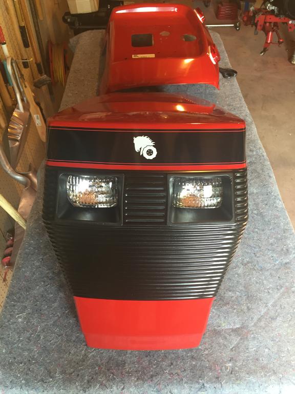

Mikey the Monkey 700 #14 Posted September 16, 2017 (edited) Love the 5 ribs! That is BA Edited September 16, 2017 by Mikey the Monkey 1 Share this post Link to post Share on other sites
cschannuth 3,817 #15 Posted September 16, 2017 3 minutes ago, Mikey the Monkey said: Love the 5 ribs! That is BA Thanks. I have the tri ribs on my 161 and I like these as much, if not more, than those. Share this post Link to post Share on other sites
doc724 925 #16 Posted September 20, 2017 I think your rattle can paint job is pretty darn good. I wish mine came out as nice. 1 1 Share this post Link to post Share on other sites
cschannuth 3,817 #17 Posted September 21, 2017 2 hours ago, doc724 said: I think your rattle can paint job is pretty darn good. I wish mine came out as nice. Thanks. You can't see all the imperfections in the pics but it looks decent and the metal is protected. Share this post Link to post Share on other sites
WHX?? 51,701 #18 Posted September 21, 2017 Just catching up here Craig but looks good from here..... absolutely boss... with those tires! Rattle can or not looks good when the mud flies! 1 Share this post Link to post Share on other sites
