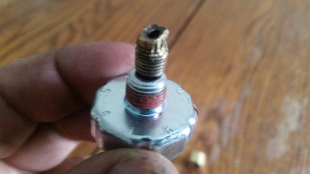

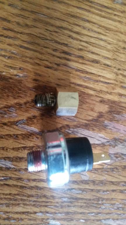

Lcarter114 4 #5 Posted September 16, 2017 Okay, got the switch and went to put or on and the adapter broke. I ran all over town looking for the adapter but can not find it. I didn't see it in the parts list umess it is something eles. Any ideas on the part number or type of adapter I need? Thanks Share this post Link to post Share on other sites

Lcarter114 4 #7 Posted September 16, 2017 The pressure switch threads are 1/4" I believe. I have attached pictures of the switch and adapter. Share this post Link to post Share on other sites

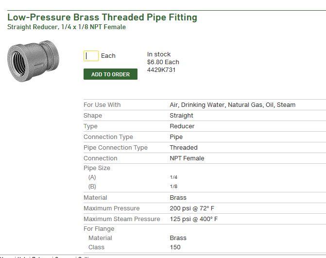

pfrederi 19,783 #8 Posted September 16, 2017 Still pipe thread get a reducer like this and 1/8" nipple and you are set. Any hardware store should have it. You might even find a 1/4 female 1/8 male making it a one piece solution. Share this post Link to post Share on other sites

Sarge 3,470 #10 Posted September 17, 2017 Good auto parts stores should have a large cabinet with a selection of brass fittings for brakes , oil and fuel . If it's an Edelman assortment - it should have the short 1/8"NPTx1/4"NPTF reducer as that one is specific . Otherwise , check with McMaster - I believe they keep them in stock . Some of the home centers also have extensive brass fittings , but good luck trying to hunt through them . Sarge 1 Share this post Link to post Share on other sites
Lcarter114 4 #11 Posted September 18, 2017 I ended up ordering the fitting from McMaster. Thanks for the info. Hopefully this is the lasthma problem I run into with this project. Thanks again. Share this post Link to post Share on other sites
