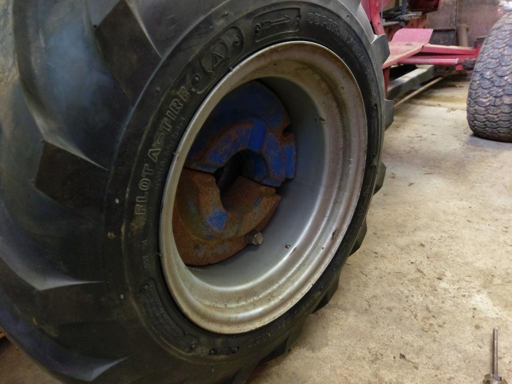

HamptonT 33 #1 Posted September 5, 2017 I found a set of Toro 266h rear wheels on CL. They are listed as tire size 23x10.5-12. Does anyone know of these are the same deep dish rims on a 520h? Share this post Link to post Share on other sites
WHX?? 53,079 #2 Posted September 5, 2017 Don't think so Hampton, I think they dish out the wrong way so might run into clearance problems. Others correct me if I am wrong. Share this post Link to post Share on other sites
WVHillbilly520H 10,376 #3 Posted September 5, 2017 No, the wheels for the 520H (bottom pic with blue wheel weights mounted) and xi series are the same ,but not the 26X series (top pic not much "dish") vertical shaft lawn tractor, Jeff. Share this post Link to post Share on other sites
HamptonT 33 #4 Posted September 5, 2017 Got it. Thanks! Share this post Link to post Share on other sites
WHX?? 53,079 #5 Posted September 5, 2017 Your welcome Forgot to add if the tires are in good shape will fit fine on 520 rims tho Share this post Link to post Share on other sites
grinchsr 650 #6 Posted September 5, 2017 If you also have a 8-speed tractor that needs tires the wheel will work. I have a set on a 416-8 Share this post Link to post Share on other sites
