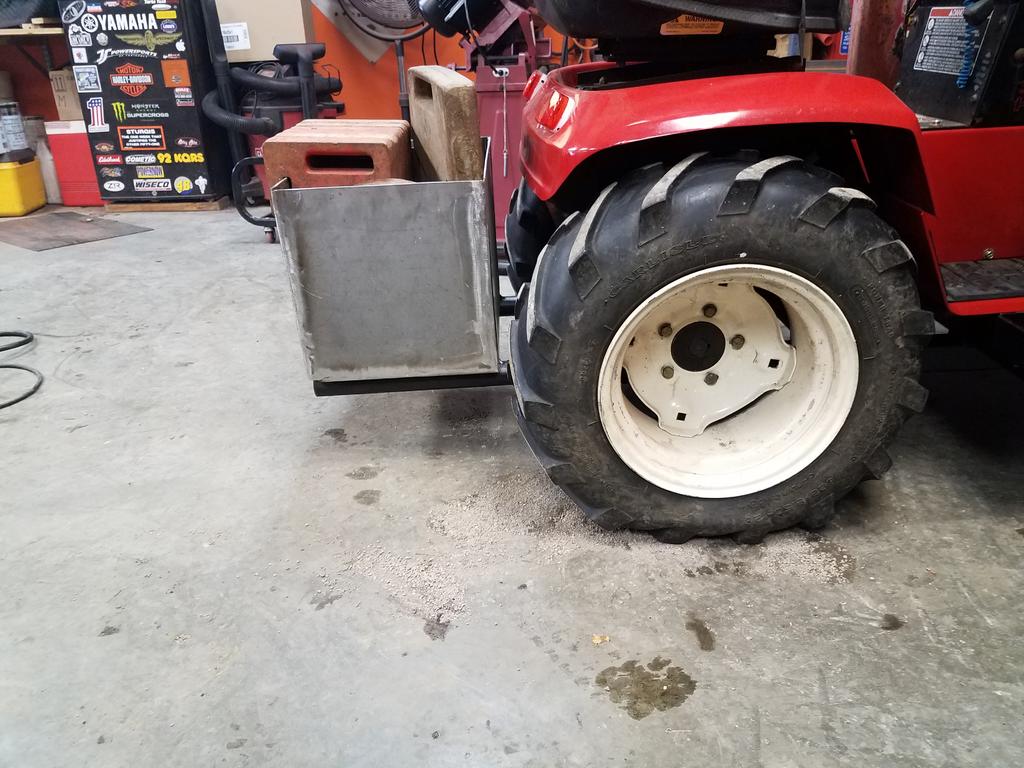

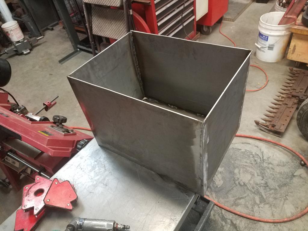

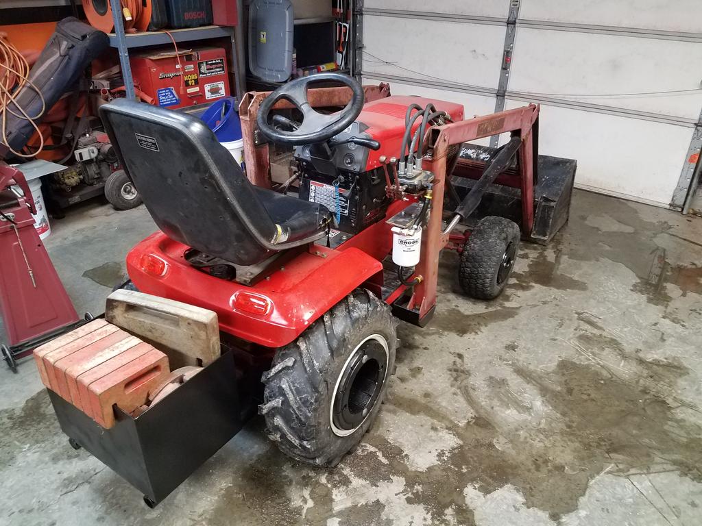

Shynon 7,728 #26 Posted December 22, 2017 Started my Christmas vacation got the box built for the weight box , should finish that tommorrow 4 1 Share this post Link to post Share on other sites

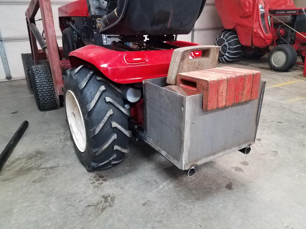

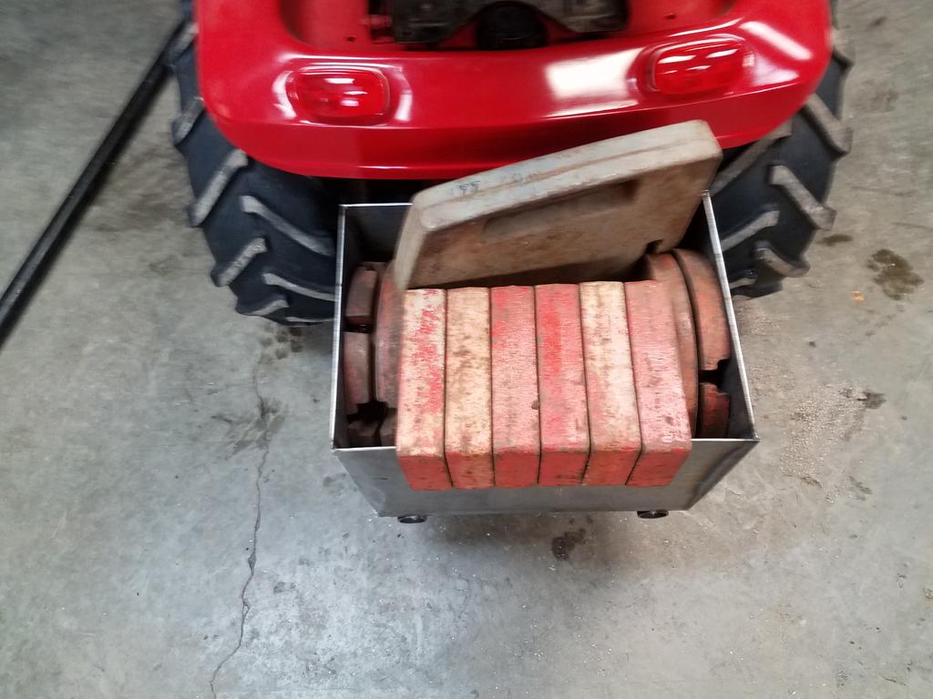

Shynon 7,728 #27 Posted December 22, 2017 Welded box to the tubes that slide inside the frame. Filled with some random weights i had. All total about 300+ pounds next paint up a set of wheel horse front and rear wheel weights. 1 4 Share this post Link to post Share on other sites

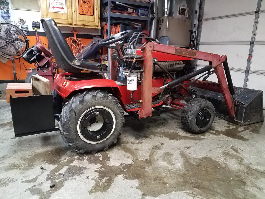

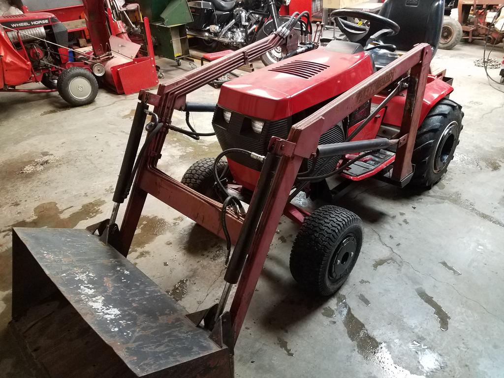

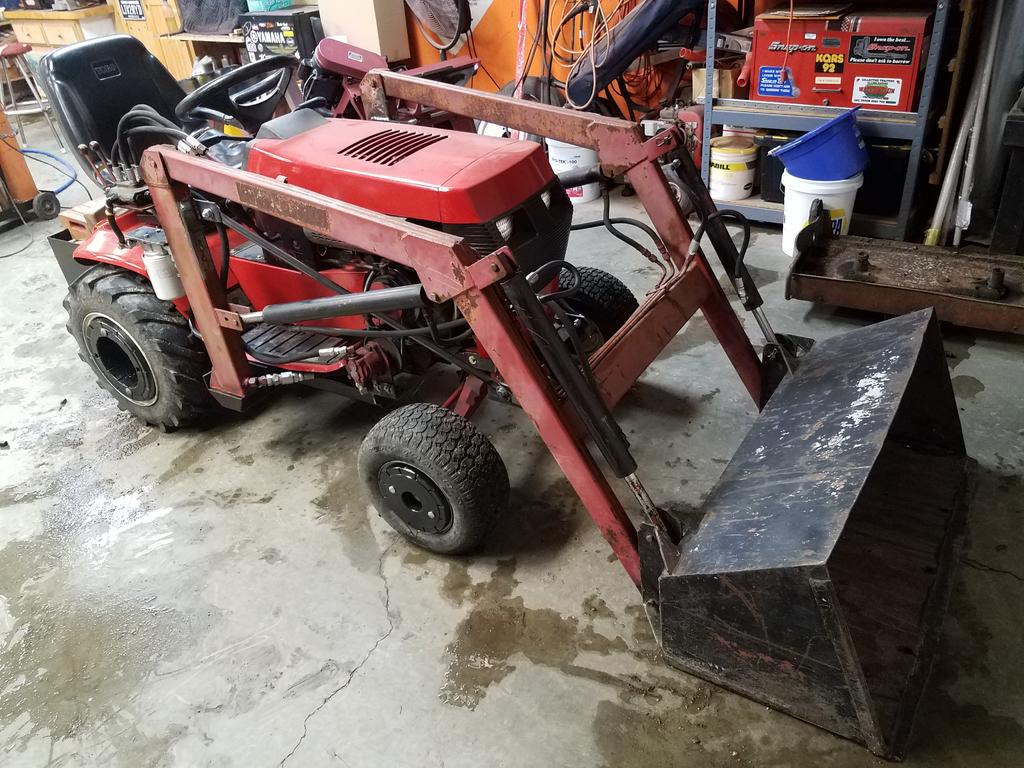

Shynon 7,728 #28 Posted December 22, 2017 Painted the weight box and wheel weights. Added a hydraulic filter. I think I'm done for now. Gotta figure out some decals for this beast. 5 Share this post Link to post Share on other sites
AMC RULES 37,260 #29 Posted December 23, 2017 Would be interesting to know the total weight sitting there. Share this post Link to post Share on other sites
Shynon 7,728 #30 Posted December 23, 2017 9 minutes ago, AMC RULES said: Would be interesting to know the total weight sitting there. Tractor weights about 650, loader as to be about 200-250, wheel weights 170, and 300+ in the box. So about 1400 lbs give or take 1 Share this post Link to post Share on other sites
WHX?? 58,330 #31 Posted December 23, 2017 Tires loaded? Share this post Link to post Share on other sites
Shynon 7,728 #32 Posted December 23, 2017 1 minute ago, WHX12 said: Tires loaded? no Share this post Link to post Share on other sites
12 hp Kohler 1,020 #33 Posted December 23, 2017 Looking great, have you gotten to use it since you put the weight box on ? Share this post Link to post Share on other sites
Shynon 7,728 #34 Posted December 23, 2017 Just now, 12 hp Kohler said: Looking great, have you gotten to use it since you put the weight box on ? Haven't really, maybe try to find something tomorrow. 2 Share this post Link to post Share on other sites
WHX?? 58,330 #35 Posted December 24, 2017 On 12/22/2017 at 7:29 PM, Shynon said: maybe try to find something tomorrow Good luck with that Tom we got no snow at all here to speak of but ground is froze. Be nice to see how it performs with a load. Share this post Link to post Share on other sites
Shynon 7,728 #36 Posted December 24, 2017 1 minute ago, WHX12 said: no snow at all here to speak of but ground is froze yes and the temp is dropping, need to hunker down in the shop next week. Share this post Link to post Share on other sites

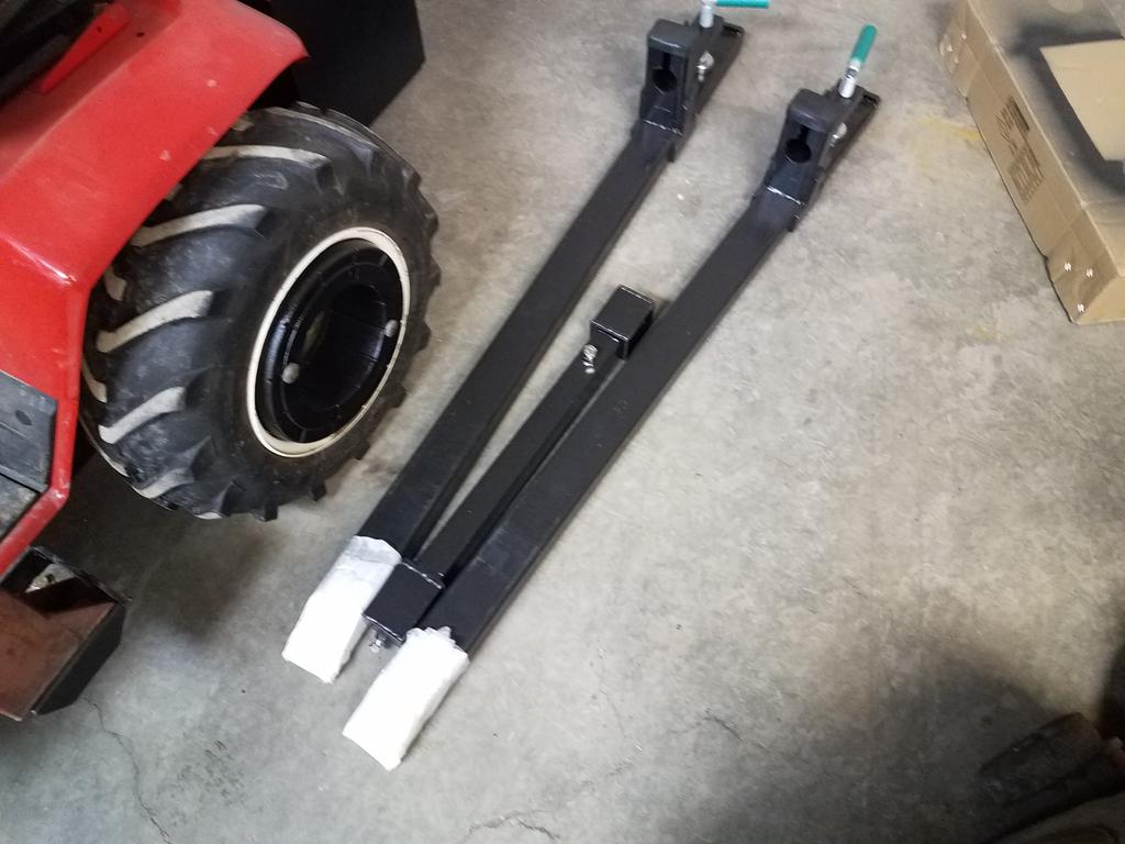

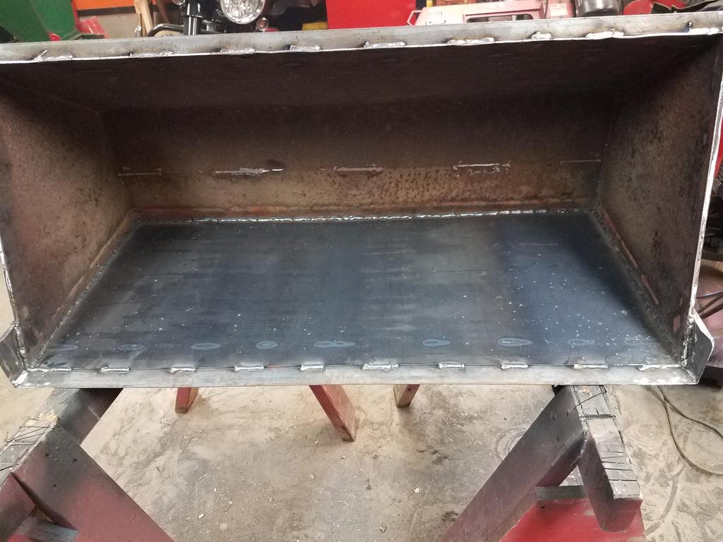

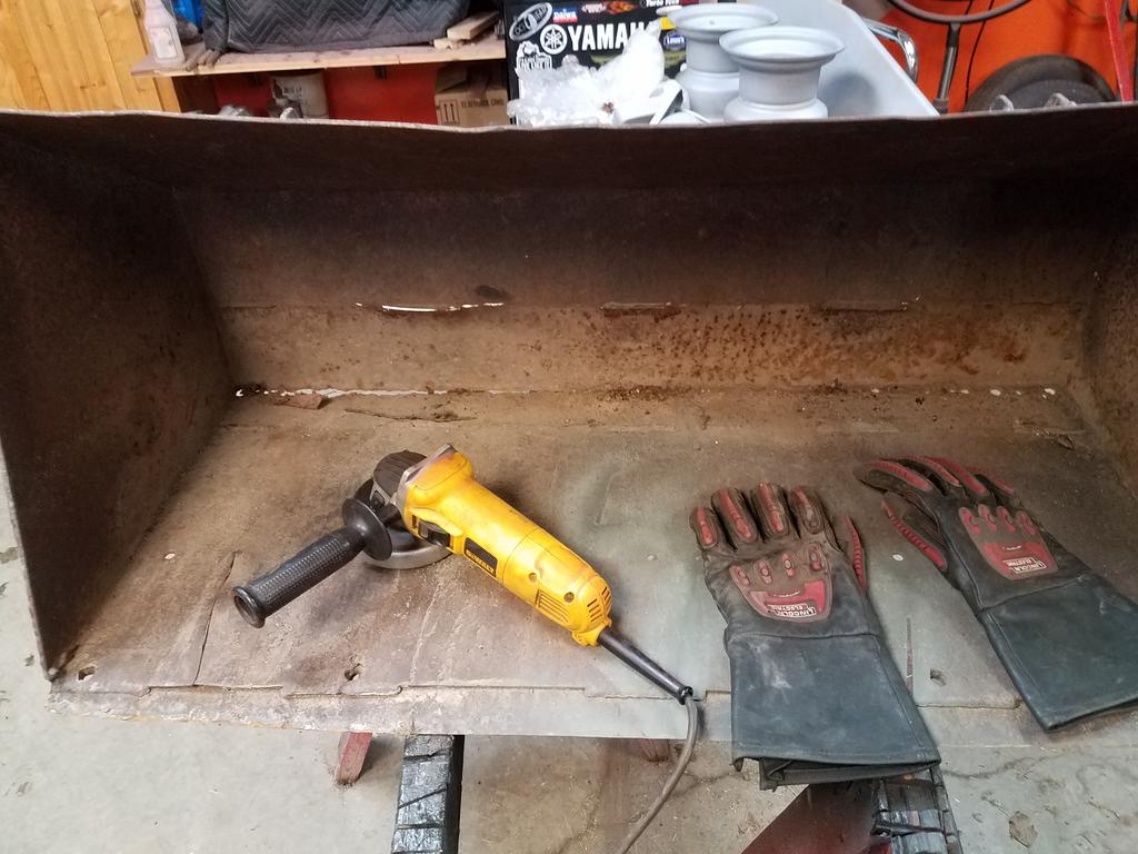

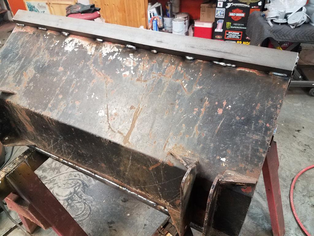

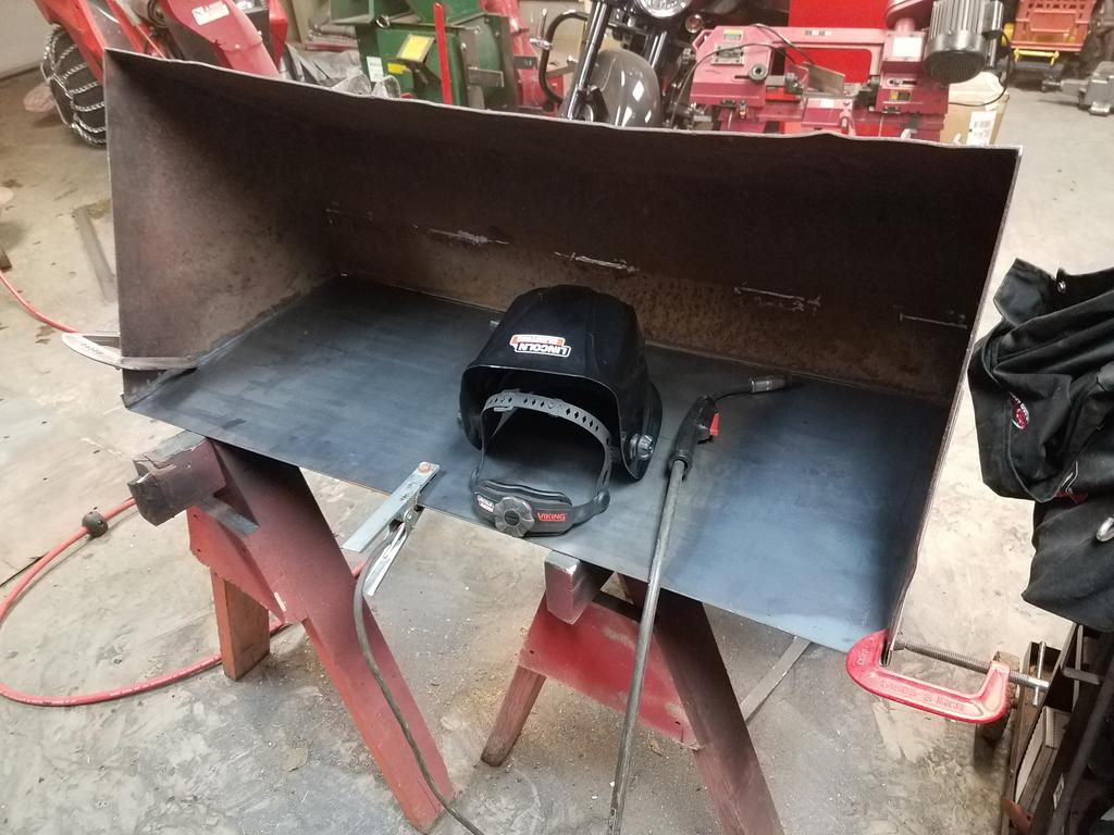

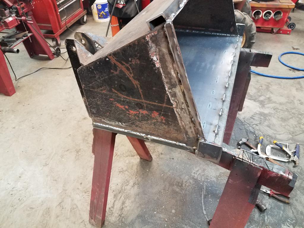

Shynon 7,728 #38 Posted December 29, 2017 Well I guess I wasn't done, decide to patch the rust holes in the bottom. Had my fab guy bend a new bottom also got a new cutting edge. Bought a set of slip on forks from 3 Share this post Link to post Share on other sites
