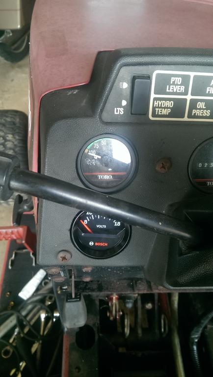

MalMac 1,333 #1 Posted September 2, 2017 Has anybody tried to replace the volt gauge by just easily persuading the plastic dash to bend enough to sneak the old gauge out and a new one in? I did that on a hour meter on a different tractor years ago but the volt gauge maybe a different story all together. If disassembly of the dash is required I don't believe I am up for that. It's just more than I want to bite off right now. So how about it, anybody tried the cheating method with any success. Share this post Link to post Share on other sites
roadapples 6,984 #2 Posted September 2, 2017 My 94 doesn't seem to bad from the back with the battery removed... Share this post Link to post Share on other sites
1995 520H+96+97 937 #3 Posted September 2, 2017 I did not cheat when changing mine. Share this post Link to post Share on other sites
WVHillbilly520H 10,376 #4 Posted September 2, 2017 Yes , I did just loosen up the plastic dash cover on a warm day in the sun to change out the volt meter on the '95 I bought last spring also cheaped out with a $20 replacement from Advance Auto, Jeff. Share this post Link to post Share on other sites
MalMac 1,333 #5 Posted September 2, 2017 I sorta did the same thing when I changed out the hour meter. I used a heat lamp and warmed up plastic dash very carefully. 1 Share this post Link to post Share on other sites
