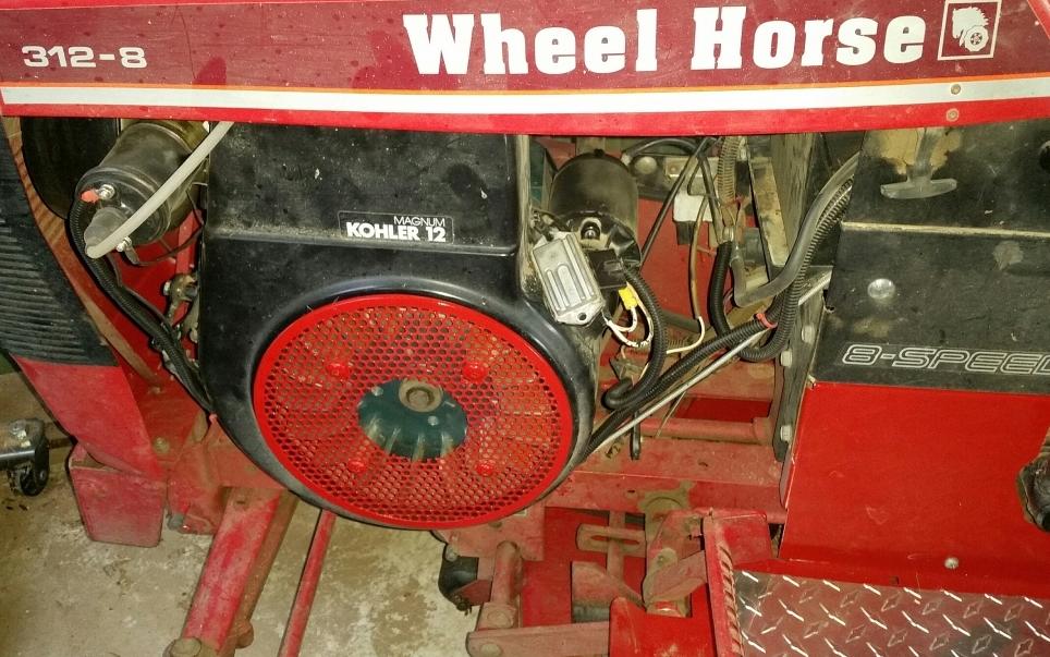

Texas Todd 1,025 #2 Posted August 31, 2017 I've used aluminum diamond plate as well as black abrasive and self adhesive stair tread material. Kind of like skateboard tape. Got both at Home Improvement store. 2 Share this post Link to post Share on other sites
