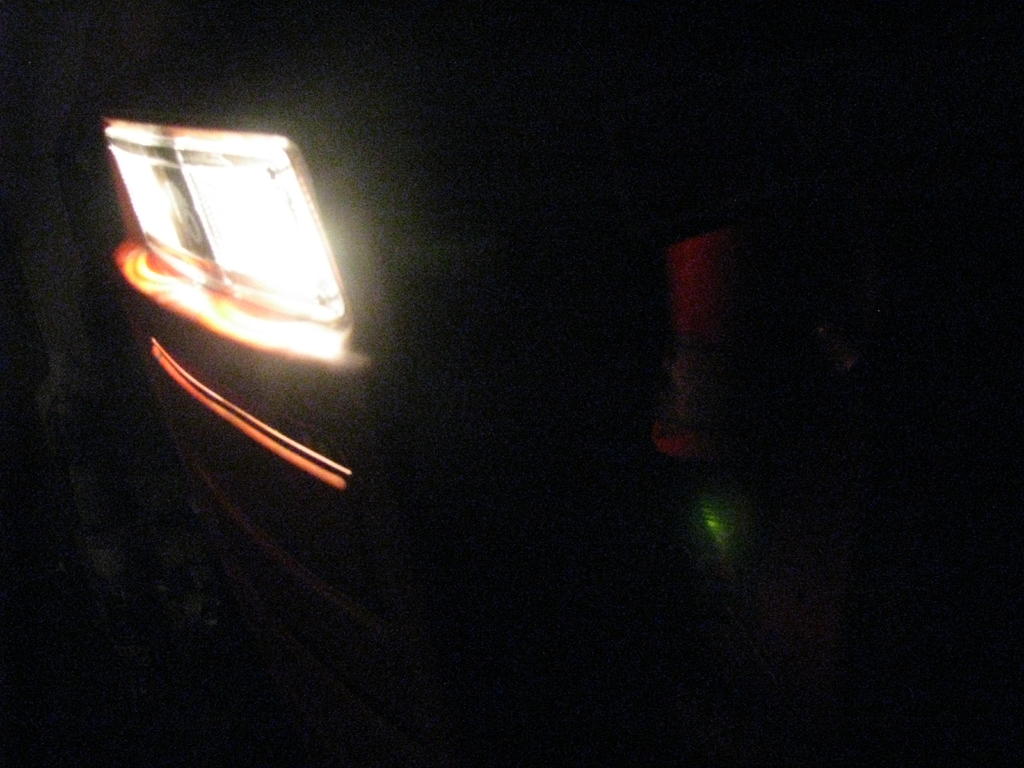

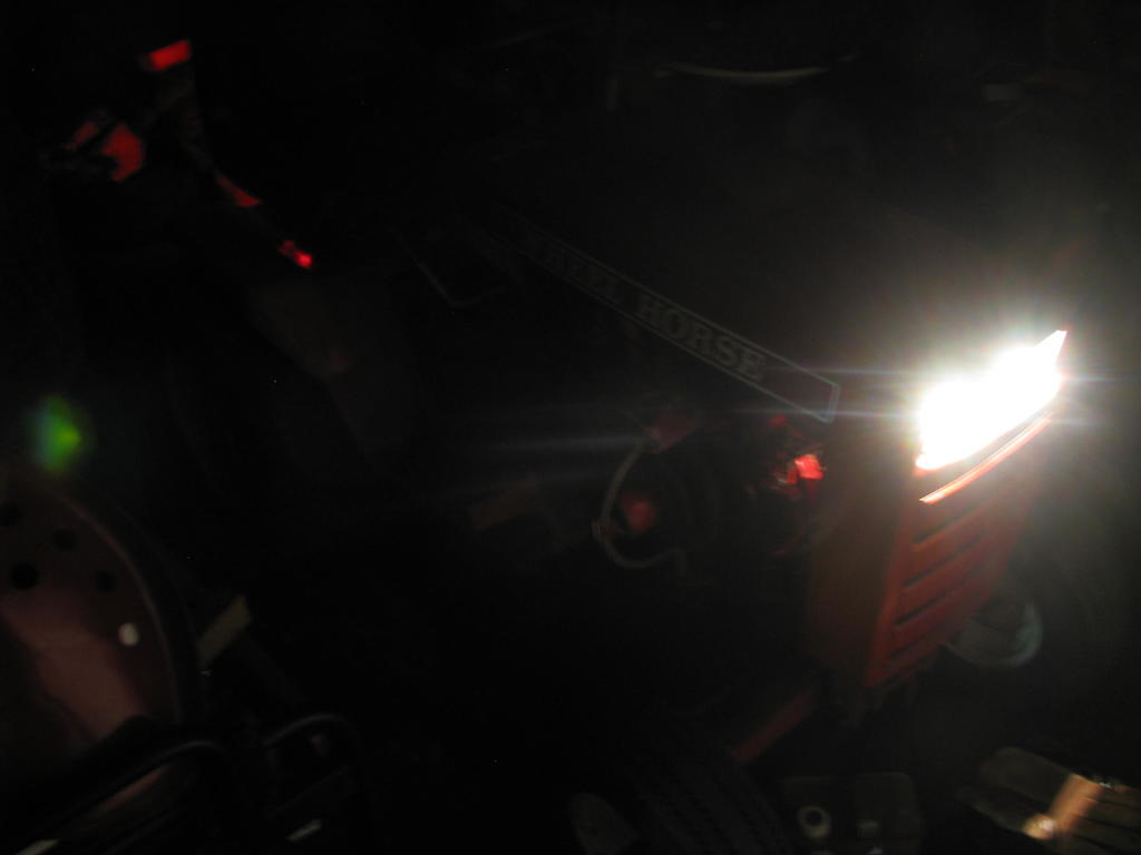

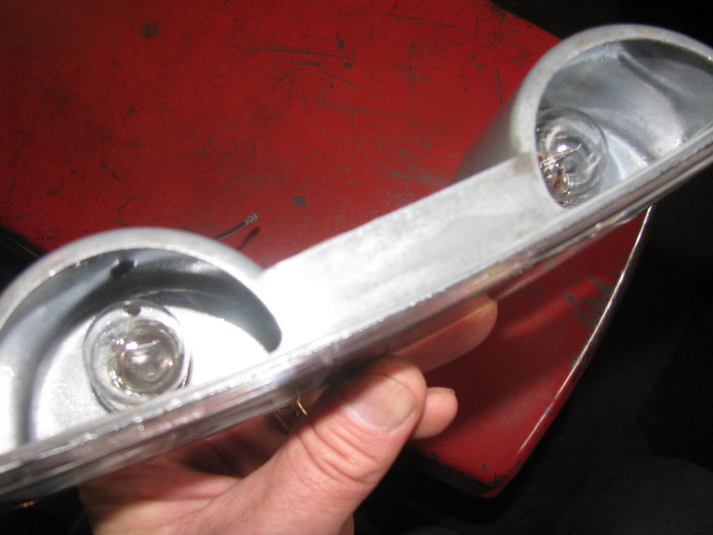

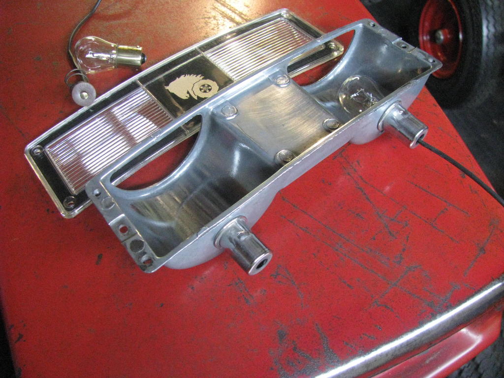

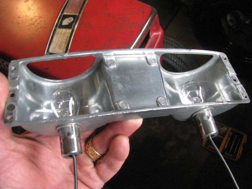

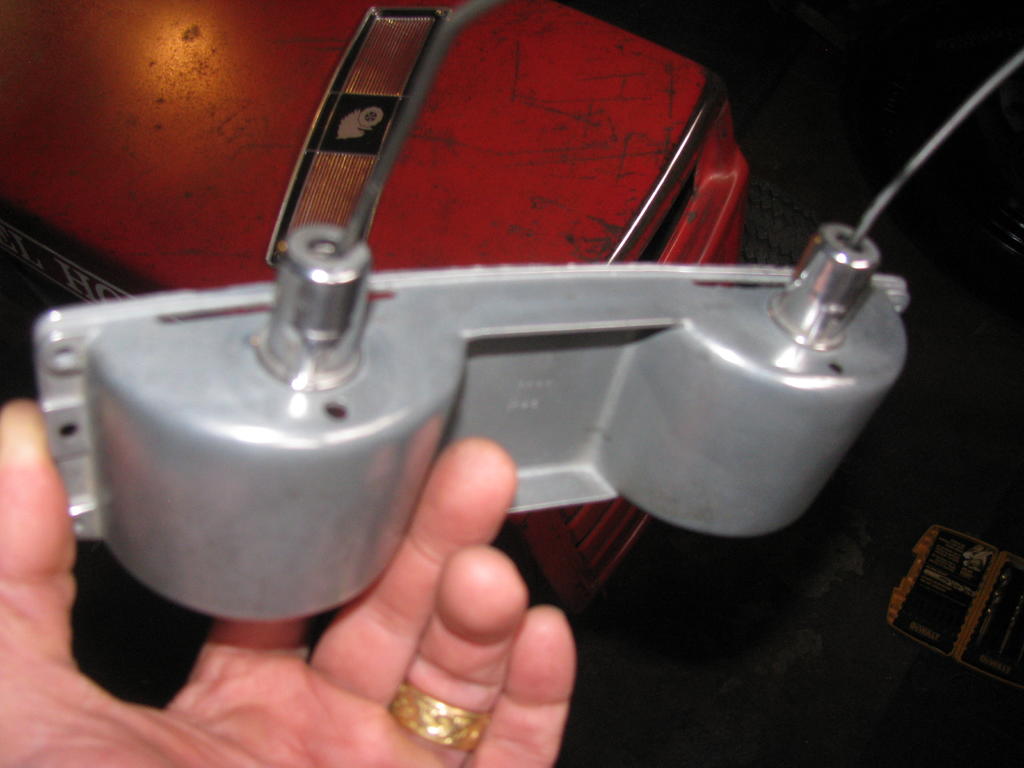

AMC RULES 37,192 #7 Posted August 28, 2017 If you take the time to replace your lens, & detail that light bucket... I think, you'd be surprised how bright them old 1156's really are. 3 Share this post Link to post Share on other sites
shunter 20 #8 Posted August 28, 2017 Nice work there, i'll give it a shot, what did you use on the lens? 2 Share this post Link to post Share on other sites
AMC RULES 37,192 #9 Posted August 28, 2017 New lens... & a liberal application this on the bucket, sockets, springs, contacts. 1 Share this post Link to post Share on other sites
Sarge 3,464 #10 Posted August 30, 2017 There are some pretty high powered led conversion bulbs that will fit the 1156 socket base - they aren't cheap but will provide about a 200% boost in output at a lower draw rate . Not sure how long they will last as the chips need to dissipate the heat - might need some vent holes in the housing . I had a set in an old car - they were a bit overkill but at least you could see backing up at night . Sarge 1 Share this post Link to post Share on other sites
