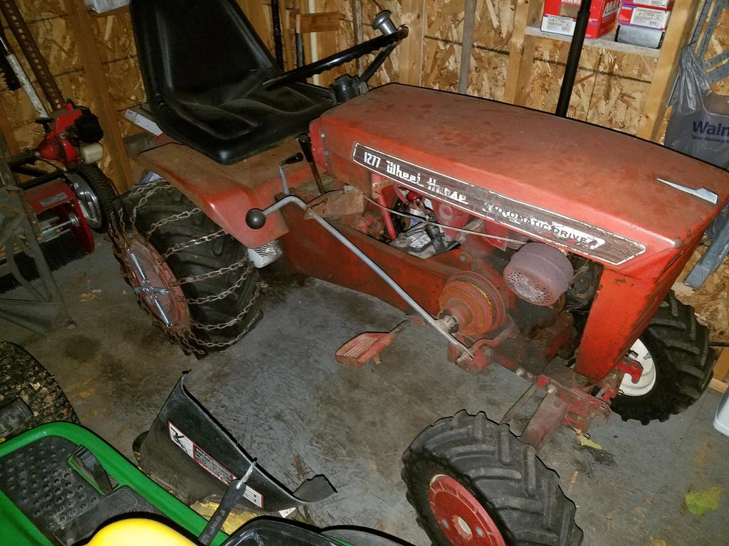

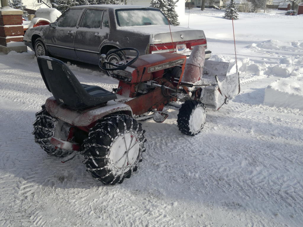

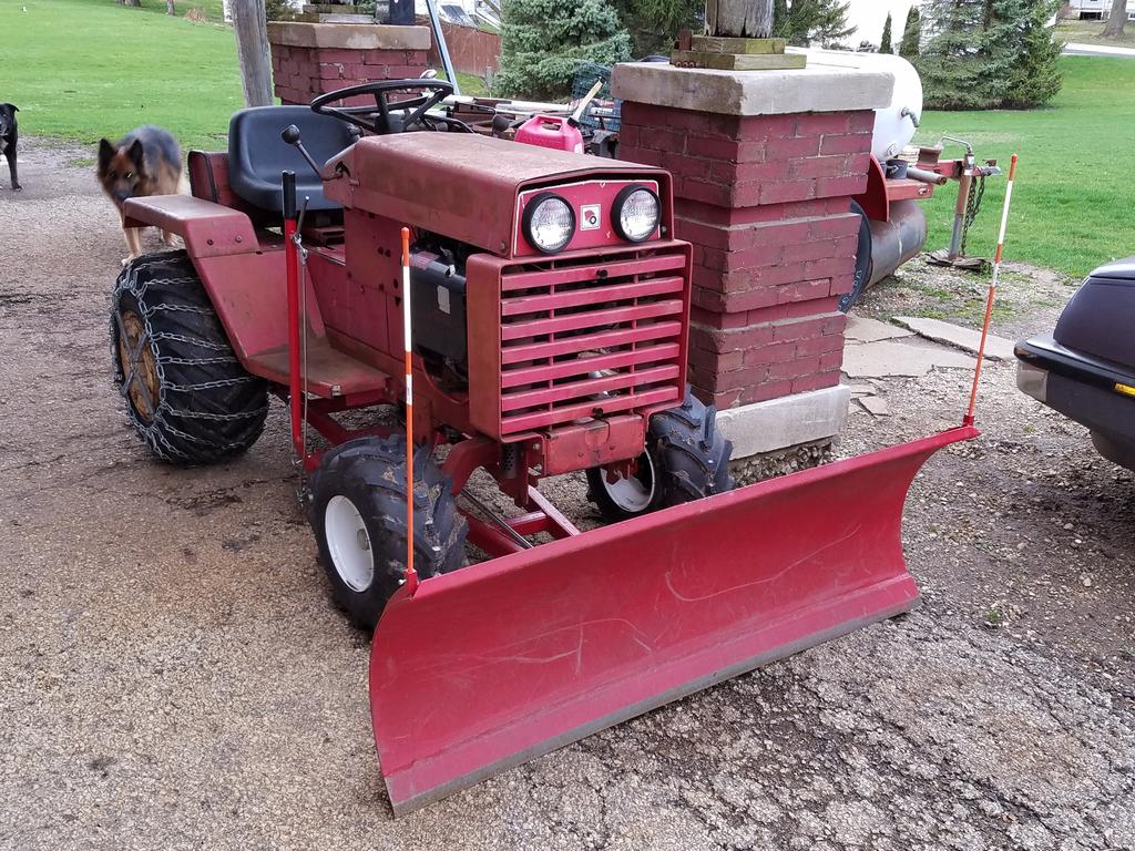

Sarge 3,470 #4 Posted August 25, 2017 I have a very steep ditch and some areas that collect water all year - run ags with chains on them year 'round and never tear up the yard . I've had more problems trying to weight down turf tires enough to stop them from spinning on high angle hill climbs so I went this route - never take the chains off and all mine and run weights and a few also run fluid-filled tires . Never spin a wheel and they never tear up the grass . Unless you turn super sharp at high speed it should not be a problem . Only tracks I've ever made were in 4" of standing water - it brought up some mud but the next mowing took care of that ... Not sure where or why this thing about ags or chains will tear up a lawn . Ok , maybe on a golf course green or something like that but a typical lawn I have yet to damage the turf in any way - some of mine have rear wheels that weigh over 150lbs between fluid/weights/chains - no problem yet . The little JD LA series mower I inherited does more damage with it's turf tires and light weight tractor design than any of the Horses - it spins the wheels too easily and leaves ripped marks up any steep hill , every time trying to find traction .... So , it's had heavy plates bolted to the rear to help with that , but it still spins too easily . Sarge 1 1 Share this post Link to post Share on other sites

Sarge 3,470 #10 Posted August 26, 2017 They sit fine on top of the bars and bite like mad . In gravel , the harder the tractor pulls the harder they dig for traction and will leave some marks . Be very careful on seal coated asphalt - the chains will tear it up . Sarge 2 1 Share this post Link to post Share on other sites
