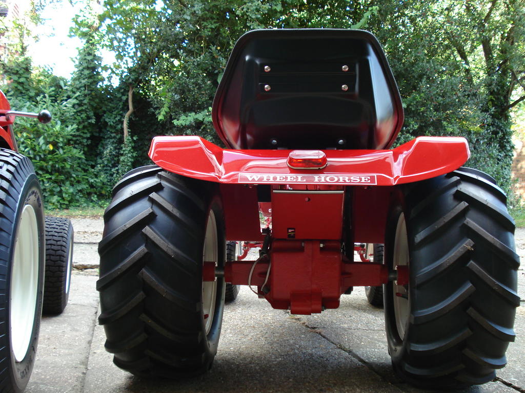

Anglo Traction 761 #3 Posted August 24, 2017 I used Duro and shoe-horned 10.5" 4ply HF255 TLs onto 7" wide rims (tubeless). Reduces outer diameter slightly, but no issues with clearance on a 74 C-120- As you're in the UK, here is an example retailer of this Brand (other available) and gives you an idea of the costs. TYRES 1 Share this post Link to post Share on other sites

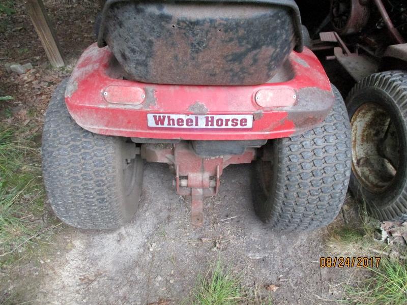

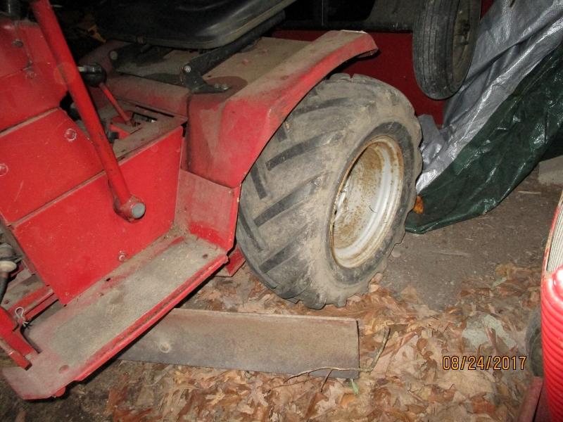

N3PUY 1,031 #4 Posted August 24, 2017 My 310-8 has 10.50 turfs and that tractor goes anywhere! The 312-8 has ags and they slip on packed ground and pavement but work fine in deep loose dirt. 1 Share this post Link to post Share on other sites
