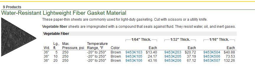

Duramax7man7 506 #15 Posted October 20, 2017 What is the best material for making exhaust gaskets and where can I pick some of this up... Share this post Link to post Share on other sites
pacer 3,177 #16 Posted October 20, 2017 I havent tried making an exhaust gasket because of the material needed -- so far, with a little digging I have been able to get 'sto-bought' gaskets and so have never looked into a material that could be used in high heat situations. 1 Share this post Link to post Share on other sites
Duramax7man7 506 #17 Posted October 21, 2017 (edited) Okay so this stuff should be good to use for exhaust gaskets... Amazing how much you can save with DIY. Buying premade gaskets from anyone is normally ridiculous. You pay 50% of the price of a sheet for one gasket and you can make 40-50 out of this one sheet. It's Fel-Pro 3009 12"x 28.5" x .0469 (3/64th)... sold at Pepboys. Edited October 21, 2017 by Mastiffman 1 Share this post Link to post Share on other sites
Sarge 3,470 #18 Posted October 21, 2017 Be prepared for a fight - that stuff does not cut easily nor cleanly . I recommend using a jig saw with a very fine blade and take your time - I've had to make a few over the years and it was a real pita at best . The equipment used to stamp those must be some very high strength steel cutters and I doubt they last very long . Sarge 1 Share this post Link to post Share on other sites
oliver2-44 11,062 #19 Posted October 21, 2017 Harbor Freight sells a 6pc hole punch set for $ 6. And a larger set for $12. For the hobbies the the 6pc set is great.for the majority of gaskets Share this post Link to post Share on other sites
Duramax7man7 506 #20 Posted October 21, 2017 I just traced the old gasket on to it with a sharpie. Then I cut a square around it out of the large sheet using tin snips. Then just cut nice and clean around the outside. I used a couple of old sockets for banging out the holes and then used a sanding drum on a drill for the large center hole. Worked perfect. I will look into those punches though. Thanks! Share this post Link to post Share on other sites
Sarge 3,470 #21 Posted October 22, 2017 I've tried those hole punches from HF - they are pretty soft steel and will dull easily . You could heat treat them a bit by heating until dark orange and water quench them - then re-sharpen . The sanding drum is a great idea to get better control to make the final sizing of the center hole . I usually run the jig saw in the vise , upside-down with the trigger locked and a very fine scroll blade - works good but they do need some sanding to clean up the cut areas . The heavier automotive engine header material is the worst to work with - the stuff is pretty thick and will dull almost anything you try to cut it with . Where did you find the Fel-Ramic 3009 material ? None of the local suppliers around here will stock or even order it , some claimed it was NLA....? Sarge Share this post Link to post Share on other sites
Duramax7man7 506 #22 Posted October 23, 2017 Good tips fellas. I did grab that HF punch kit today and maybe I will heat treat it first. Quench in water or oil? or oil and fire? (Conan) Yeah the drum sander on a drill with high speed was awesome it worked perfect and was a nice and clean fit. Might even be able to take an old drill bit and fit a piece of sand paper to that with some tape at the top and bottom and use that for the small holes if needed. I didn't but that is an idea off the top of my head that I'm sure wold work. I called around and found it at Pepboys, of all places. it was $8! I could make 40-50 of these exhaust gaskets with it. It's like 12" by 28..5"... They had it so if you like/prefer it, find it snag as much as you can. But you can get it online for sure too with a bit of a google. Share this post Link to post Share on other sites
Steve_O 25 #23 Posted October 23, 2017 http://www.rockauto.com/en/parts/fel-pro,3009,gasket+material,271 1 Share this post Link to post Share on other sites
Sarge 3,470 #24 Posted October 23, 2017 I did a search on it again , the problem is no one around here wants to stock it - like everything else . I will get a couple sheets ordered as I work on a lot of old stuff that should be left for dead honestly - but I do like that material and it never seems to burn out like some of the others . One of my favorite tools for doing very small work is a Dremel , but for anything that requires some power I use an old Ryobi that I swear has twice the guts of any Dremel ever made - especially on carbide bits . They do make a few different sizes of sanding drums for those as well as various stones that would work to clean up bolt holes - I've used that in the past when making gaskets from the much heavier Fel-Pro material for headers . Had to do some refitting on a Remflex gasket for the old Land Cruiser and it's custom tri-y header - that thing was a real pain to install and get it to seal properly . Water quench will give you a quickly hardened surface , but be careful how far you heat that steel . Do some research on YouTube first - it will help you understand how far to go on color and it's a good idea to practice on some scrap first that's the same thickness . There are hardening powders out there like Cherry Red , but it's expensive and can have odd results if the steel wasn't mixed right to start with , as much of the Chinese stuff can be unpredictable . Sarge 1 Share this post Link to post Share on other sites
