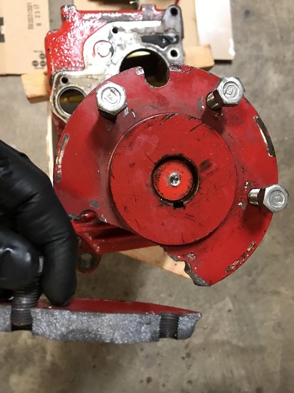

KC9KAS 4,744 #4 Posted August 23, 2017 1 hour ago, briankd said: have 2- 3/8 bolts going thru the 2 of five lug bolt holes. that is all that the puller will line up with hole wise You better stop now before you break a hub. You need equal pressure around the hub (all 5 lug bolt holes) like this: 5 2 Share this post Link to post Share on other sites

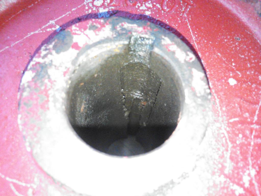

lynnmor 8,034 #6 Posted August 24, 2017 Remove the set screw(s) and look in at the key. If the groove inside the hub wore so that the key is no longer in line with the keyway, you will not be able to pull it off. If you can rotate it with a hammer, that may be the problem, so then tap it to align it and try pulling again. 2 Share this post Link to post Share on other sites
pacer 3,177 #7 Posted August 24, 2017 Oh Boy!!! those da** hubs!! they and steering wheels are the bane of us horse lovers! I got disgusted and got on the mill and lathe and with a piece of 5/8" metal plate and a 3/4" bolt I made a puller to match the 5 holes --- even then with my big 3/4" impact driver with 130psi hammering it took some 10-12 min just creeping off. So, like the fellas said get a much better puller, that cast iron is somewhat brittle and it WILL break. 2 Share this post Link to post Share on other sites

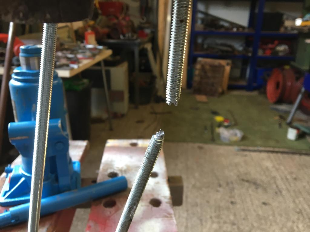

meadowfield 2,808 #14 Posted August 27, 2017 On 25/08/2017 at 10:02 AM, KC9KAS said: @meadowfield It looks like you only have 3 pieces of threaded rod between the hubs...Is that correct? Only got the pic. I have to put them in pieces to fit the bottle jack in. But can only fit 4, those rods are under serious tension and snap at around 5 tons!! 1 Share this post Link to post Share on other sites
meadowfield 2,808 #15 Posted August 29, 2017 just in case you wondered why I knew they snapped... 1 1 Share this post Link to post Share on other sites

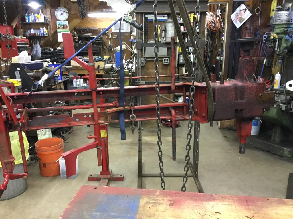

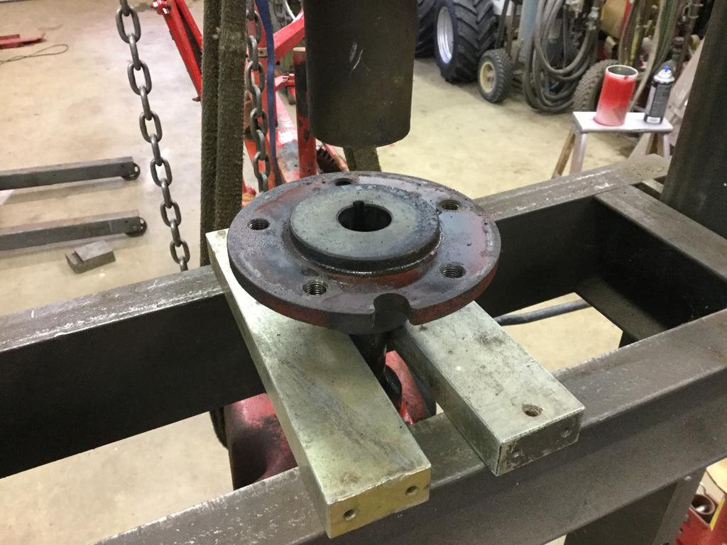

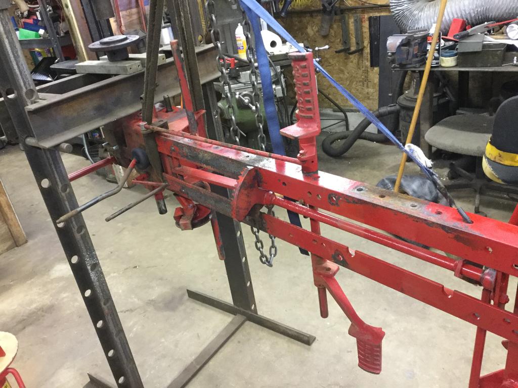

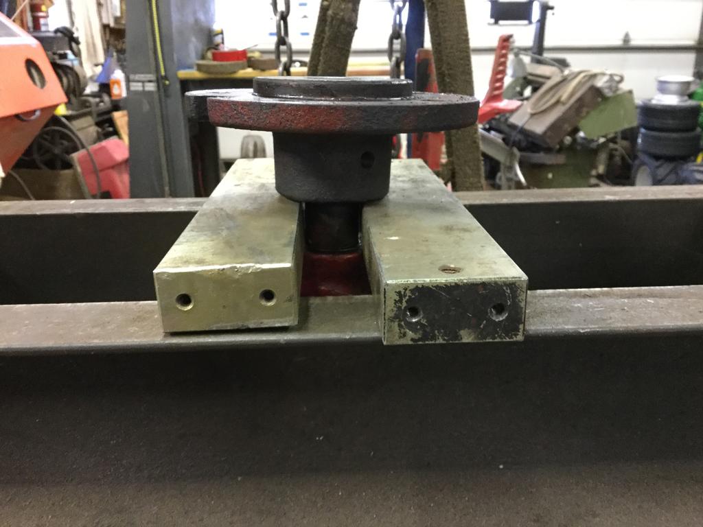

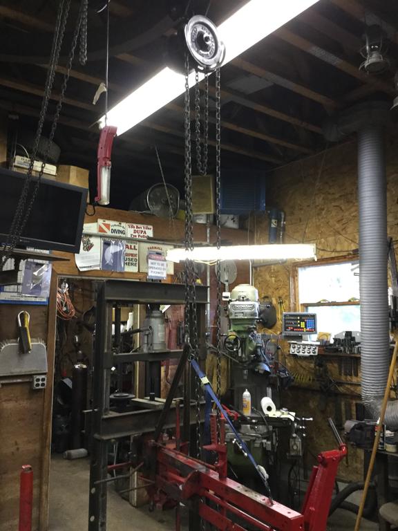

Dennis Gintowt 33 #18 Posted September 26, 2017 (edited) I tried this works great. Edited September 26, 2017 by Dennis Gintowt 1 3 Share this post Link to post Share on other sites

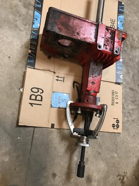

sfjohnson722 26 #19 Posted October 25, 2017 That is an ingenious contraption @Dennis Gintowt!!! The bar has now been raised significantly! I just found this post today after snapping a hub last night with a 2-ton gear puller driven with a 20v Dewalt impact. Don't try it this way: 2 1 Share this post Link to post Share on other sites
Petes Horse 20 #20 Posted October 26, 2017 If you use a puller this worked for me. tighten the puller 20/30lbs, heat the hub, pull and hold the axle out even if its only an 1/8", then hit the screw in part of the puller good and hard. the shock load will move the axle a tiny bit. The shock is what gets it done. As it moves the sound of the hit will go from high pitch to a thud. rinse and repeat. Also grind the point off the puller. it may swell the end of the axle. What Iynnmor said it very true. Mine were really wallowed out. Hope this helps. good luck. Share this post Link to post Share on other sites
