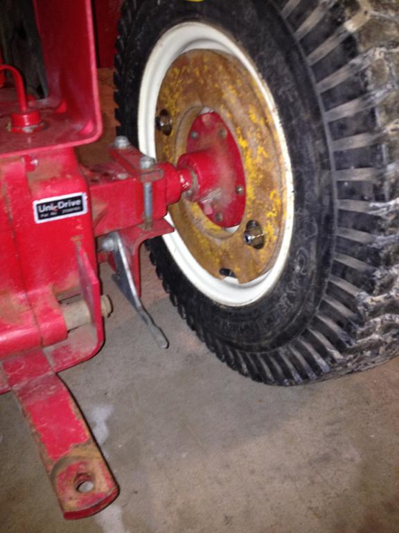

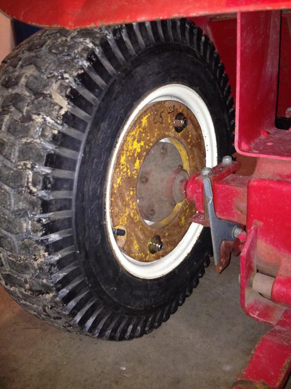

TDF5G 2,073 #7 Posted August 23, 2017 I've looked through the files to find the instruction and parts manual for the rear attach-a-matic hitch and I cannot find it. I have an original instruction sheet and it does show the spacers for the smaller axles, I remember. I'm at work, don't have it here, but I found a couple of pics of my B-100 that you can see the spacers mounted. Basically a flat piece of metal bent in an L shape to take up the space of the small axle housing painted red. 1 1 Share this post Link to post Share on other sites
Rob XC700 75 #8 Posted August 23, 2017 47 minutes ago, TDF5G said: I've looked through the files to find the instruction and parts manual for the rear attach-a-matic hitch and I cannot find it. I have an original instruction sheet and it does show the spacers for the smaller axles, I remember. I'm at work, don't have it here, but I found a couple of pics of my B-100 that you can see the spacers mounted. Basically a flat piece of metal bent in an L shape to take up the space of the small axle housing painted red. That's a great pic! Thanks, that confirms it for all what it is. Since it's not required on the hydro's, they most likely have been discarded over the years. It doesn't seem like much, but if the bracket isn't installed square, it could make a difference over the distance of the entire plow "frame". I'm going to check mine tonight. I just bolted it up on the weekend. Didn't notice this detail/part until I was looking at the instructions for the adjustment lever. 1 Share this post Link to post Share on other sites
