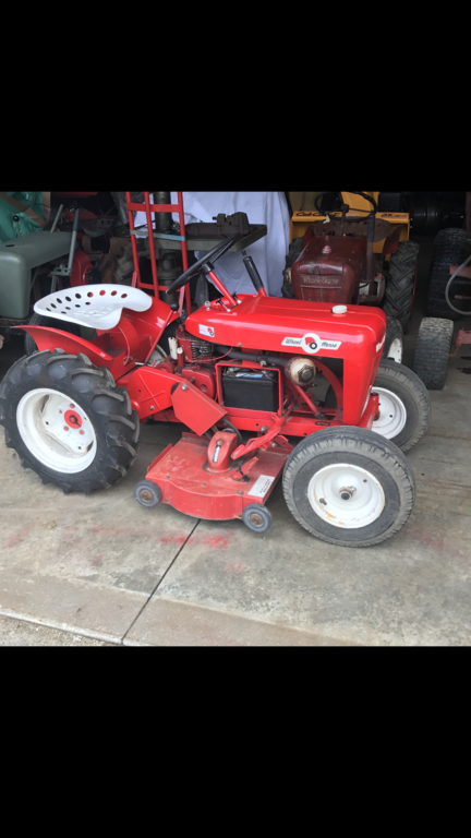

Aldon 4,828 #4 Posted August 12, 2017 I think this photo shows a 551/suburban belt guard...correct? I am out of town tomorrow but the next dry day I'll pull the belt guard and take detailed photos for you. Should be Monday or Tuesday unless someone posts help sooner. Share this post Link to post Share on other sites
