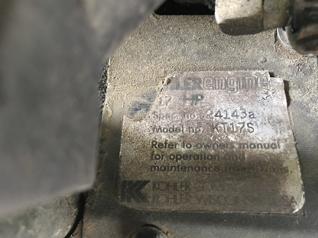

19richie66 17,765 #5 Posted August 9, 2017 Here is the engine number 3 Share this post Link to post Share on other sites
