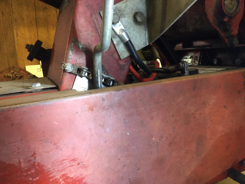

ACman 7,673 #1 Posted August 9, 2017 (edited) The cuz and I picked up a 1276 that belonged to a 98 year old man . He had a bunch of the original paperwork with the tractor that was in a old GM bus division folder . We believe he was a engineer at GM especially after looking at some of the little mods done to the tractor . Maybe some have seen this little trick but this is stupid easy . All it is apiece of bicycle chain used as detents for the lever and it works like a charm . Hope this helps some of you with that creeper problem... ! Edited August 9, 2017 by ACman 16 1 Share this post Link to post Share on other sites

Sarge 3,470 #7 Posted August 9, 2017 I let the 1277 pretty much flop around - use the brake/clutch pedal to regulate ground speed and free up one hand for a Smithwick's and running the blade when needed ...lol . Sarge 1 Share this post Link to post Share on other sites
