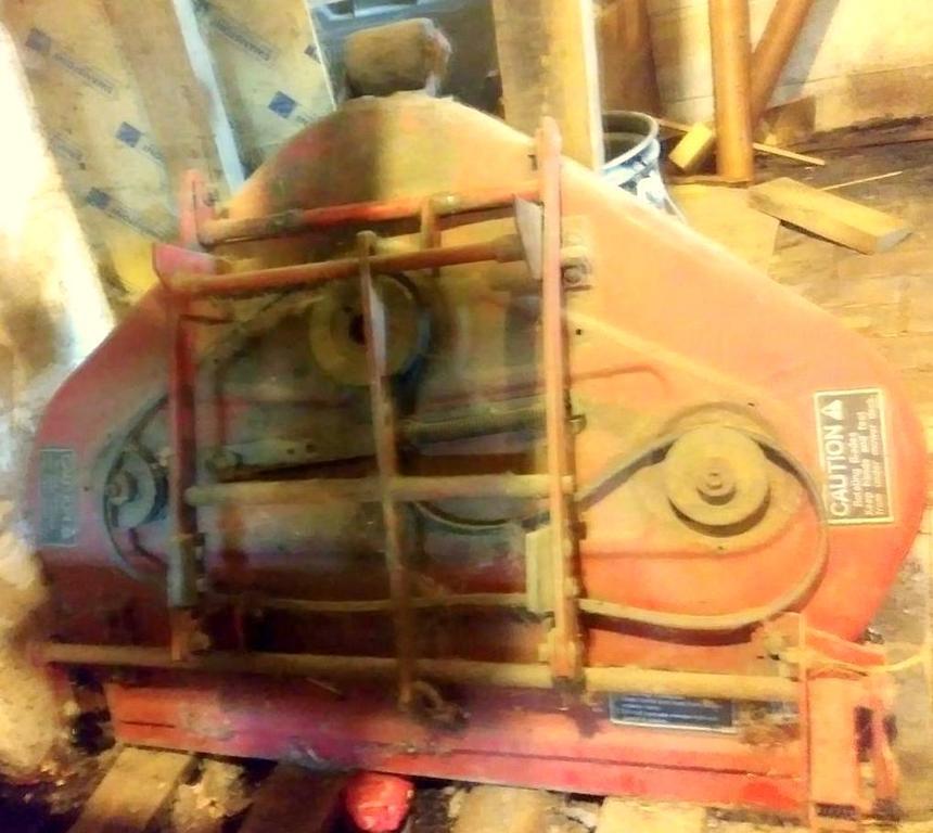

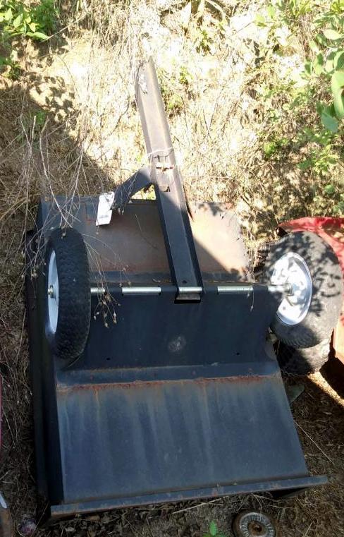

SCAVENGERGIRL 10 #26 Posted August 10, 2017 I didn't go to see it but I did ask for a few photos. Evidently is was rebuilt 4 years ago & used to mow grass but hasn't been run in about 2 years. He said he did start it over the winter with starting fluid. I'm reluctant to pass it up primarily due to the attachments, it's almost everything I think I want at a price I can afford. I'd guess it's still available (and maybe even for sale) for all the reasons listed above. I thought this would be a good starter for me, help me understand what I'm dealing with when it comes to a little tractor and figure out what I really do want for when I have a little more expendable income (this new property is a serious fixer upper!) I suspect I will end up doing more hauling than anything. I had a tree fall across my lane this weekend and I really wish I had something to haul the pieces away with! I've been looking for a few months and this has been the best deal I've seen, & I hear a Wheel Horse is a true work horse so I was thinking it could be a sound investment. Share this post Link to post Share on other sites
