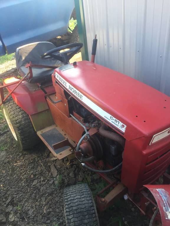

SCAVENGERGIRL 10 #1 Posted August 8, 2017 I'm in the market for a small tractor but I know nothing about them, so, I'm here for advice. Any helpful input would be greatly appreciated. Thanks in advance! I have virtually no yard, so the mower deck is a not important to me. What I primarily want it for is hauling heavy stuff and snow blowing a 1/4 mile lane. I would also like to be able to push dirt around with it. A bucket loader would be awesome, however, I don't think I can afford it. Of course I have a budget, trying to stay under $500, but that seems impossible to do with a snow blower included. I spotted this on Craigslist am trying to determine if it's worthwhile. The price it's listed for is $850 but said he could do $650 when I offered $500 and asked for a bottom line. I'm concerned about it being 8hp & 2wd (according to http://www.tractordata.com/lawn-tractors/000/4/4/445-wheel-horse-c-81.html) " Wheel horse C-81 newer rebuild engine but needs a fuel pump and a pit cock in the tank comes with snow blower mower deck and lawn cart. " 2 Share this post Link to post Share on other sites
pfrederi 18,894 #2 Posted August 8, 2017 Unless your drive is a steep hill 4wd is unnecessary, wheel weights and chains work. 8hp is going to be working hard if you get much snow, It will do it but you may be in low range and it will take time. If you get real snow those wings on the blower will be too much, but they come off (The do not appear to factory). Check the top corner of blower body for cracks/breaks, those big wings will put a lot of stress on it.. The fuel pump is an issue. A new Kohler pump is over $100 (might use that to negotiate) Also if you are mechanically inclined you can put on an electric pump for a lot less $25-30. The leaky fuel cock is a cheap fix.. You might be able to swap the deck if it is in decent shape for a snow/dozer blade. She will push some dirt/snow and haul about anything you want...is the cart Wheel Horse or after market? 4wd or a loader are way out of the price range you are considering. Who did the rebuild...there are rebuild and rebuilds. Would want to see the deck and the cart and make sure the blower isn't cracked and that it works. If the deck blower and cart are in good shape the engine is good $650 is not way out of line... Location also plays where are you??? 5 Share this post Link to post Share on other sites
stevasaurus 23,445 #3 Posted August 8, 2017 Welcome to Red Square. If the rebuild of the engine...the $650 for the tractor, blower, cart and deck sounds like a pretty good deal. It has the 2 attachments that you want...blower and cart. Those 2 things alone are around $500. You have the low range in that manual transmission...you should have no trouble blowing snow. Not sure where in the snow belt you are, but that will handle 12" of dry snow with ease. Horse looks like it will clean up real good. Figure about $20 to fit the pet cock in the tank, and fuel pumps are not expensive. Ha....Paul and I hit the send button at the same time. 3 Share this post Link to post Share on other sites
SCAVENGERGIRL 10 #4 Posted August 8, 2017 Thank you! I'm located in central Pennsylvania, we get some heavy snow at times, but it's not the norm. I don't know much beyond what's listed in the ad, I wasn't sure what to even ask! I don't mind poking around, but I have never worked on an engine beyond regular maintenance, so I'll likely try to replace the parts myself and call for help if I can't get it to start. I think I'll go check it out, get some of my own photos try to restrain myself from giving him all my $$ 4 Share this post Link to post Share on other sites

953 nut 61,816 #8 Posted August 8, 2017 (edited) This is the time of year to buy a snow blower, couple of months from now and buyers would be lined up at the seller's door. I wouldn't hesitate if it runs well and drives well. The fuel shutoff is an easy fix and an electric fuel pump is the way to go. Edited August 8, 2017 by 953 nut 1 Share this post Link to post Share on other sites

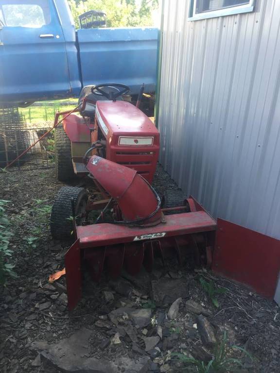

AMC RULES 37,225 #13 Posted August 9, 2017 If you're interested... in making short work of your 1/4 mile lane there. Inquire about that old Ford there in the pict behind the . 2 Share this post Link to post Share on other sites
SCAVENGERGIRL 10 #14 Posted August 9, 2017 (edited) 16 minutes ago, AMC RULES said: If you're interested... in making short work of your 1/4 mile lane there. Inquire about that old Ford there in the pict behind the . When I 1st bought the property in February, an old plow truck was exactly what I was looking for. After some time (& budgeting), I realized that I needed something with more versatility. I considered an ATV & even just a walk behind blower, but I think a tractor is going to give me the most bang for my buck. I really want something to help me do some 'heavy lifting'. The driveway is pretty level, so nothing steep for actual snow removal. My concern with plowing it is that it's stone topped & on a hillside, some parts of the bank are very steep and drop off a good 20+ feet. I don't want to risk damaging the downhill edge OR sliding off and having a tractor roll over top of me. I decided a nice neat snow blown path down the middle should do, at least until I have a few years to do something about the lane itself. I'm the type to go out and shovel snow multiple times, either for the joy of being in the snow or just so it's easier to do later on, but I definitely want something that will be able to handle a 3' snow if need be. I don't mind having to patiently work thru it (better than breaking my back) but I definitely need something able to handle it. I do want a plow still. I'm trying to level & fill in some low lying areas and I think a plow would really help. I'm not sure what the deck is just yet, but I haven't used my push mower yet this year so the deck may well be up for grabs. I think I'm getting the impression this would probably be good enough for what I need, for now, so long as it runs once those parts are replaced. I'm not sure how to determine if that's the real reason it won't start outside of taking the seller's word for it. Any suggestions on things to check to help me determine if that's it's biggest problems? Do C-81s have any popular recurring issues I should expect to run into? I realize a 40 year old tractor is bound to have some problems, I'm just hoping to avoid thousands of dollars of repairs. Very useful comments, thank you! Edited August 9, 2017 by SCAVENGERGIRL 3 Share this post Link to post Share on other sites
