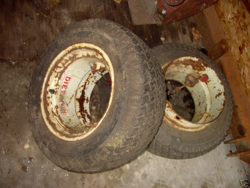

AMC RULES 37,254 #2 Posted August 8, 2017 (edited) Pretty sure Jason has an original set of these DMI rims... might be able to expound some more, & post up a pict of the set he has for you. Edited August 8, 2017 by AMC RULES 3 Share this post Link to post Share on other sites

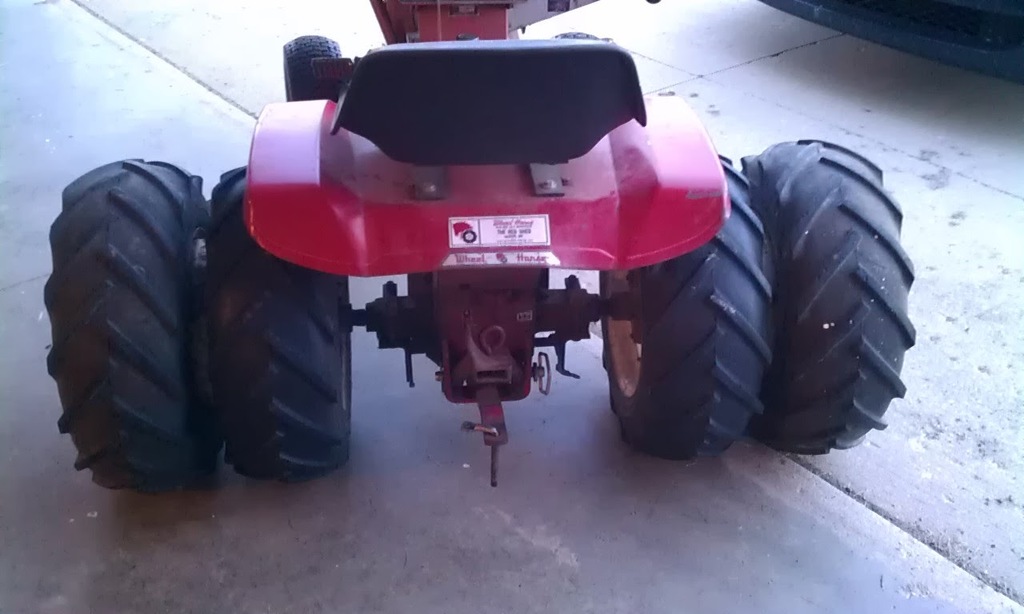

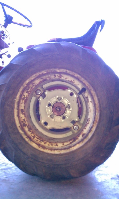

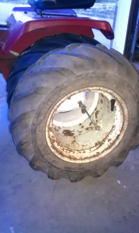

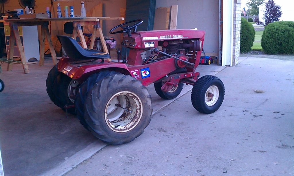

CasualObserver 3,411 #8 Posted August 8, 2017 @AMC RULES Craig is right, I do have some of these very hard to find DMI mini-duals. I won't repeat the DMI story from the link above, but here are the pics I have available. When I got them..... And from when I had them mounted one time. I was thinking of getting them out for a show in a few weeks... if I do, I'll get some new (hopefully better) pictures. 2 Share this post Link to post Share on other sites

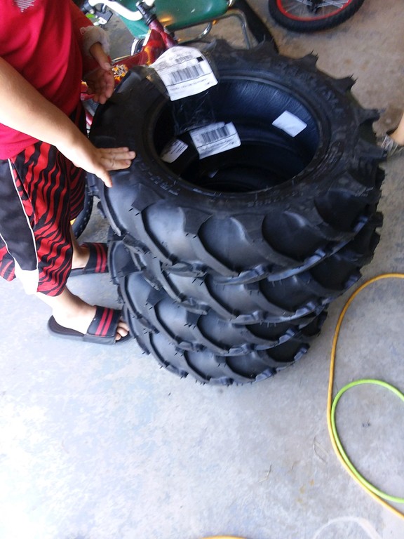

Rough Cut 25 #12 Posted August 10, 2017 On 8/8/2017 at 6:14 AM, AMC RULES said: Pretty sure Jason has an original set of these DMI rims... might be able to expound some more, & post up a pict of the set he has for you. I really like this. Ups man brought some goodies.... 2 Share this post Link to post Share on other sites
