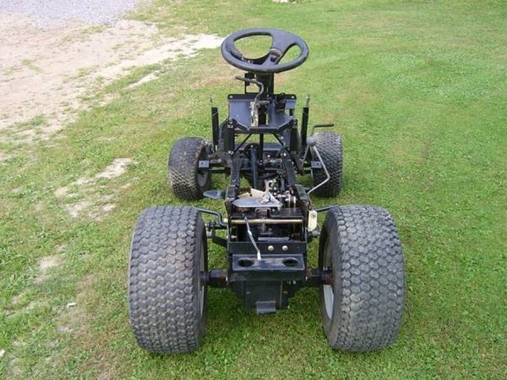

Here is a photo of a bare chassis that I gleaned from the internet. It may be from another RS member.

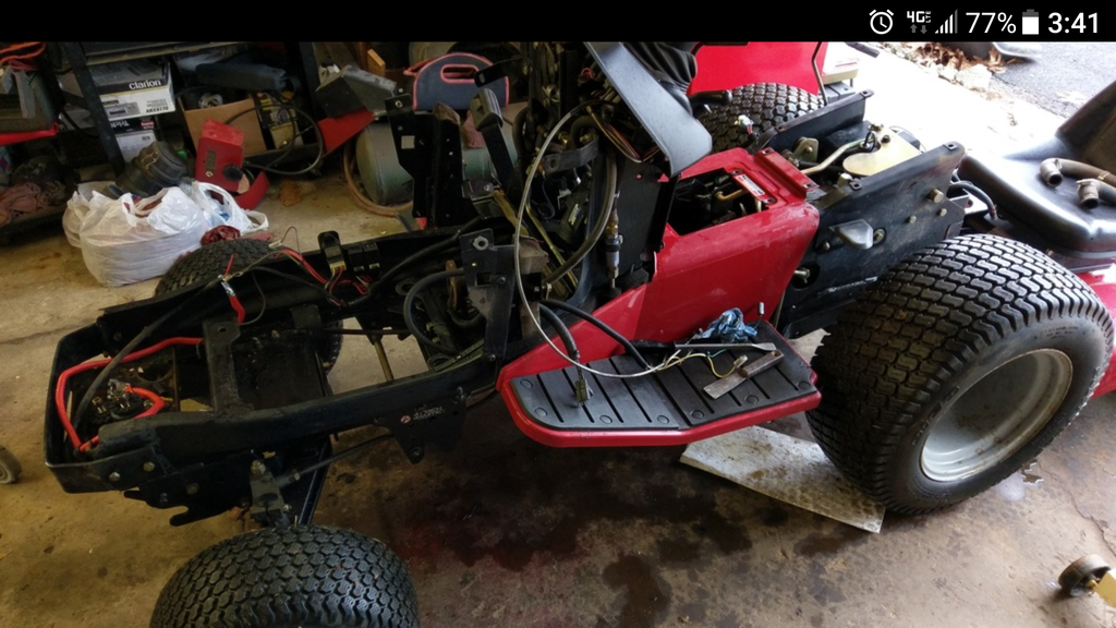

The cruise control is electro-magnetic, and can be set as low as crawling along forward then pedal pushed farther to increase speed then returned to set speed when lifting your foot, I did enjoy that part vs continued pushing of the foot pedal, another big advantage of the Xi's is the sharper turning radius around obstacles in the yard vs the 520H which is still tighter than the average L&G tractor, if you check out my previous post on the 523Dxi and 520xi I believe I have several pics up with the fenders and front hood off and engine removed, Jeff.

mikeeyre74
Oh. My. Goodness.
Heres the before pics:
Before and after car wash #2Before and after car wash #2Before and after car wash #2
and here's a few after:
got a little nervous after i got home when she started up to get off the trailer and then stopped part way down and then wouldn't start bAck up again... somehow managed to blow a fuse there, but that was easily remedied and we're back in business.
The best part? The wash job completely fixed the machine. The MC lever works like a champ now. Snaps right back to center all on its own and feels like a million bucks. Thanks for the diagnostics, fellows!
