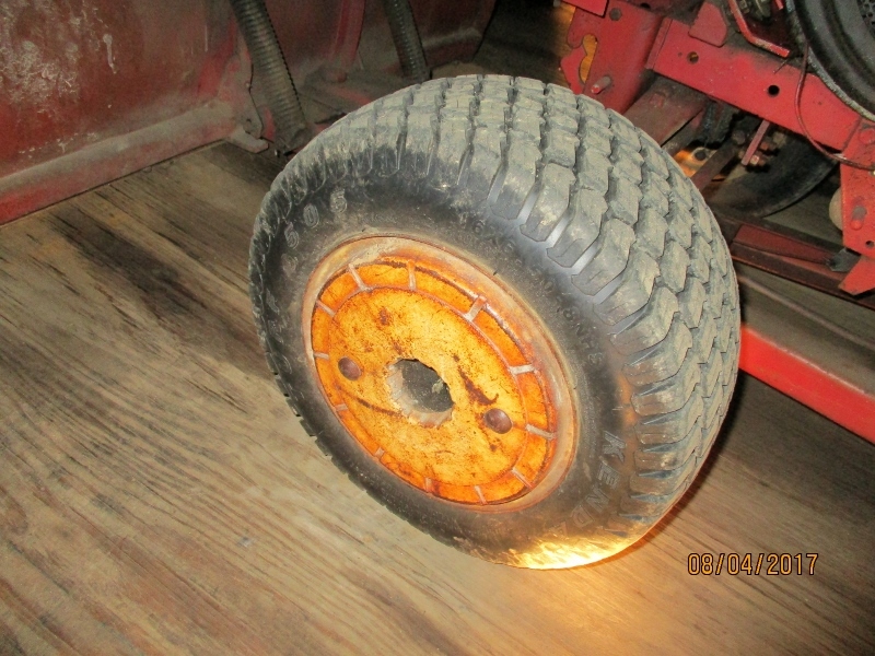

tallen4392 71 #1 Posted August 5, 2017 Do a lot of you guys use frt wheel weights for snow plowing I was wondering because u don't see them for sale very often and when you do they are expensive ....... Share this post Link to post Share on other sites
N3PUY 1,031 #2 Posted August 5, 2017 I have cast weights on the front of my C125. The snow/dirt plow stays on it all year. 1 Share this post Link to post Share on other sites
AMC RULES 37,211 #3 Posted August 5, 2017 Helps your steering to have additional weight up front... when pushing a blade full of the heavy stuff. 1 Share this post Link to post Share on other sites
tallen4392 71 #4 Posted August 5, 2017 How about adding fluid to the frt tires ?? Share this post Link to post Share on other sites
R. L. Addison 299 #5 Posted August 5, 2017 If you want to add fluid to tires, use tubes & non-corrosive fluid. 1 Share this post Link to post Share on other sites
