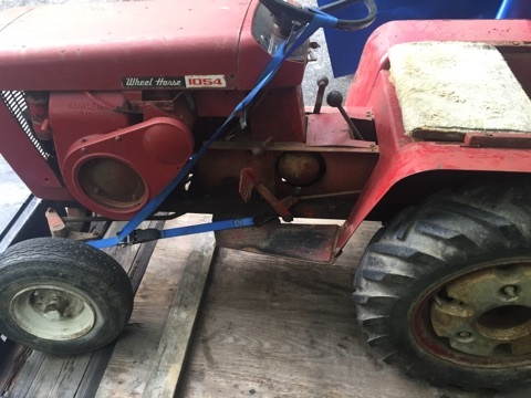

Big_Red_Fred 1,548 #1 Posted August 4, 2017 Before i buy a 953 gas tank that is rusty inside, whats the best remedy to clean out the rust ? Is there a product on market ? Let ole Big Red Fred know Please, i'm starting the resto on 1054, want it to shine like a star filled sky & Growl like a Griz 953, Your Needed ! Share this post Link to post Share on other sites
