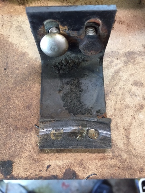

TimH 105 #1 Posted August 2, 2017 I got the 12 hp Kohler pulled and was wondering id there is a way and a place to get parts for the mower deck clutch that seems to be worn. Rivets are down to the max Thanks Share this post Link to post Share on other sites
elcamino/wheelhorse 9,363 #2 Posted August 2, 2017 There is a thread on replacing the clutch material. I found the clutch material on flea bay .You need to order clutch disc Facing material replacement for John Deere Tractor B 50 . It cost about $10.00 plus shipping . You use JB weld to attach to the disc. 1 Share this post Link to post Share on other sites

Anglo Traction 761 #4 Posted August 2, 2017 If it is just the Brake Pad that stops the PTO Cone from spinning when disengaged, as in your 2nd pic.....Google either TORO 946652 or TORO 104730. About $19 +Ship. Share this post Link to post Share on other sites
