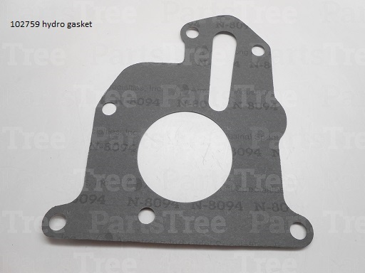

gwest_ca-(File Mod) 11,932 #4 Posted August 1, 2017 5955 Sundstrand hydro pump gasket nla - 102759 gasket should work Garry 4 Share this post Link to post Share on other sites

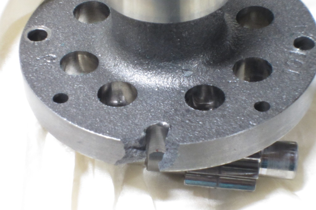

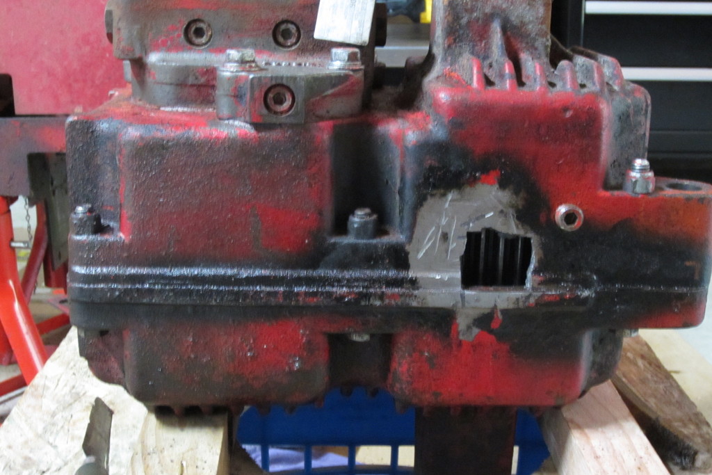

R. L. Addison 300 #7 Posted August 2, 2017 I have one 5955 gasket which I think is for Hydrogear and an extra 102759 which should be piston>piston. 102759 will do both. I also have the case which is broke, and depending on axle size. maybe the side flanges for the bull gear. I would have to check size. Bull gear & flanges are rusty and would need to be cleaned up. Ron Addison (309) 241-7289 Share this post Link to post Share on other sites

pacer 3,179 #9 Posted August 4, 2017 I'm also into one - off a D160 - because of the park brake, when I got it apart and looked at that contrary thing for a few mins, I decided to just simply do away with it!do away with it!! problem solved!! An added benefit came from this, since I went ahead and removed ALL of the park brake stuff (all that convoluted linkage) the tractor is Sooo much easier to move fwd/backward. Now, the 5999 gasket - I looked pretty extensively and came up with zip -- so I just cut one myself like a couple of the other posters said, its really pretty easy. The trick - I found - was to lay your material over your case with it laying on its side (I mounted mine in the vise) and punch out all the bolt holes ( I ground the end of a 3/8 bolt to have sharp edges so it would cut the hole) and then went around and stuck 3/8 bolts in all the holes to 'stabilize' the material and proceeded to tap tap tap the eges away til I had me a nice gasket! Share this post Link to post Share on other sites
