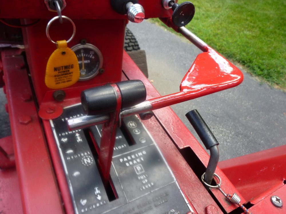

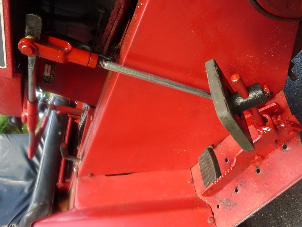

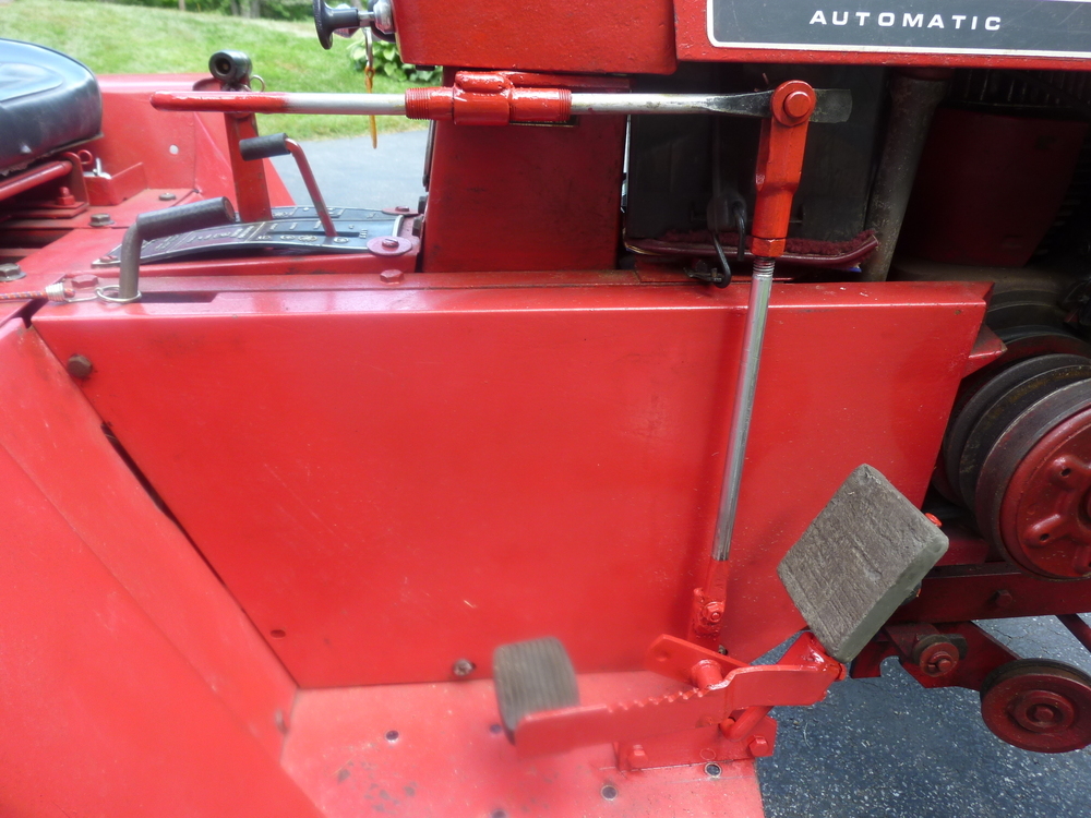

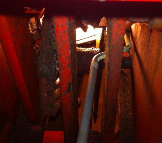

953 nut 64,278 #5 Posted August 2, 2017 Here are a few pictures of one that was posted a couple years back. I don't remember who did the post or what the title was, but had saved the photos for future reference. Share this post Link to post Share on other sites
FatJackDurham 318 #6 Posted August 2, 2017 That is similar to what I planned to do, except I planned to keep it on the left side of the tractor in front of, or underneath the break pedal that doesn't work, so as to avoid routing all around the internal parts. That person did a nice job welding and bending the rod, though. My work is not as clean. Share this post Link to post Share on other sites

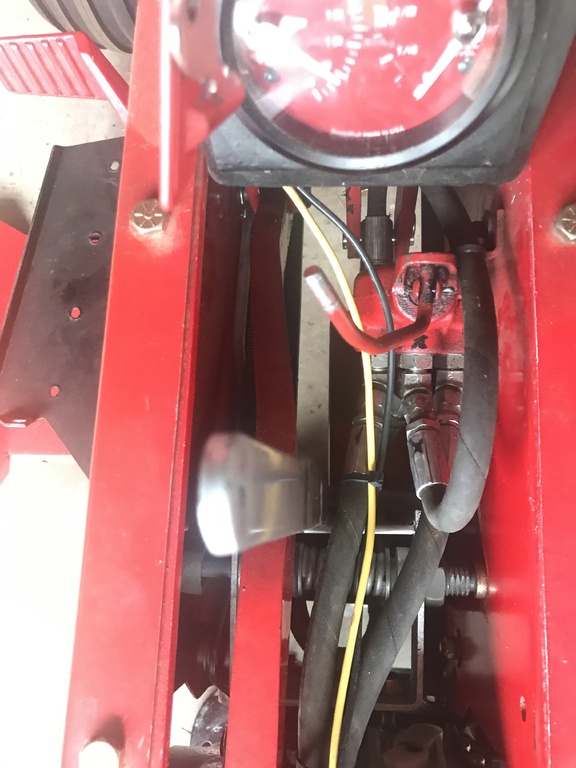

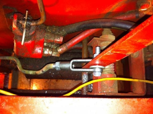

Aldon 4,832 #7 Posted August 2, 2017 If you have or plan to add a 3 point hitch, you would either have to use independent type or if you use combined control valve, you would have to navigate around the draw bar as well. 1 Share this post Link to post Share on other sites
FatJackDurham 318 #8 Posted August 2, 2017 Do you mean if I do the three point hitch that connects to the existing hydraulic cylinder that lifts the plow and deck? Share this post Link to post Share on other sites

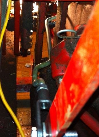

Aldon 4,832 #9 Posted August 2, 2017 Yes. It will crowd the left side of the tunnel. Share this post Link to post Share on other sites
Aldon 4,832 #10 Posted August 2, 2017 Here is pic of tunnel with "Dependent" or shared cylinder with the draw or lift bar in place. 1 Share this post Link to post Share on other sites

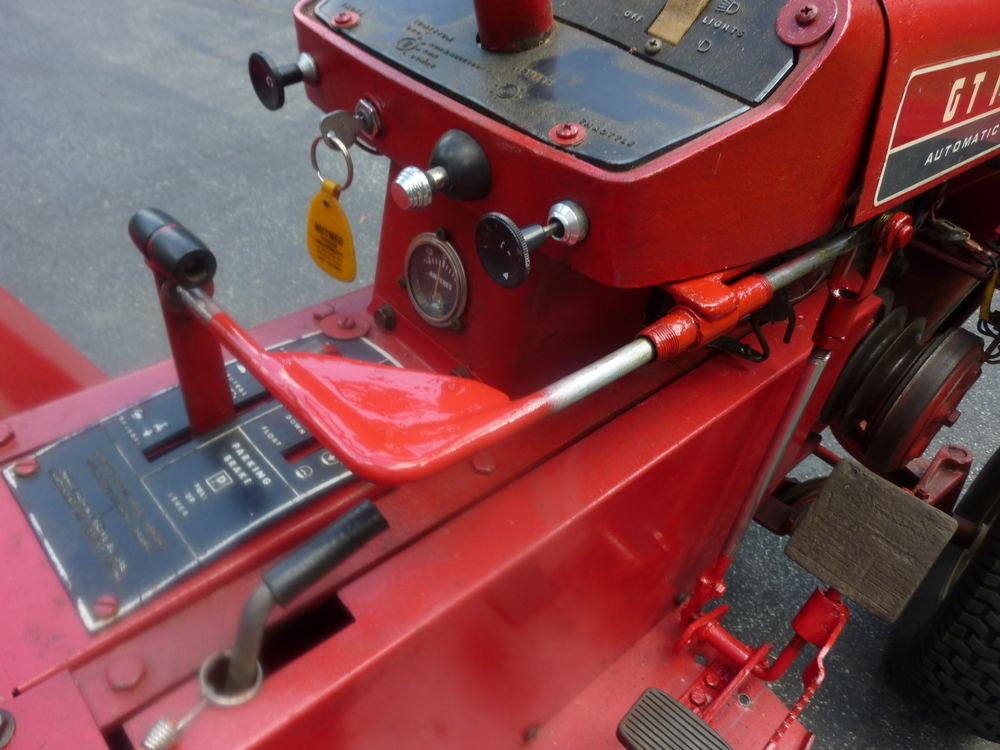

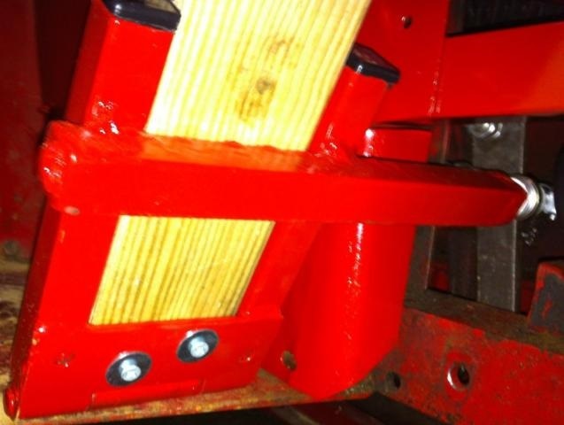

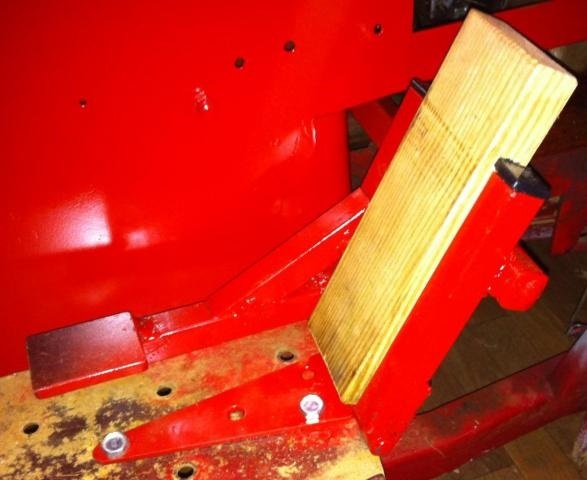

Rob R 986 #12 Posted August 3, 2017 I took simpler external approach and you can still use the "T" handle. Share this post Link to post Share on other sites
FatJackDurham 318 #13 Posted August 3, 2017 21 minutes ago, Rob R said: I took simpler external approach and you can still use the "T" handle. Yes, I am considering that too. Nice pedal! 1 Share this post Link to post Share on other sites
