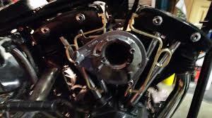

WHX?? 53,373 #13 Posted July 27, 2017 You should never use compression fittings with liquids or gases that can go bang If you must use them small diameter lines only and use rubber ferules, not brass or plastics. 21 hours ago, 953 nut said: and yes; they do look KOOL! well they're oil lines but still.... 1 Share this post Link to post Share on other sites
Electro12WH 50 #14 Posted July 27, 2017 Bikes now days remind me of Match Box cars; they have no details. Old Harleys with oil lines and such are kinda' like steam punk, all lines, levers and gears. Same for old GTs. 1 Share this post Link to post Share on other sites
