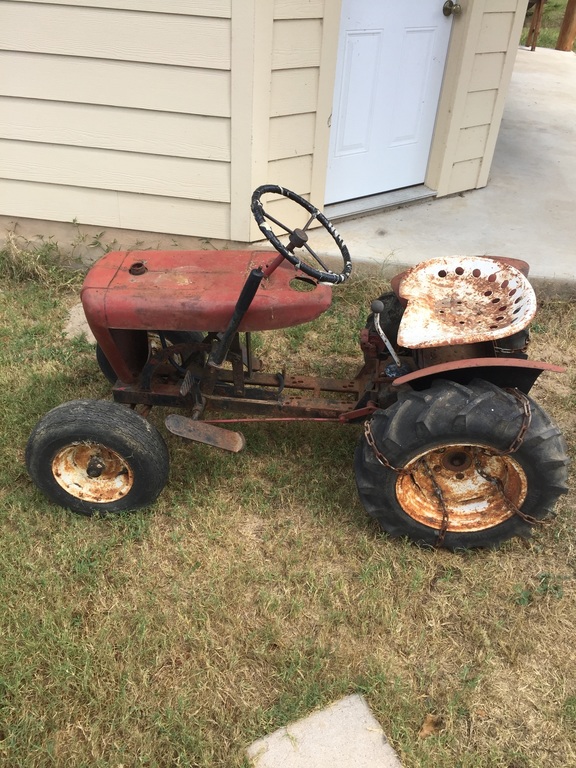

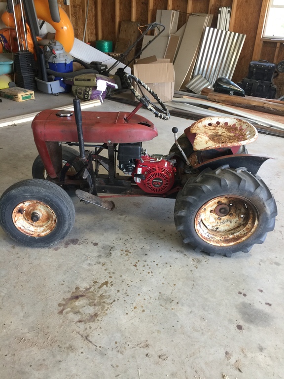

stevasaurus 23,536 #7 Posted July 23, 2017 Excellent...these machines are pretty simple and easy to work on. I like your horse. Thank you for the picture. I know Texas is a big state, but we do have a few great members down there, maybe you are close enough to meet them some day. It's always a good day when we can help somebody get a horse running again...enjoy the site and the people here. 1 Share this post Link to post Share on other sites

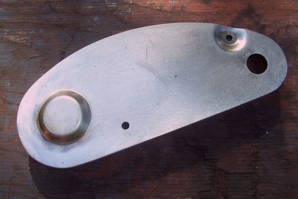

TexasJohn 9 #14 Posted July 25, 2017 I don't find any reproduction belt guards to cover motor to transmission. Anyone know of a source? Share this post Link to post Share on other sites
AMC RULES 37,254 #15 Posted July 25, 2017 Search Ebay "wheel horse RJ"... you'll see this belt guard there. Contact the seller there... ask him for the correct guard for your machine. 1 Share this post Link to post Share on other sites
TexasJohn 9 #16 Posted July 25, 2017 Thank you AMC Rules! 1 Share this post Link to post Share on other sites
AMC RULES 37,254 #17 Posted July 25, 2017 Same guy that sells them here... & priced the same too. 1 Share this post Link to post Share on other sites
oliver2-44 11,149 #18 Posted July 25, 2017 When you order a belt guard tell him it is for a 1961 Suburban. The 58-59 RJ guard is as pictured above The 1960 Suburban guard has a vertical rib for reinforcement in the middle. The 1961Suburban guard has a vertical and horizontal rib (makes a + sign) for reinforcement in the middle. 2 Share this post Link to post Share on other sites
