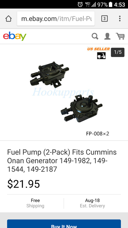

WVHillbilly520H 10,379 #35 Posted August 15, 2017 7 hours ago, Walhonding520 said: I guess I'll try taking it apart and cleaning it one more time. I haven't seen any leaking around the intake. For a while it was running much better so I guess it just plugged up again and needs another cleaning. I did take the fuel pump apart and it seems clean. Back together and there is plenty of fuel running through the fuel filter. Those Onan fuel pumps aren't rebuildable and the OE aren't cheap, I get them off eBay 2/$20 cheap insurance when it finally won't pump anymore usually from a pin hole in the diaphragm, Jeff. Share this post Link to post Share on other sites
Walhonding520 25 #36 Posted August 15, 2017 Thanks. I think I'll get it soaking tonight. I have been doing some searching for a cheaper option of fuel pump. I found a Briggs option but will buy what you have there hillbilly. Will most pumps of that size work anyway? Share this post Link to post Share on other sites
WVHillbilly520H 10,379 #37 Posted August 15, 2017 35 minutes ago, Walhonding520 said: Thanks. I think I'll get it soaking tonight. I have been doing some searching for a cheaper option of fuel pump. I found a Briggs option but will buy what you have there hillbilly. Will most pumps of that size work anyway? Yes, I had one of those "round" Briggs style pumps on mine for quite sometime because I couldn't bring myself to pay $80+ for the OE Onan, then found those and have been pleased so far, Jeff. Share this post Link to post Share on other sites
cleat 9,405 #38 Posted August 15, 2017 I am using the same ones. They actually seem to have better check valves than the original one. Just watch and be careful when removing a fuel line from it as they are very brittle and break easily. Cleat Share this post Link to post Share on other sites

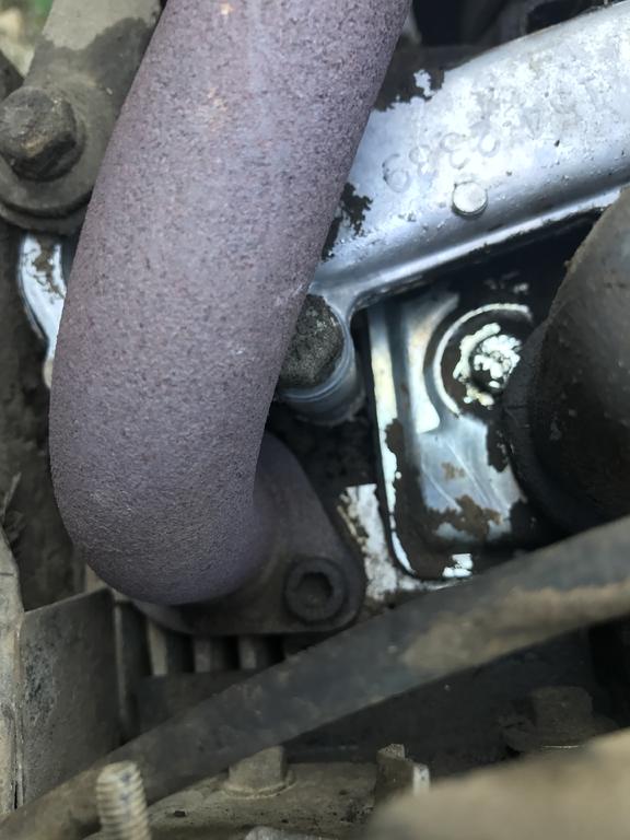

Walhonding520 25 #39 Posted August 20, 2017 Ok. While running sprayed carb cleaner around one of the seals on what I think is the intake manifold. It stops surging for a second then starts again. Repeat and it stops for a second and starts again. There is seems to be air blowing out as well when I spray cleaner. Is this the bad seal referenced above. Form what you said above this doesn't seem like a simple or cheap thing? It's in the front cylinder. Share this post Link to post Share on other sites
lynnmor 9,073 #40 Posted August 20, 2017 See my post on 7/23/17, and quit swimming upstream. Share this post Link to post Share on other sites

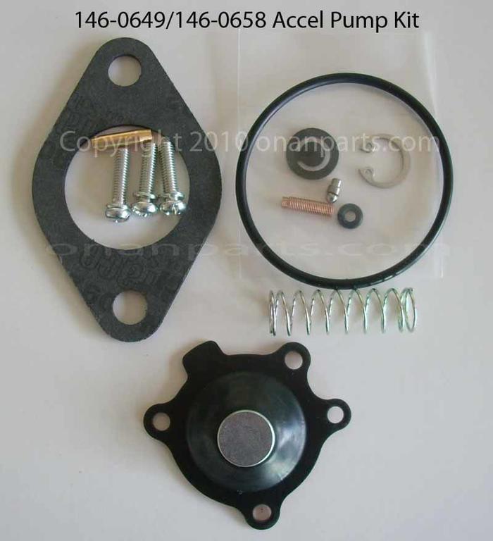

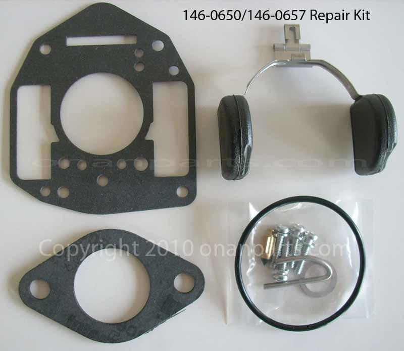

WVHillbilly520H 10,379 #46 Posted August 28, 2017 See my post #32 above carb kit from Onan parts.com ,if you're soaking the carb it needs a kit and maybe the accelerator pump replaced as well, but also with what I said earlier use the carb spray to help narrow down diagnose vacuum/gasket leaks, I believe the accelerator pump was only on 94/95 and newer models. Share this post Link to post Share on other sites
Walhonding520 25 #47 Posted August 29, 2017 I have noticed it doesn't surge if I have been mowing for an hour. I'm assuming that heat has caused something to expand and seal wherever the leak is. Does this sound right? Share this post Link to post Share on other sites
cleat 9,405 #48 Posted August 29, 2017 1 hour ago, WVHillbilly520H said: See my post #32 above carb kit from Onan parts.com ,if you're soaking the carb it needs a kit and maybe the accelerator pump replaced as well, but also with what I said earlier use the carb spray to help narrow down diagnose vacuum/gasket leaks, I believe the accelerator pump was only on 94/95 and newer models. Never seen one on any of mine. Share this post Link to post Share on other sites
Searcher60 209 #49 Posted August 29, 2017 If you pull the choke out slightly does the surging stop? Can you find a sweet spot with the choke where the surging stops? Maybe you got a governor issue? Share this post Link to post Share on other sites
WVHillbilly520H 10,379 #50 Posted August 29, 2017 8 hours ago, cleat said: Never seen one on any of mine. 96 and newer then my Anniversary is actually by serial number a 97 but it definitely has the accelerator pump Share this post Link to post Share on other sites
