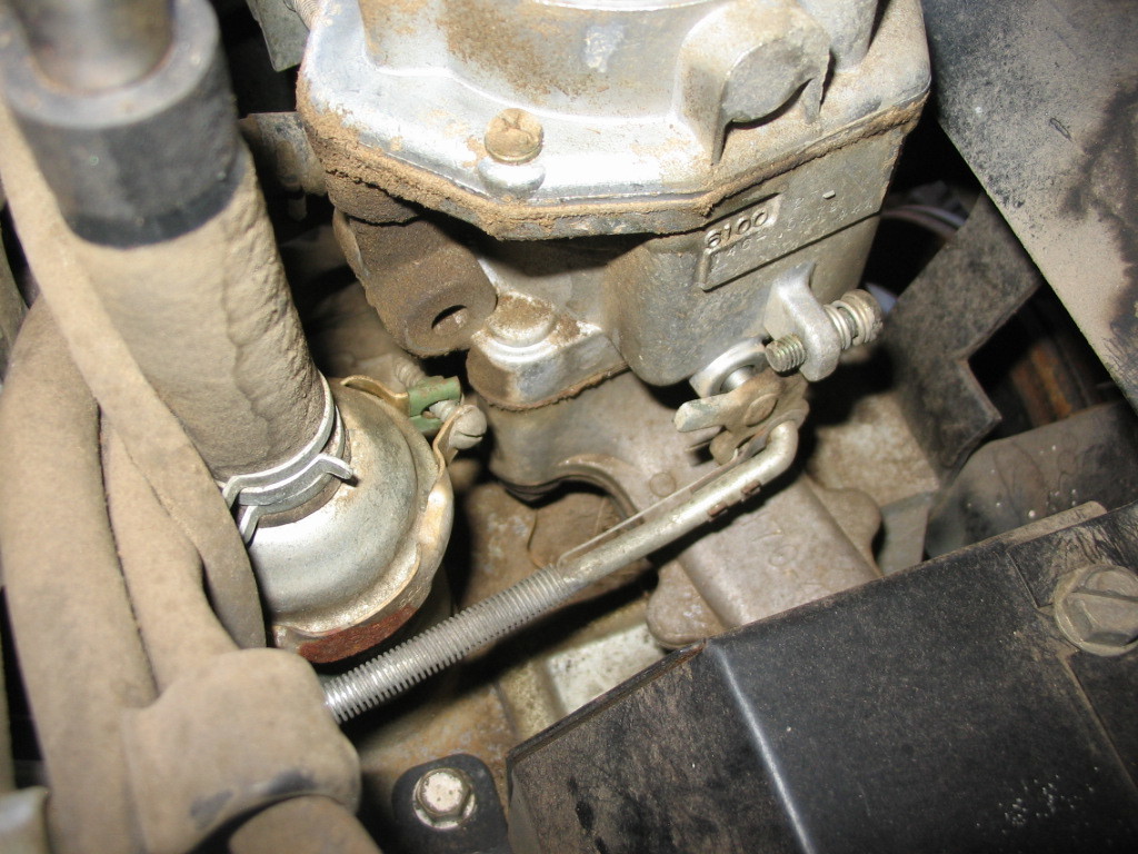

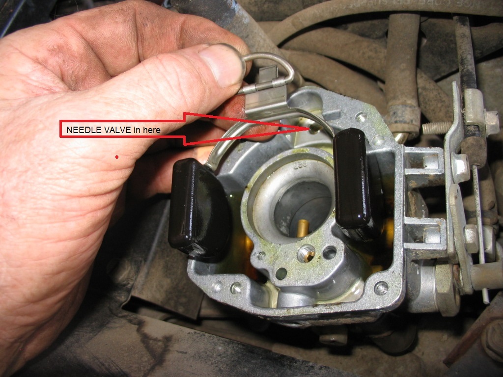

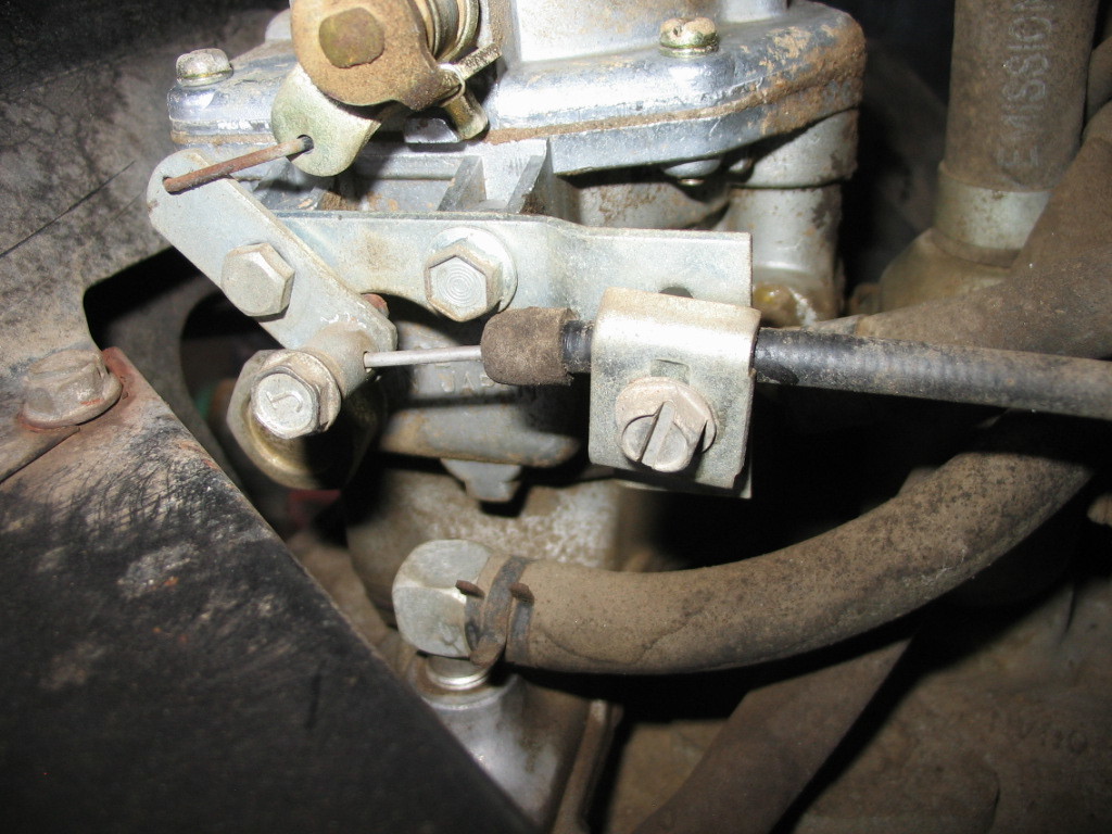

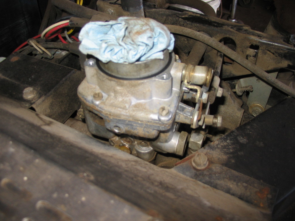

daveoman1966 3,881 #7 Posted July 23, 2017 You can take the top off of the carb,...but BE CAREFUL not to drop tiny parts into the throat. FIRST.... clean off al the dirt and crud from the outside surfaces. Take a pic or two of how the linkage goes toegether. Here is the NEEDLE VALVE....it is kinda hidden,so take extra care. Once the top is off, use your carb cleaner and a tiny brush to clean out the float chamber, both sides. 6 Share this post Link to post Share on other sites
lynnmor 8,544 #8 Posted July 23, 2017 Look at the last photo above. Down near the bottom of the carb you will see a welch plug, make sure it is still there. I have had one fall out and it gave the same symptoms you described. As always, check the compression first thing. It may be a good idea to just pull the exhaust, intake, carb, and valve covers and do it right. The exhaust can then be painted, the valves adjusted, the intake checked for sealing and the carb cleaned thoroughly. Intake gaskets, especially cheap ones, can get sucked in causing similar problems, so use real Onan gaskets there. 1 Share this post Link to post Share on other sites

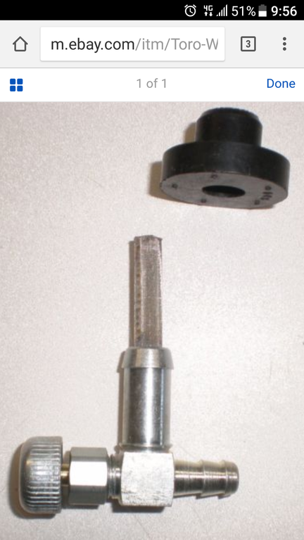

Walhonding520 25 #24 Posted August 13, 2017 How do I get the dang valve out of the bottom of the fuel tank. I want to clean it and the screen. Does it just pop out or do I have to unscrew it. I've been careful so far as to not damage it. Share this post Link to post Share on other sites
WVHillbilly520H 10,377 #25 Posted August 13, 2017 13 minutes ago, Walhonding520 said: How do I get the dang valve out of the bottom of the fuel tank. I want to clean it and the screen. Does it just pop out or do I have to unscrew it. I've been careful so far as to not damage it. Pry it out with needle nose pliers ,the rubber is the seal to the tank the barb on the valve holds it tight, it might not come out without ruining though, Jeff. 2 Share this post Link to post Share on other sites
