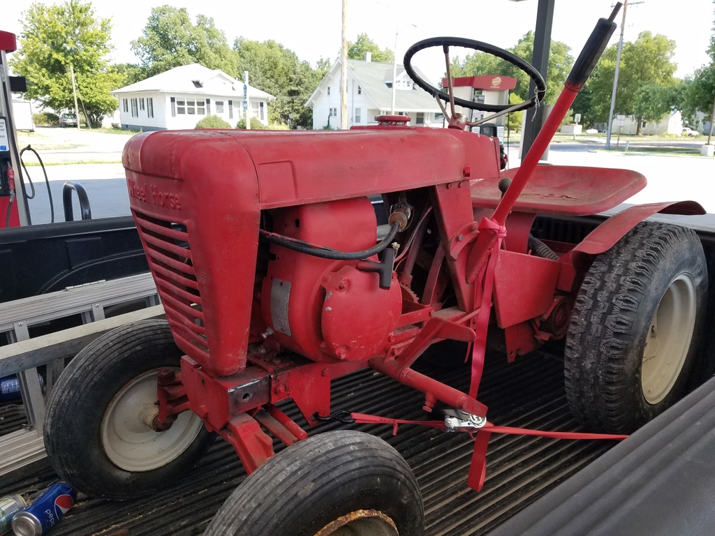

Truckie 4 #1 Posted July 23, 2017 My son just got a 502 to restore and he wants it to have an electric starter. Can anyone walk me through what parts I need, part numbers, and best place to get them? Thanks, Tom 1 Share this post Link to post Share on other sites
