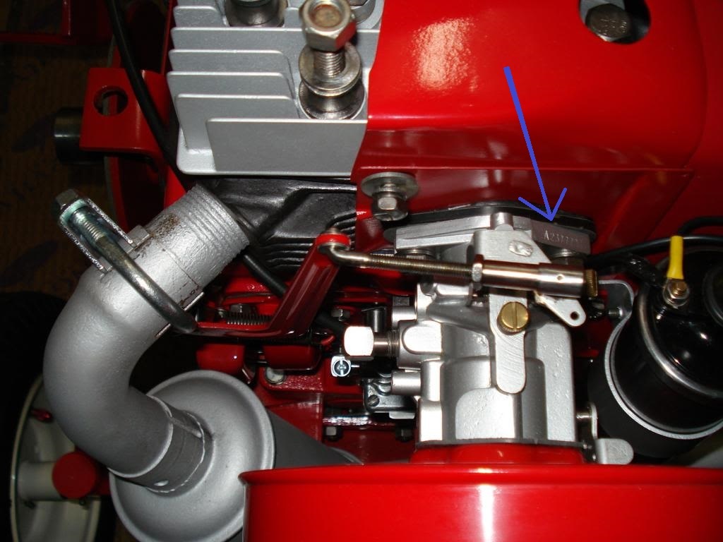

Anglo Traction 761 #10 Posted July 23, 2017 (edited) Hi, Like I said in your other post wanting C121 Pics, If you need any help drop me a PM. If you have no luck finding Mike Hitchins, or can't obtain what you need. I make parts for my own (Kohler) Carburetors like Throttle Shafts, Plates, Screws and Shaft Bushes. I also have a spare genuine Kohler Repair Kit and Carb Gaskets, which, I see from your pic that you will probably need due to someone using Hylomar blue jointing on it. If possible, can you post the number on the Flange of your Carb, as located in this image ?- If you go down the China Cheap replacement route, I will buy your old one off you. Regards Edited July 23, 2017 by Anglo Traction 4 Share this post Link to post Share on other sites
