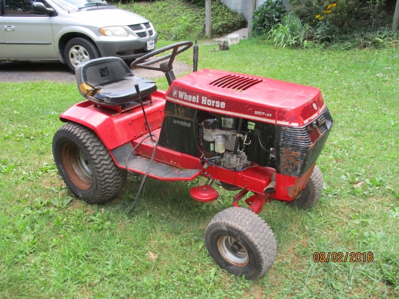

RichFC 0 #1 Posted July 21, 2017 (edited) At idle or low RPMs it will charge but if i turn on the PTO or headlights it discharges. Also if I raise RPMs without turning anything on it does not charge. The battery is new. I just received this tractor it has been sitting in the woods for a few years. It starts right up and it has a Kawasaki FC540V engine. Tractor is a 257-H Since my original post . The charging system came to life on its own .It is now charging above 17 amps .I replaced the key switch ,removed cleaned the rectifier plug and base . cleaned the ground terminals . I am still trying to find out how many years this tractor sat out in the woods. When I have time I will test the rectifier with the chart Garry posted. Thank you everyone. I will post the results sometime next week. Edited July 22, 2017 by RichFC Share this post Link to post Share on other sites

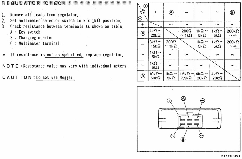

gwest_ca-(File Mod) 11,846 #7 Posted July 22, 2017 Part 2 of this manual covers the charging system. Have never seen this before to diagnose the voltage regulator if it has 6 terminals. Garry 1 Share this post Link to post Share on other sites
N3PUY 1,031 #8 Posted July 22, 2017 That's a really interesting chart to diagnose a voltage regulator. Tells exactly what terminals to probe and what the meter should read. Share this post Link to post Share on other sites
Tuneup 1,452 #9 Posted July 23, 2017 I like the instruction - Do Not Use Megger. You just don't see that kind of stuff anymore. Heck, I haven't seen a megger since the mid 90s and I'm in the test equipment calibration business! Share this post Link to post Share on other sites
