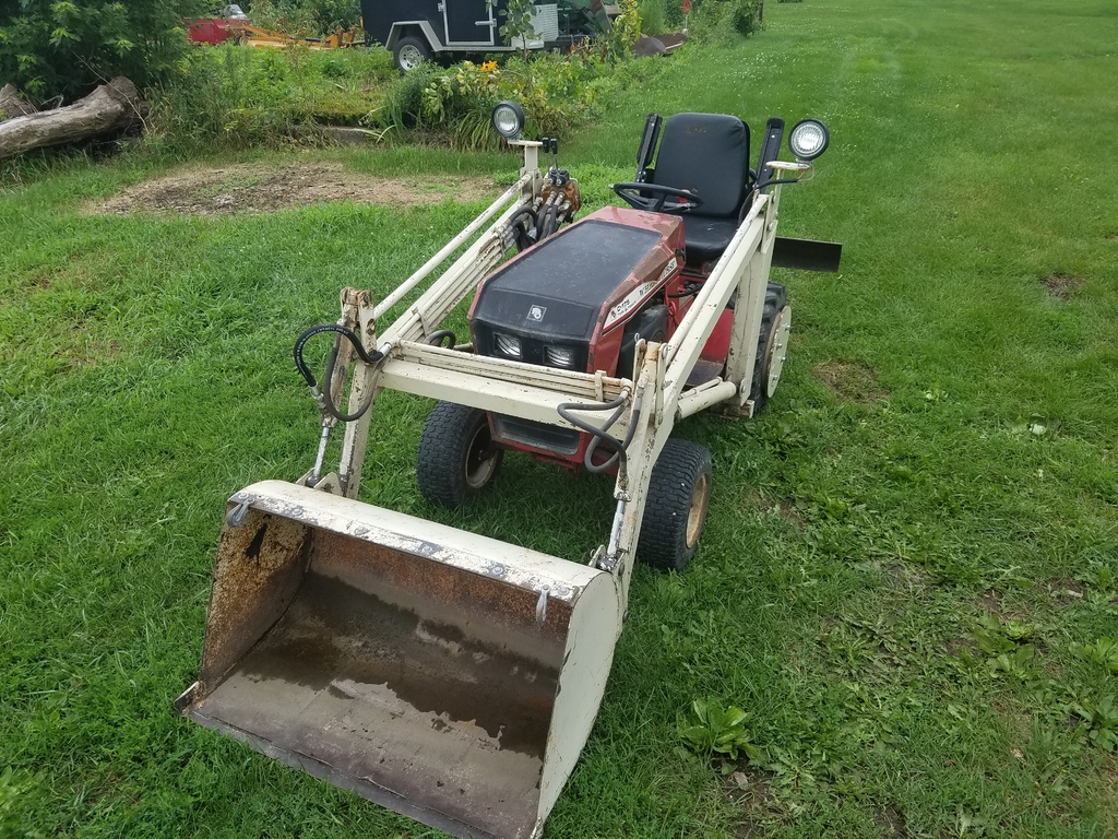

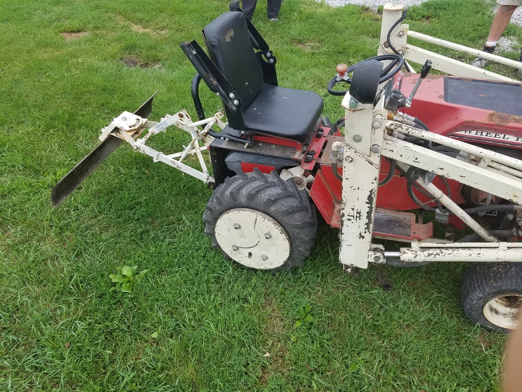

SamH 37 #16 Posted July 22, 2017 Took a look today. Hope to close the deal here in the next few days. Tossed in a couple pics. Loader worked amazingly well. Needs some tlc and a little maintenance...cleaned, lubed, hoses replaced before theyes blow etc, but all in all it was pretty solid. Now I can't remember the spec # that was on the motor, but I believe it was even a series II motor. Regardless, it's gonna work just fine for the majority of what I need 3 Share this post Link to post Share on other sites
Sarge 3,465 #17 Posted July 23, 2017 Very nice - I'd love to have a loader but just don't have the room to store it . Sarge Share this post Link to post Share on other sites
